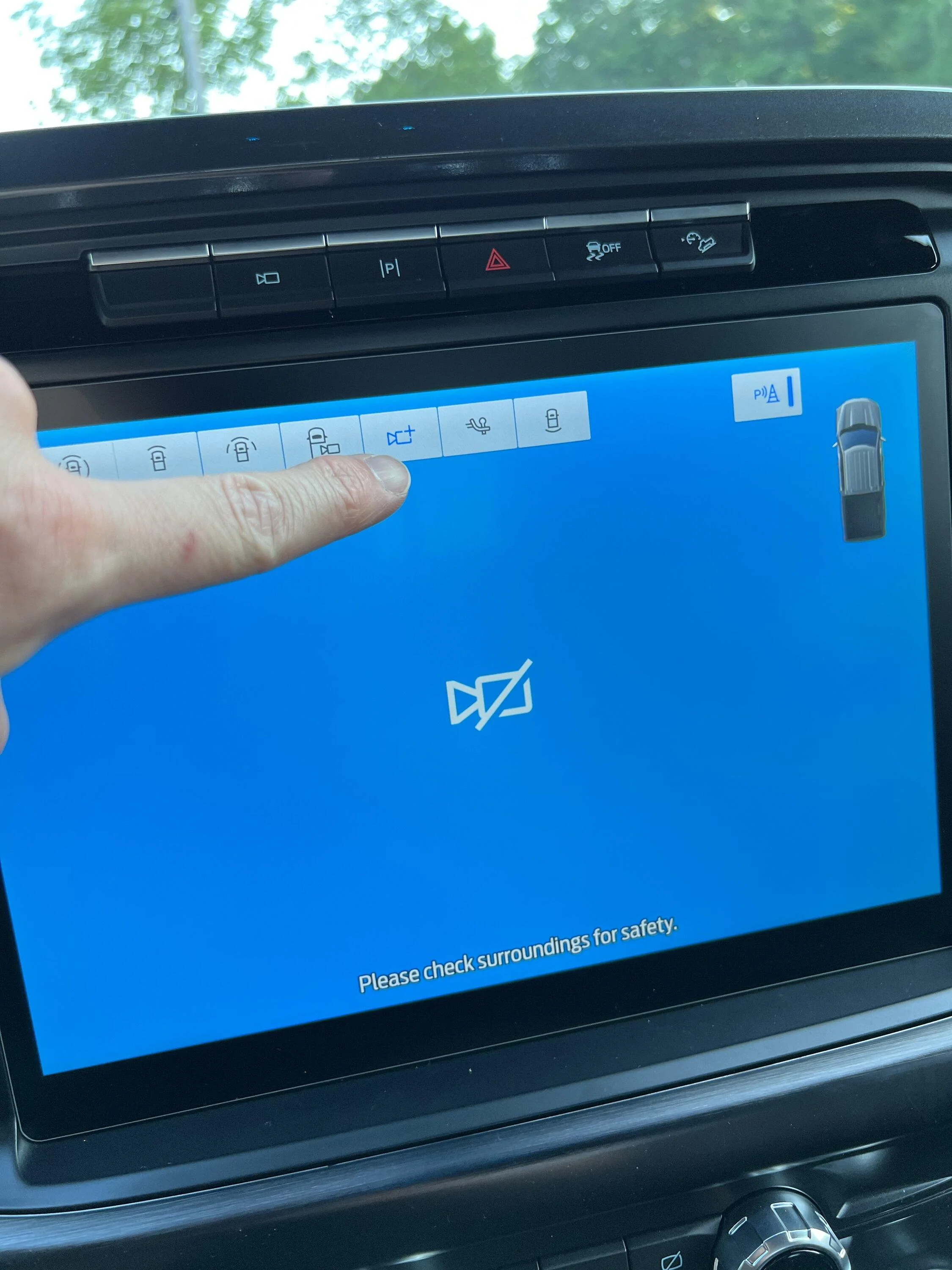

Hi all,
I am wanting a confirmation as to what this “camera” is for. I believe it is for adding. Camera for your trailer? When I select this camera I get a blue screen:
Ford F-150 Trailer Camera? 268E95F8-633C-45D7-9CE8-19EC72209327

It's a long one, but this is the definitive thread about installing the Ford Accessory Trailer Cam (and / or Trailer TPMS).
Note that not all F150s having the button shown in the first post are plug-and-play ready for the Ford Accessory trailer cam and / or TPMS kit. Some (many?) lack complete wiring in the truck's '12-pin connector harness' (you can blame Ford for that random inconsistency :facepalm:), but that can be overcome, the explanation and answers are found in the long thread I link above.
If you have questions, please post them in that thread.
Have Fun, Good Luck. :)
