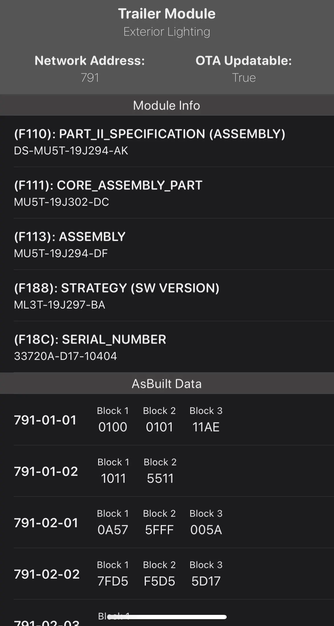

There's a way to check the software version that is installed from an iPhone, you can post it and we can compare the version to what I installed last week before the recall was released. The version I have was released in Feb. If its a later version, it could tell us that you have a newer one.
to get the module info, the Ford Pass Widget would need to be installed in an iPhone.

Here is mine, updated when the TRM came out in February timeframe.
Ford F-150 Trailer brake not working BE2C91D5-3B23-4D1F-ABE4-89ED7B3B82EE
