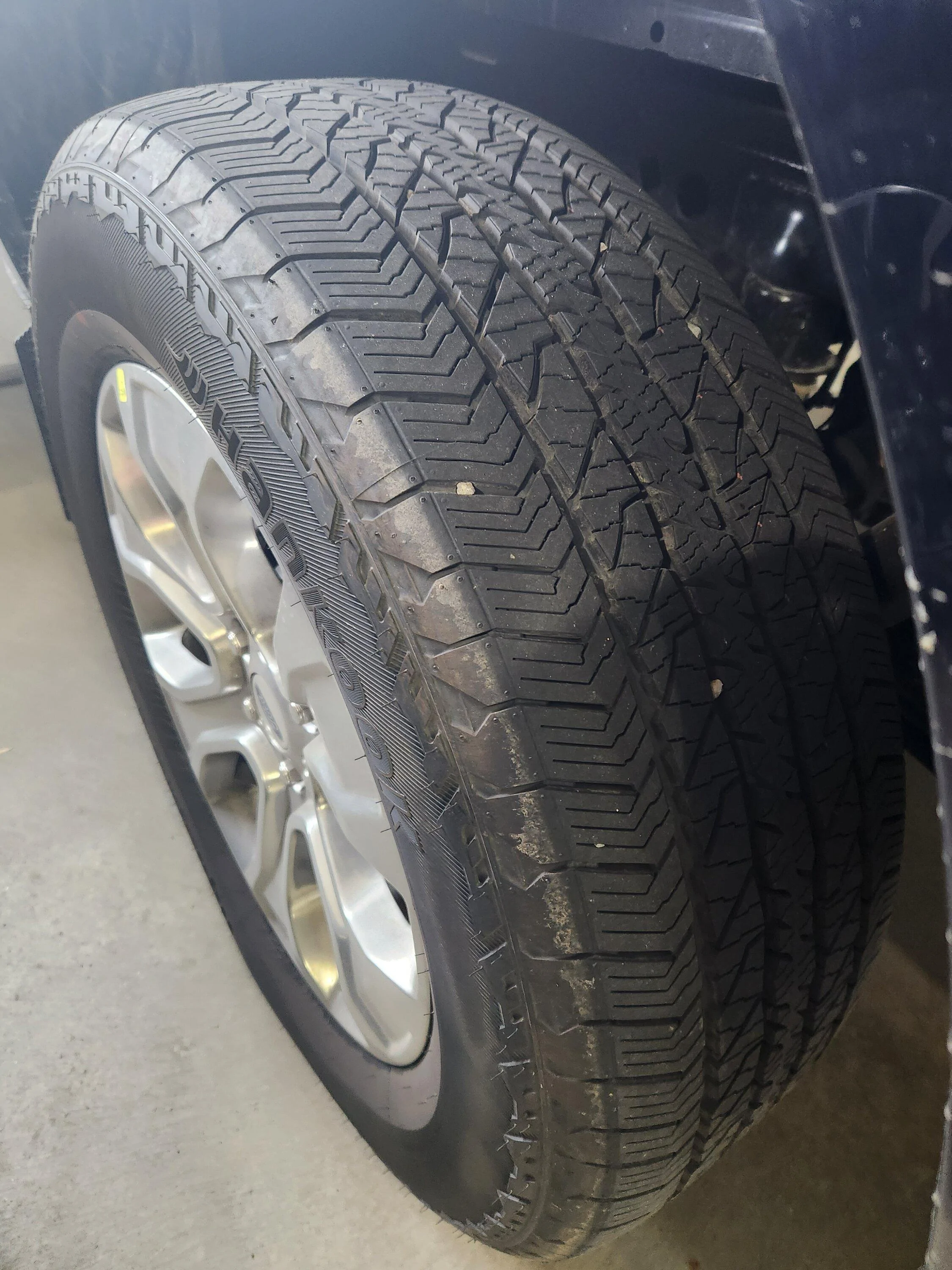

Do your Hankook Dynapro AT2 have the three peak mountain snowflake symbol? If so, then you might just be fine with those. I have used 3PMSF tires on my Canyon here in North Idaho and handled snowy conditions and stopping just fine. Noticeably better stopping than the tires that were on the Canyon when I bought it. Worked well on a couple of snowy trips up to Revelstoke also.
Now I have a 2023 Platinum Powerboost with the Hankook Dynapro AT2 that look like this picture. No 3PMSF. I may just run them this winter anyway. Used to be you needed 3PMSF tires with 4 wheel drive in the states to avoid chaining up, but now most laws just say M+S tires and 4 wheel drive. I don't plan to do any winter off road stuff.

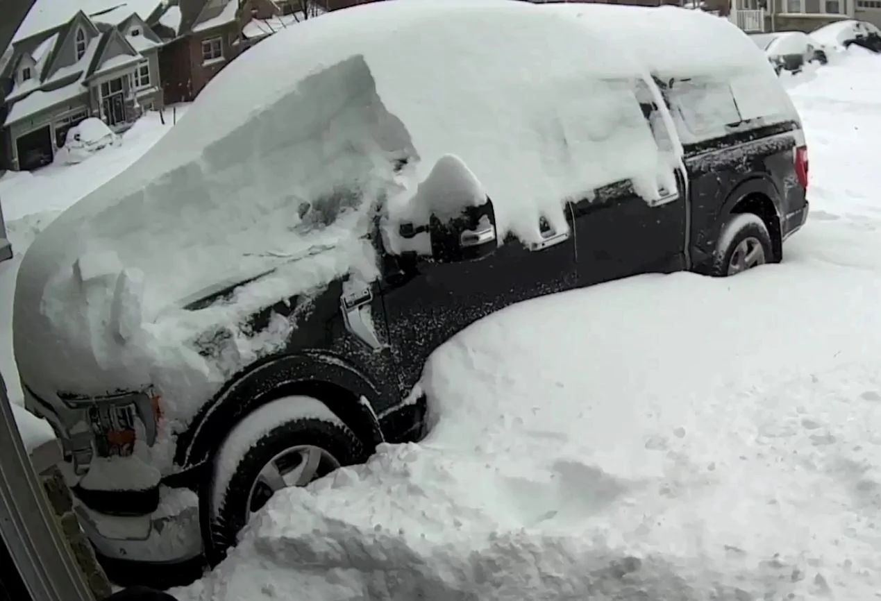

I have 20s and travel to northern Ontario often looking for snow (snowmobiling). I worked out a decent deal with local shop for wheels and snows. Put the snows on factory wheels and the summer tires on new. Always used blizzaks on my suv, but decided to go different route with the truck. Went with Cooper Snowclaws, 2 winters in and super happy with them, no concerns even towing the sleds. Love the snow and patiently waiting for first good dump here in Ontario

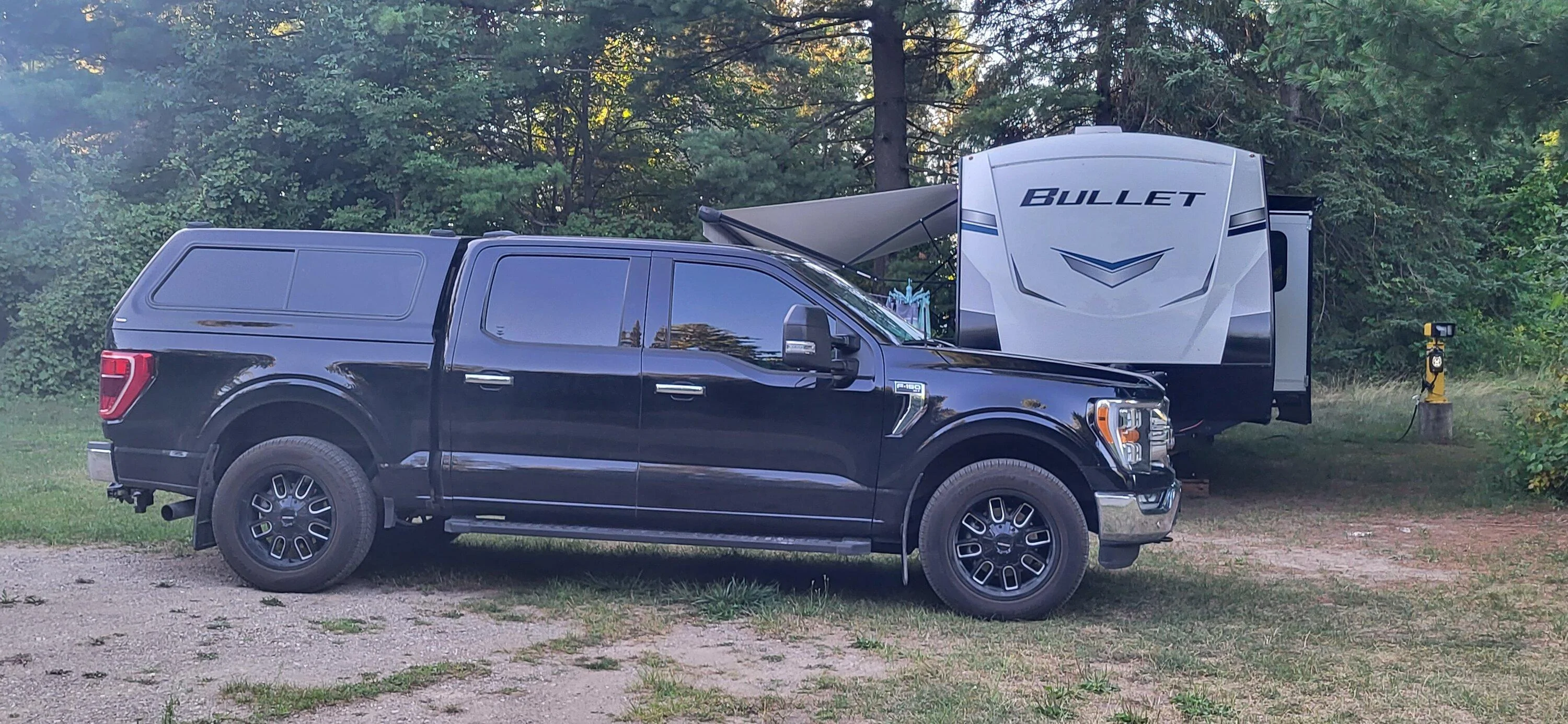

Just put Falken Wildpeak ATW3 LT285/R20 on my F150, using the factory rims with TPMS sensors. I wanted a winter tire that was good in all terrain, and since we only get about 4 ish months (Oct 1, to April 30 winter tires required, so put on mid Sept and take off in May) where we can leave off the winter rated tires figured I would go with ones that would handle year round driving.
I have no problem with the LT tire and find they ride very similar to the P rated tires, but are 10 ply and rated for better load.
Blizzak or Nokian Hakkepalita tires will handle the winter roads really well, ran Nokians for years on my trucks, but really do not like the summer heat and wear really fast
