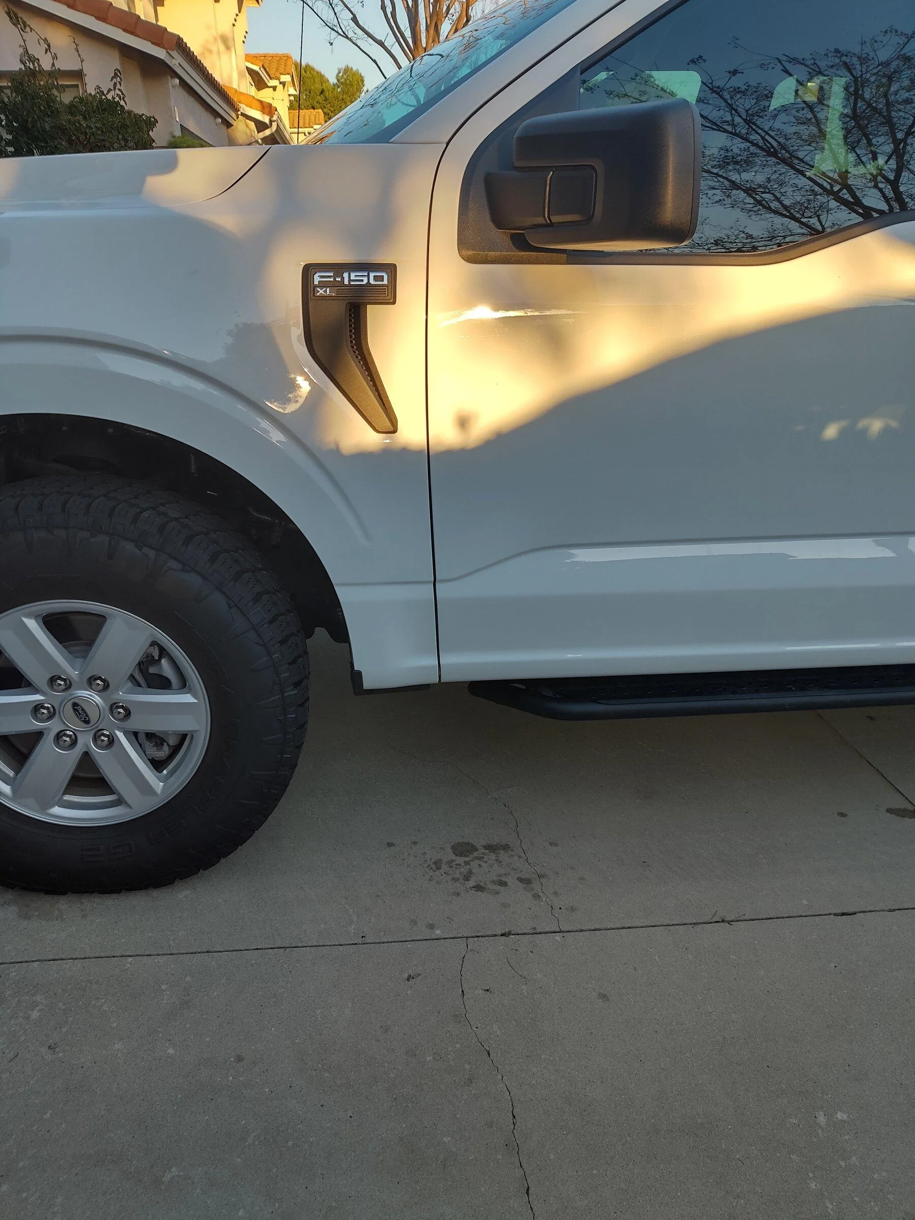

So I removed my Powerboost emblems today. I didn't want to be advertising to catalytic converter thieves that there was a pot of gold underneath.
I am certain there are better ways to do it than how I did it, but it worked so here is how I did it:
1. I used 30 lb fishing braid in a sawing motion to get the emblem off. This took probably less than 2 minutes in total for both sides. I wore gloves to not cut my hands and I didn't even take the line off the fishing rod:
Ford F-150 Thinking about removing the Powerboost emblems IMG_20220207_154613664_HDR
Ford F-150 Thinking about removing the Powerboost emblems IMG_20220207_154552543_HDR
2. Taking off the adhesive took about an hour with a plastic razor/scraping tool and Goof Off. I would spray an area and let it sit for a minute and then scrape off a layer. I increased my efficiency by just switching between each side of the car so that I didn't have to wait for the Goof Off to penetrate as I was working on the other side.
Here are the final results:
Ford F-150 Thinking about removing the Powerboost emblems IMG_20220207_165950631_HDR
