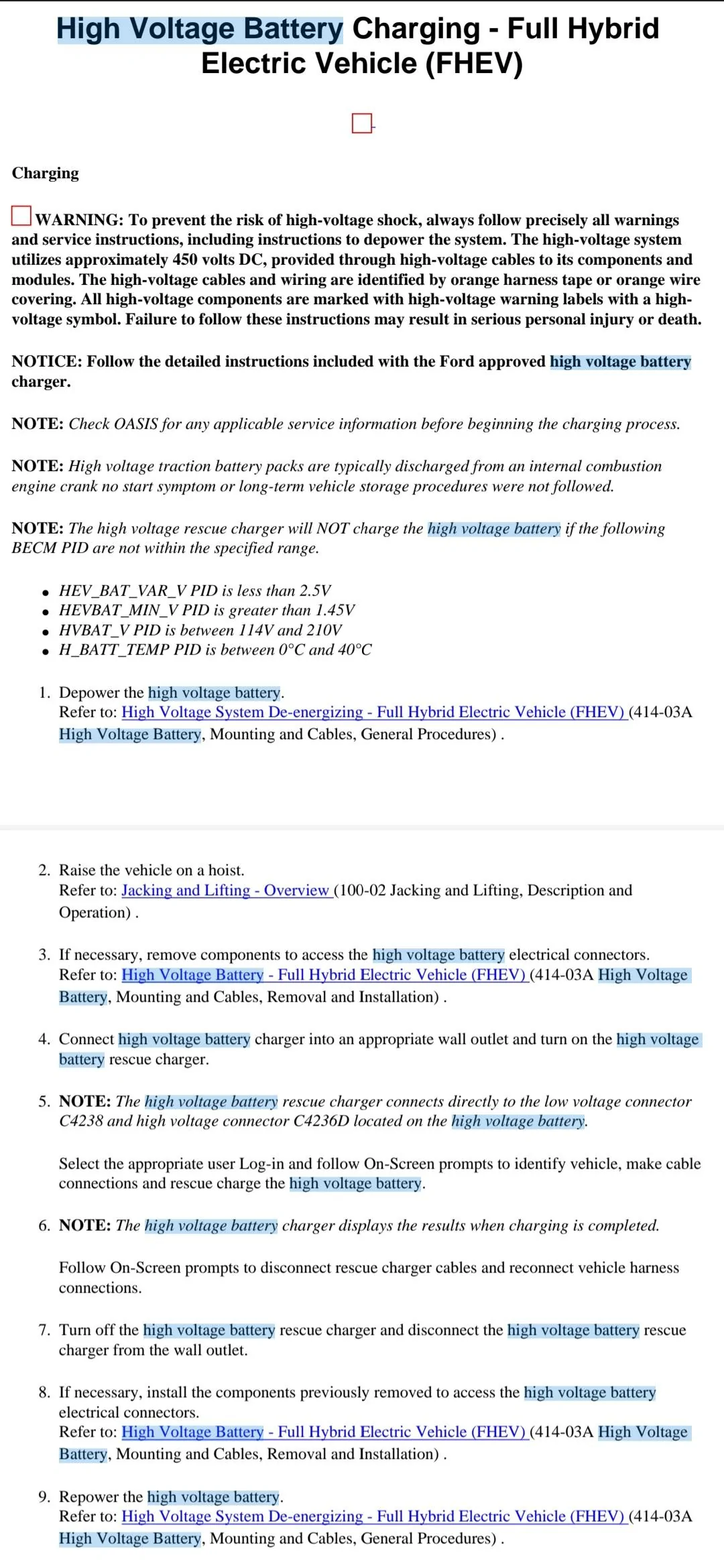

Note the notation regarding not following the long term vehicle storage procedure. :(
Your statement made me think…what is the process. This is not the entire process but the two screenshots give you the gist. Pulled it from FordPass manual. They should probably note to run the defrost with the fan on high or at least 5.
Ford F-150 The saga continues... Help needed IMG_8189
Ford F-150 The saga continues... Help needed IMG_8188
