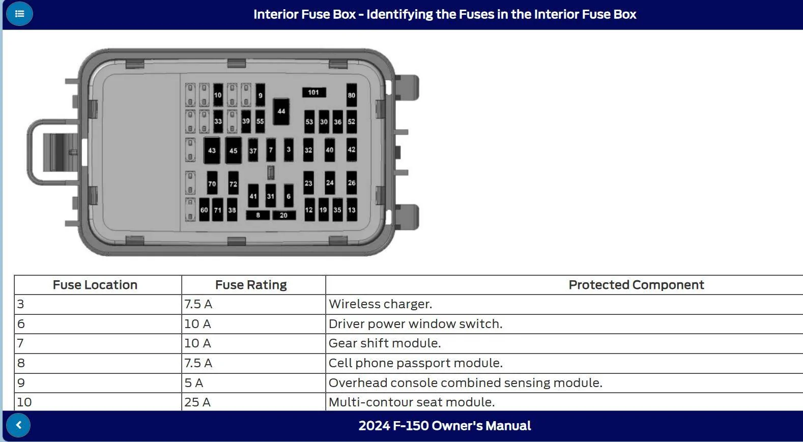

It's been a while since I did this mod, and today I opened the fuse box to reconnect the fuse to update the truck. The fuse location is in the lower right passenger side by the door hinge. Once you pull the panel off, you will see the small fuse box. The fuse you are looking for is the number 8, it's a mini 7.5 fuse.
Ford F-150 Telemetry Fuse location? Screenshot 2025-03-18 130521
