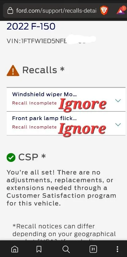

I haven't seen even a hint of a problem with the truck.
So no way am I dropping it off just because it might someday have a problem.
I get the feeling if I let them mess with it then the jinx is on. ?
The flickering affected my truck on the left light only. I didn't notice until about a month in. It only does it when I first turn on the truck or when the zone lighting is active. It seems to go away after like 10 seconds.
I might have the issue and not have noticed. But if it's a 10 second self-correcting issue, AND an FDRS update addresses it anyways, well it's still not something the dealership will ever know about.
