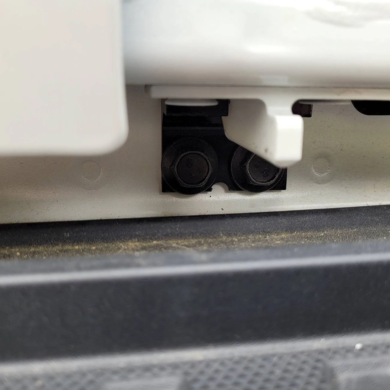

I want to add a Rampage style 60" led tailgate light bar like I did on my 2011 F150 and 2018 F350, but it has a bracket about where door for pro access tailgate closes. I can't see where it does anything except possibly support tailgate under heavy load. Anyone else remove it to make mods? I did remove it on my 2018, but that was a solid tailgate and I never had an issue. Concerned with pro access, but it seems pretty solid. I also see where they mention error codes if newer than 2020, but I can't get any info on what. I'm assuming it's the trailer connect issue, but I had to manually wire mine to avoid that.

I used the $785 Ford gave some people to buy a Putco light bar. Once I got it and looked at the back and saw that bracket, I knew I'd have a problem. The light bar is attached to the back using 4 plastic brackets that are glued/taped to the sheet metal (you can also attach with a screw through the brackets). The light bar came with brackets that were 1/8" and 1/4" thick. To be able to go over the top of the bolts, you need 1/2" of clearance. I called Putco and told them the problem and had them send me another set of 1/4" brackets. I intend on breaking the tabs off one set and glueing them together to get the 1/2" of clearance. Haven't done this yet, as shortly after I received the light bar, I found out I needed open-heart surgery. Still recovering from that, so not sure when I will install the light bar. As far as I can figure out, that bracket is there to either center the tailgate or to act as an anti-theft deterrent, or both.

I want to install this on my 2021 F150 Limited, but I have the same issue.

I just removed the bracket. installed the F150led tailgate light.
No issues with it removed.

After looking at this closer and reading the manual for tailgate removal I thiink its for that. They say to lift tailgate to 45 degrees before sliding to right. At 45 degrees the T portion will clear the bracket allowing you to move it to the right. I removed it on my 2018 F350 when installing light bar. Later on I added the shock for slowing the tailgate drop. I had the internal tailgate step which made it heavier. I think you still have to be close to 45 degrees just to clear the right hinge opening. I'll remove bracket like I did before.

any issues after having it removed for a few months? Do you haul anything with the tailgate down?

No issues, and yes I had tailgate down while hauling a few times with no problems.
