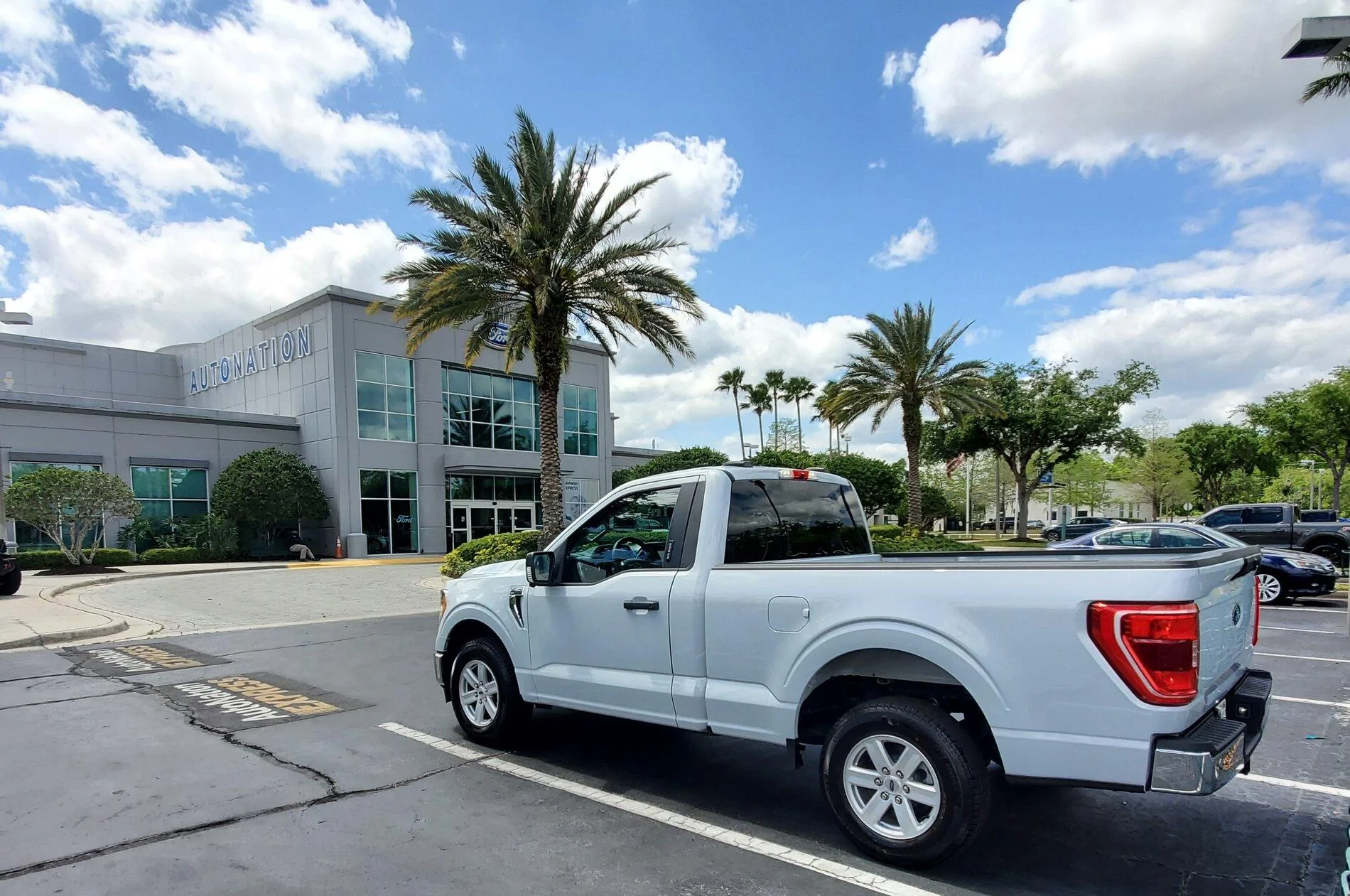

I have a RCSB XLT 301A with these lights.... BUT to be fair we build the conversion adapters to install these. My truck originally came with the mid level tail lights, halogen w/BLIS.. The 2nd pic was taken the day I picked it up from the dealership.
