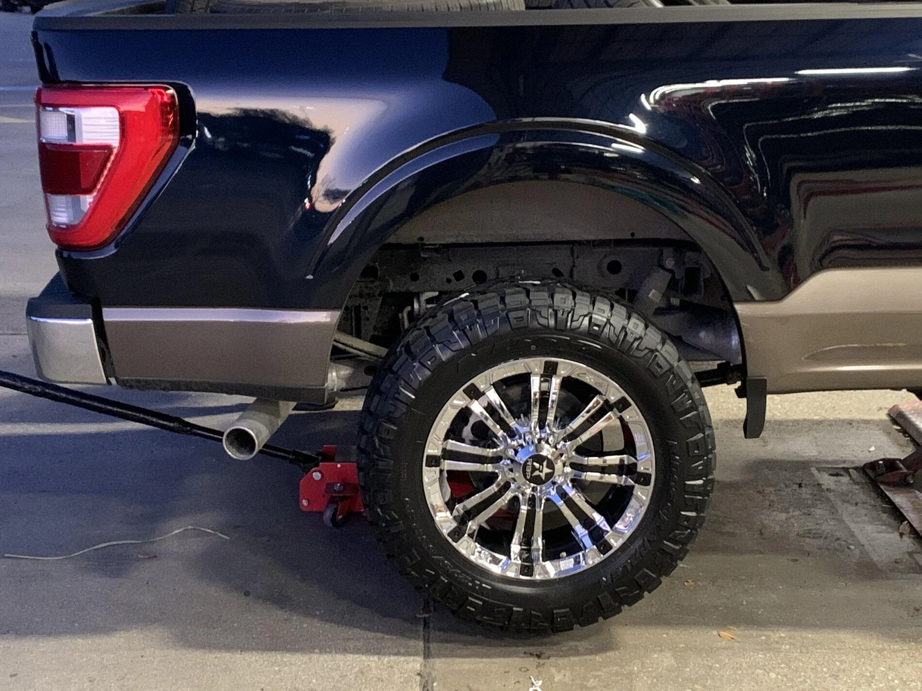

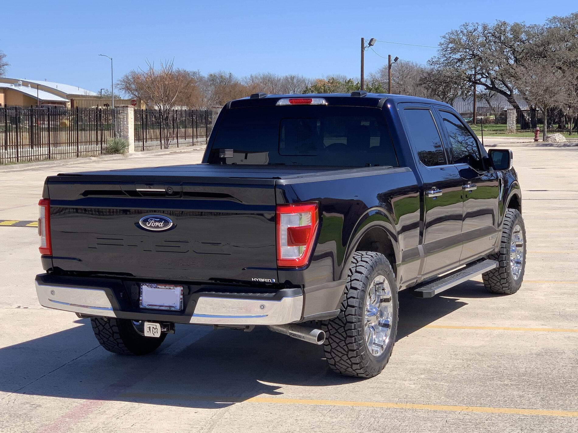

TIRES & RIMS
1. Nitto Ridge Grappler Tires
($329/ea)
275 /65 R20 126Q E1 BSW , 9" wide with a +10 offset (Stock is 275/60-20, 8.5w/+44)
2. Readylift 66-2120 Lift Kit (~500-600 parts+install)
3. RBP 94R Rims (Sexy Chrome with Black Strips, uncommon so better) ($1800)
9" wide rims with a +12 offset
As listed above, my truck is a 2x4 so clearance is just a little bit different than 4x4, but not much. The setup listed above makes for a 34.75 wide setup, which is pretty much the 'max' my truck can handle with the lift on. I get the smallest amount of rubbing when I take a sharp corner really tight, and if I was to do off-roading really bumpy, I'd prolly get more. The rubbing has to do with the fact I moved the tires out (+10 offset vs factory +44) and the size (from stock 33in diameter up to 34.5).
Without the leveling kit in the front, there's no way I could have upgraded the tires.
Pictured here are two sets of pics, both with the FACTORY tires (PVD Chrome Lariat, Goodyear) and my NEW tires (RBP Rims/Nitto Grapplers)
I haven't re-calibrated with FORScan just yet, but my initial testing shows my speedometer is just barely under 1 MPH off. (I'm going 1 MPH faster than dash says)
If you look closely, you can see the chrome HYBRID logo on the bottom-right of the tailgate, and the Chrome/Black USA Flag on the back window (left side)

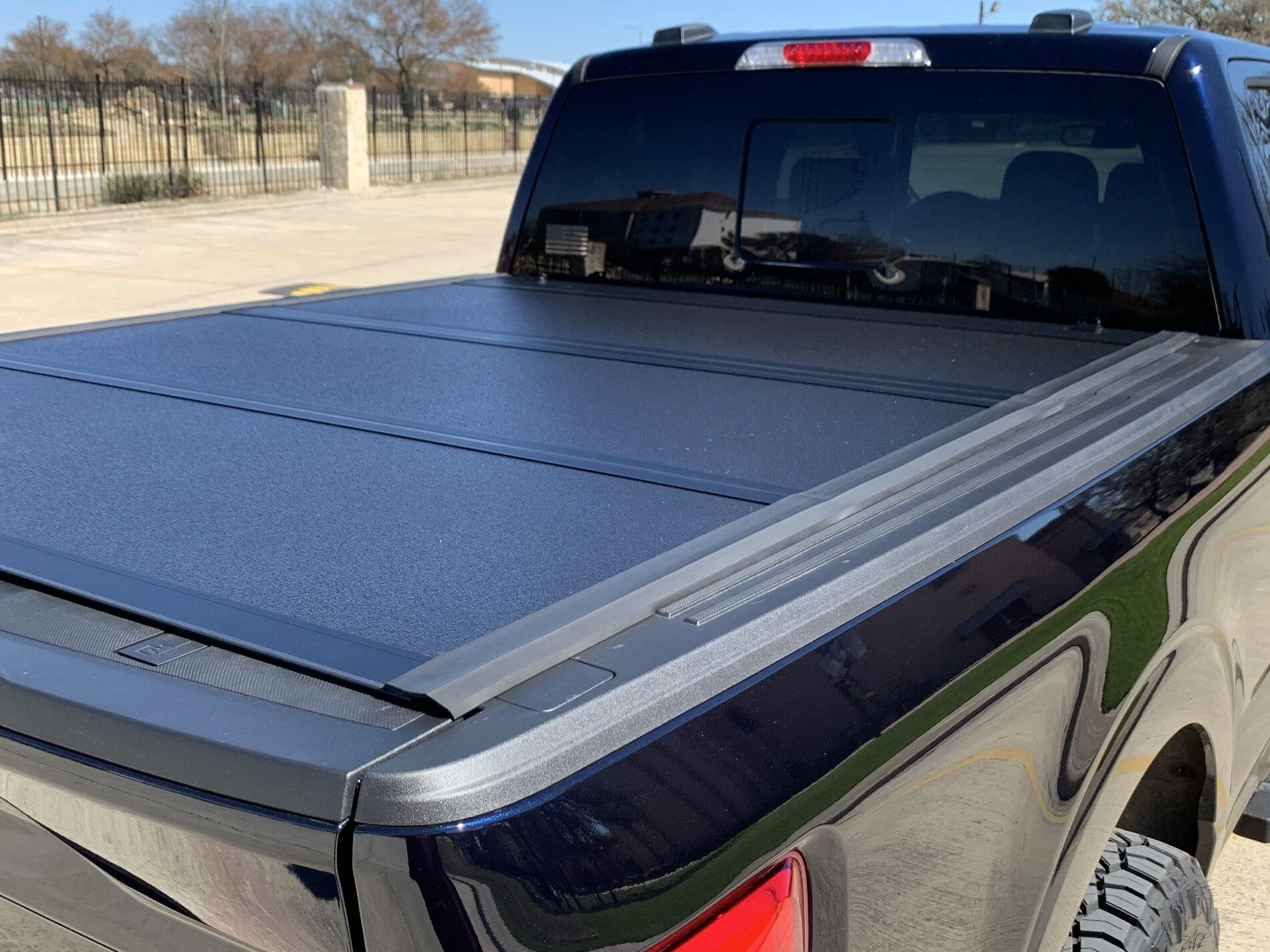

BED COVER
Undercover Armorflex Tri-Fold Bed Cover
, has line-x top and is more durable that just about anything else w/5yr warranty, works with power tailgate and doesn't really leak ($1100)
Really happy with this bed, and the Line-X on the top is a major bonus. The rubber sides have 'the fold creases' in them, but it's because it's a 2-day old install... heat and time will cause it to normalize.
I have no issues with leaks (so far) as it's rained but not super-hard, and as you can see I have it set so it covers just over the tailgate (to help stop leaking and theft methods) but not enough to keep the tailgate from automatically opening on command.
Undercover Armorflex is made by the same parent company that makes the cheaper BAKFlip line, but other than that they aren't really related. This cover costs about $100 more than the BAK's, but totally worth it in my opinion.

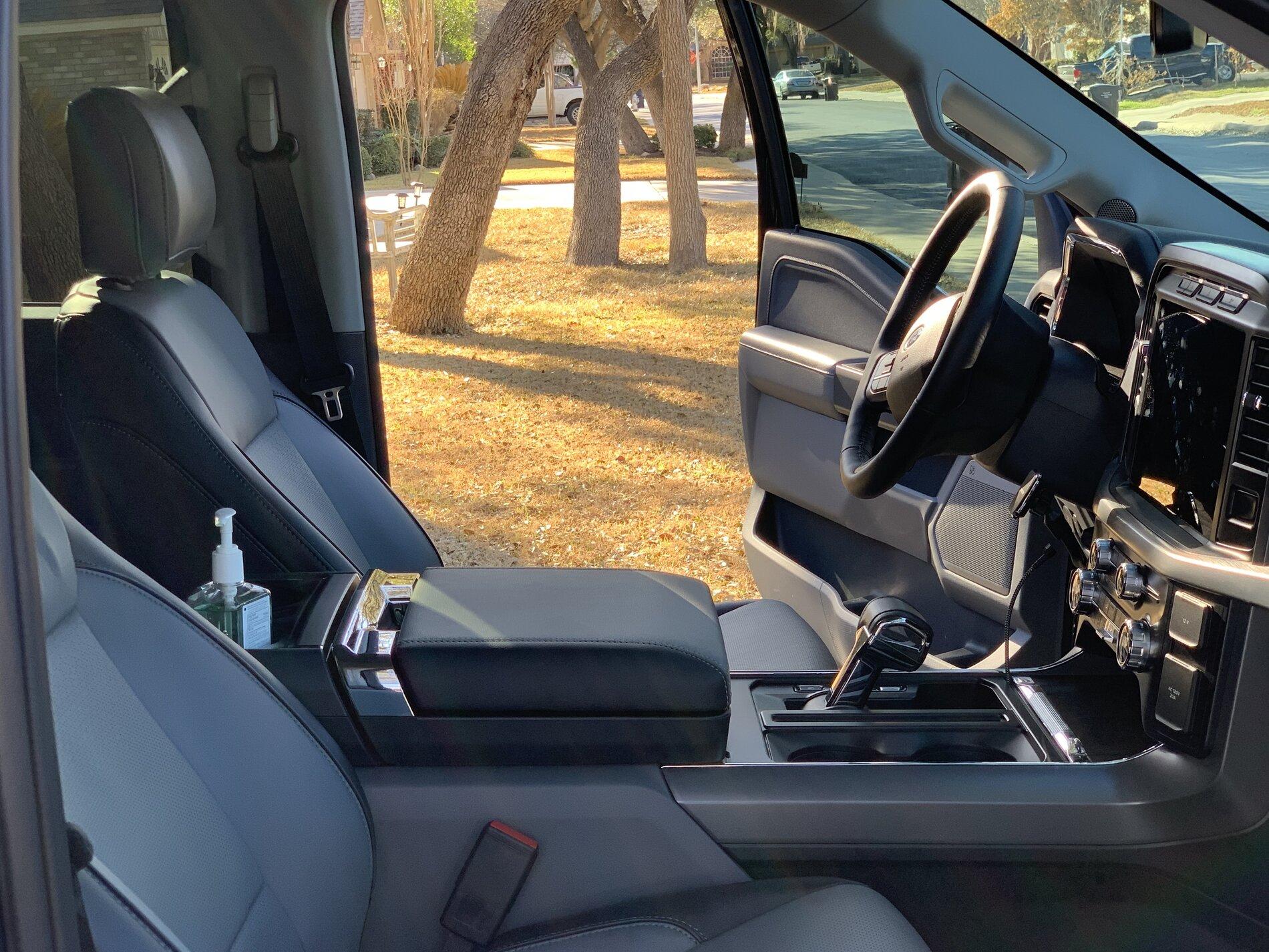

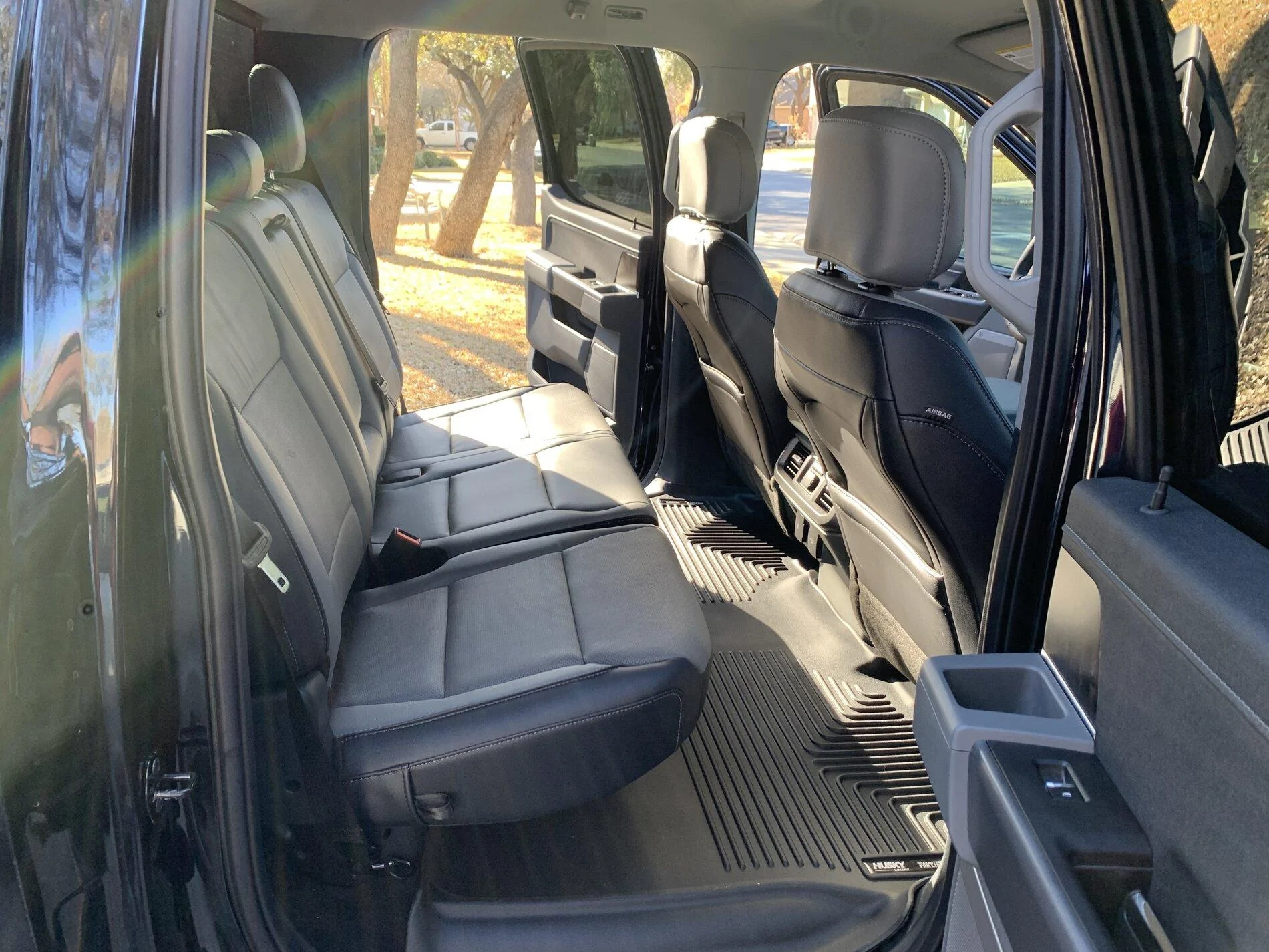

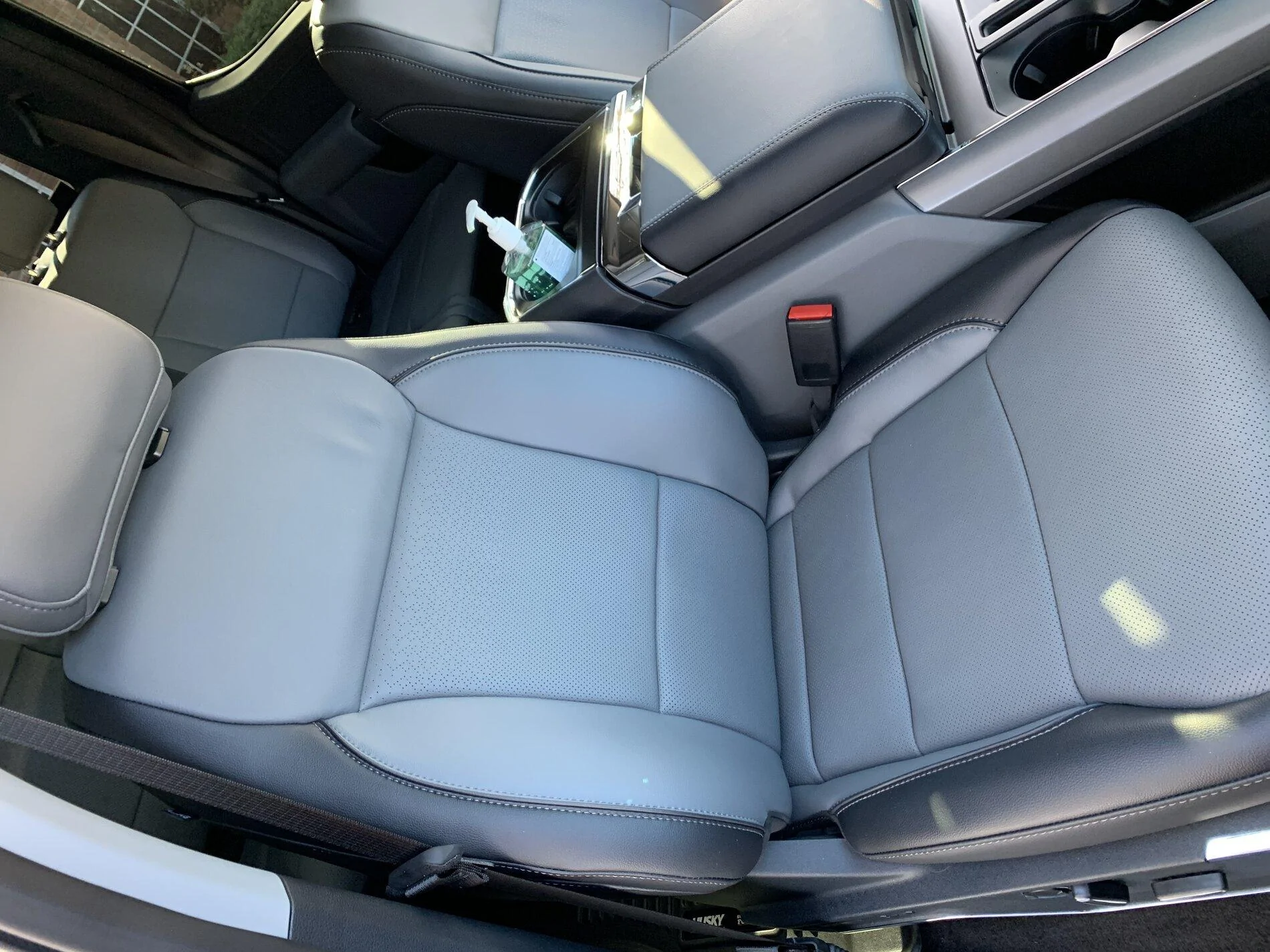

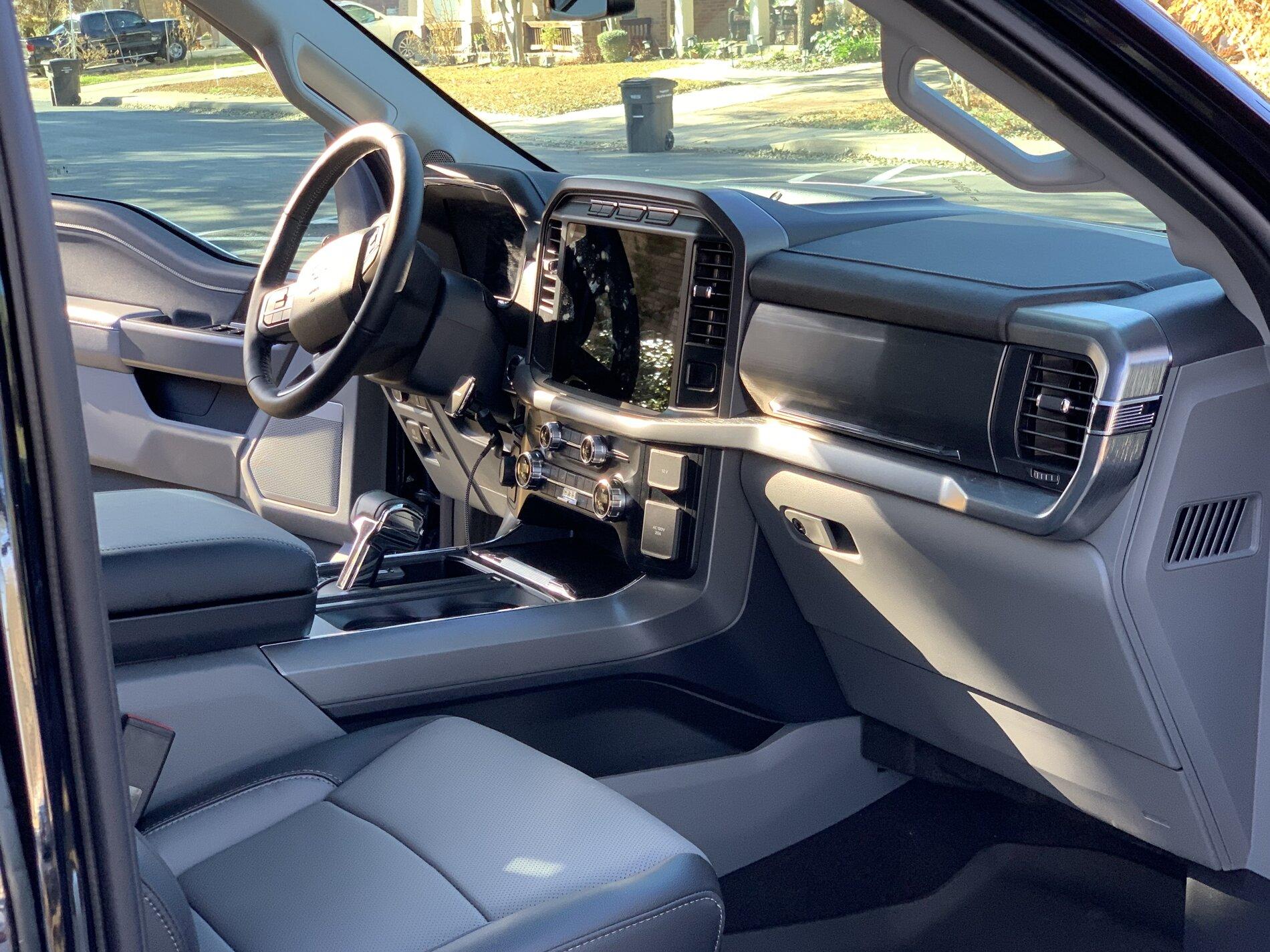

INTERIOR
Don't sleep on the "Medium Graphite" on the Lariat. I know a lot of you young guys love 'black', but it looks far cheaper, holds ALL dirt, and is just black everywhere. Notice with the Graphite you get various levels of gray that blend in well and compliment one another with quality, and hide dirt far better.
My truck DOES have the work surface addon.
All seats (front and rear) are perforated (the zillion little holes), and I don't have the B&O Unleashed, just regular B&O. Because this is a PowerBoost, I do NOT have a converter under the back bench seat, as you can see. The weird thing you can't figure out is a set of latch-tools for the bed that came with the truck (plastic sealed on a cardboard base). I put them there so they wouldn't slide around.
At the tint shop one of the employees had a 2020 F150 Lariat, and he sat in mine and was like 'holy cow', and I asked him if it was really that different? He said 'come see', we sat in his - and yeah, wow. Biggest changes I saw right away were the more 'upright' shape of the dash made the inside cab seen almost twice as roomy, and the quality/craftmanship is lightyears difference. Of course he has the 8" screen (as 12" didn't exist yet), but even the layout of it AND the console (center) both felt very lacking and less detail.. esp. with all the new zone lighting and such. Huge differences.
High Quality for a Truck (Lariat).

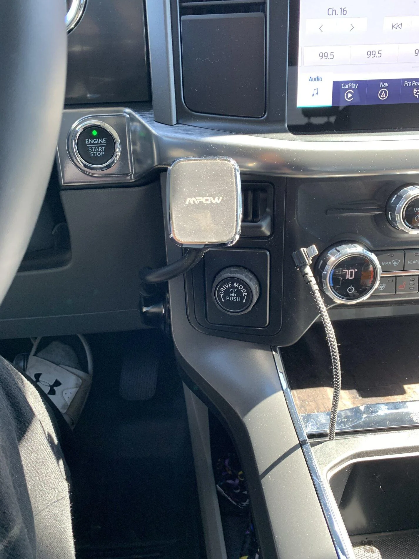

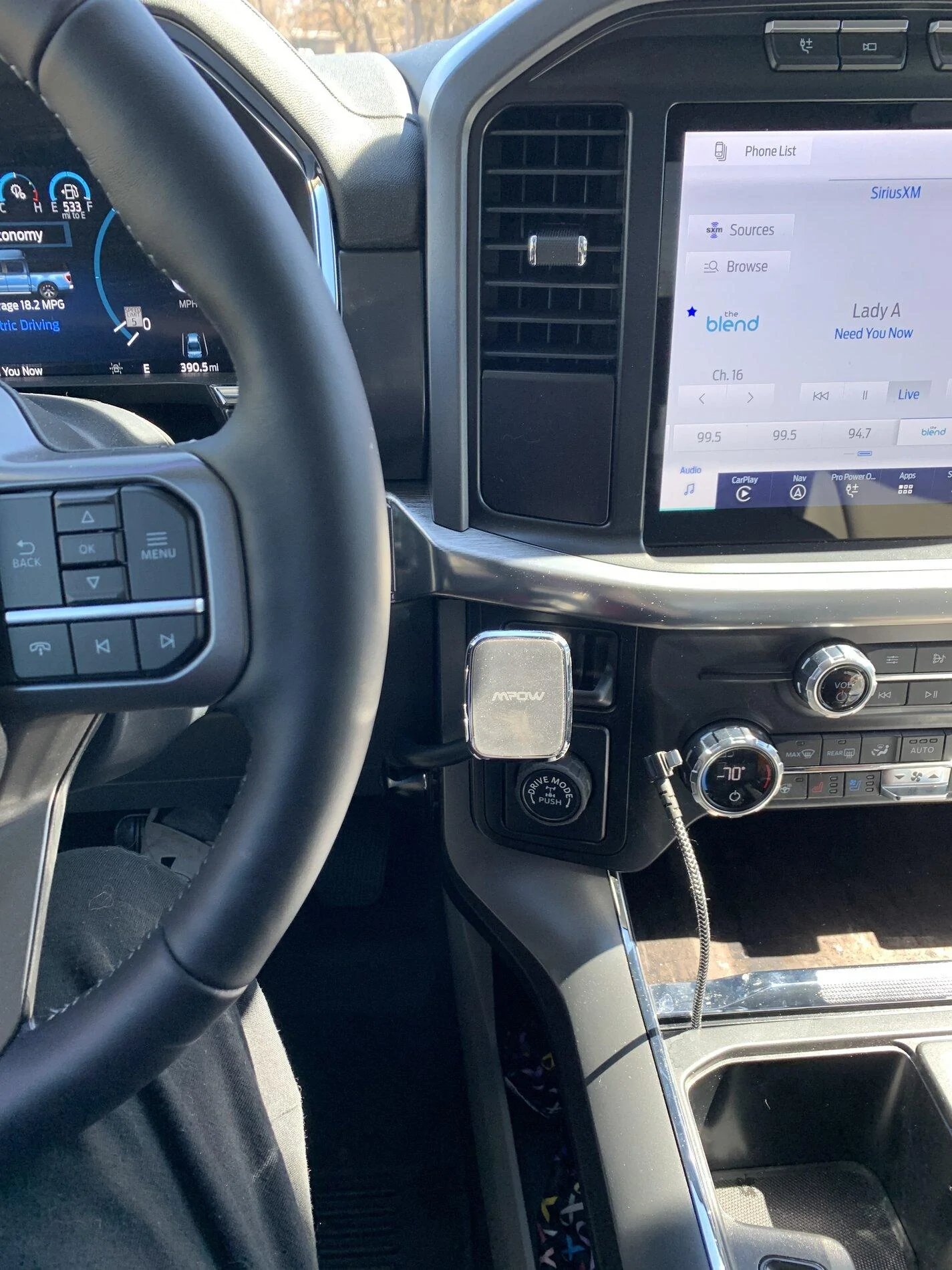

PHONE MOUNT/HOLDER
Magnetic Mount Flexible Phone Holder ($18)
The wireless charger is over-rated. Get this sweet phone holder (magnetic), mount it on the side... and your leg never touches it. Add a 1-foot cable for direct connect and you're golden.
The mount comes with 2 different very thin metal plates that stick to the back of your phone (between phone and case if you have a case), allowing your phone to 'just stick' to the mount. With where I placed it, I can see phone at all times just to the right of my view of the steering wheel, and thanks to the 90-degree cable, it doesn't bump my leg - and I'm a big guy at 6'2" tall.
My phone isn't on the mount because I'm using it to take the picture... so there's that. ;)
The positives : Not blocking air vent, not blocking anything of regular use, between steeringwheel/cluster and 12" display, which is a place I'm often glancing to anyways... and it's 1-foot cord is perfect distance for plugging in down below. I also have a USB-C cord for it too as the truck has both USB-C and regular USB

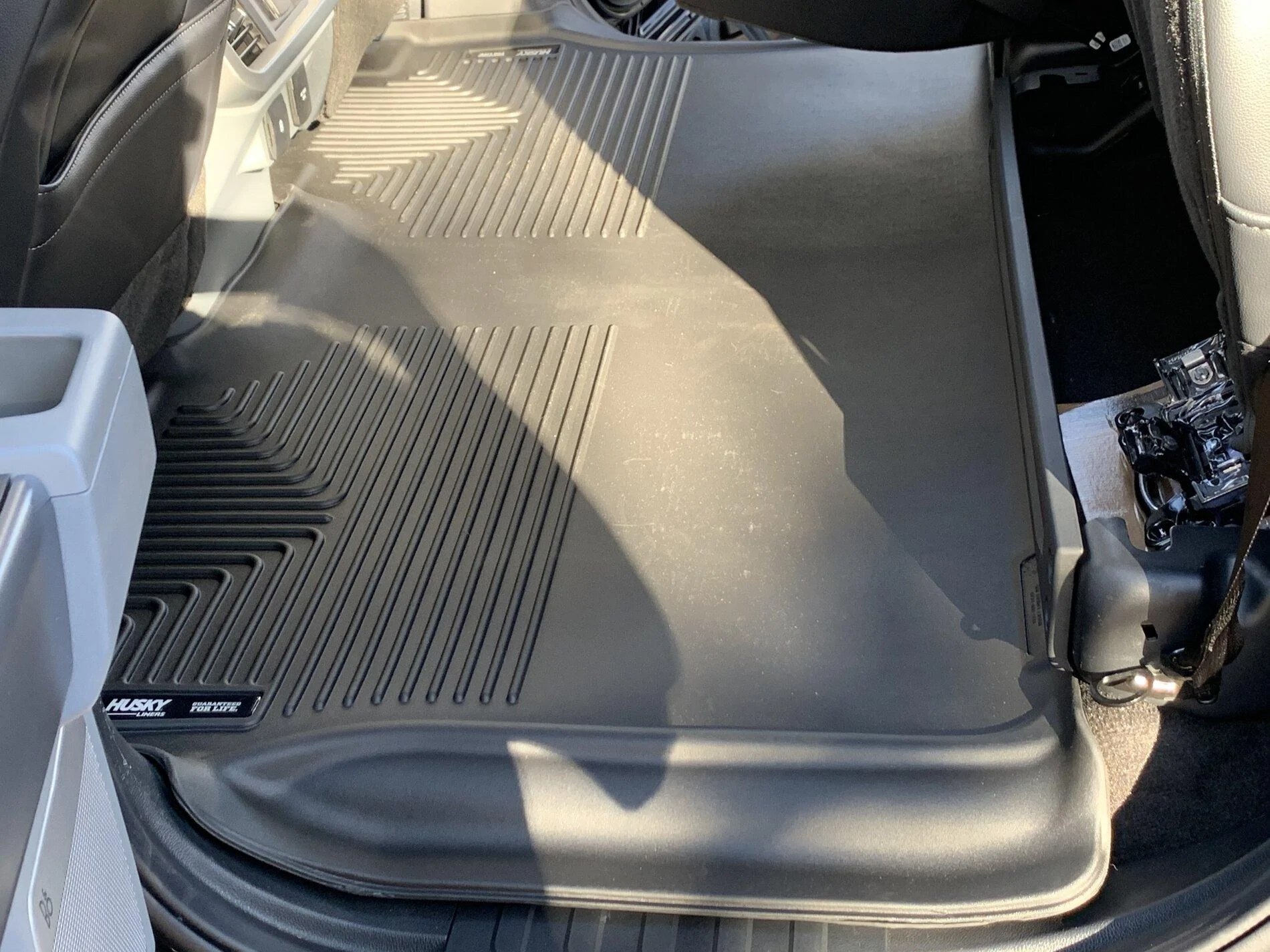

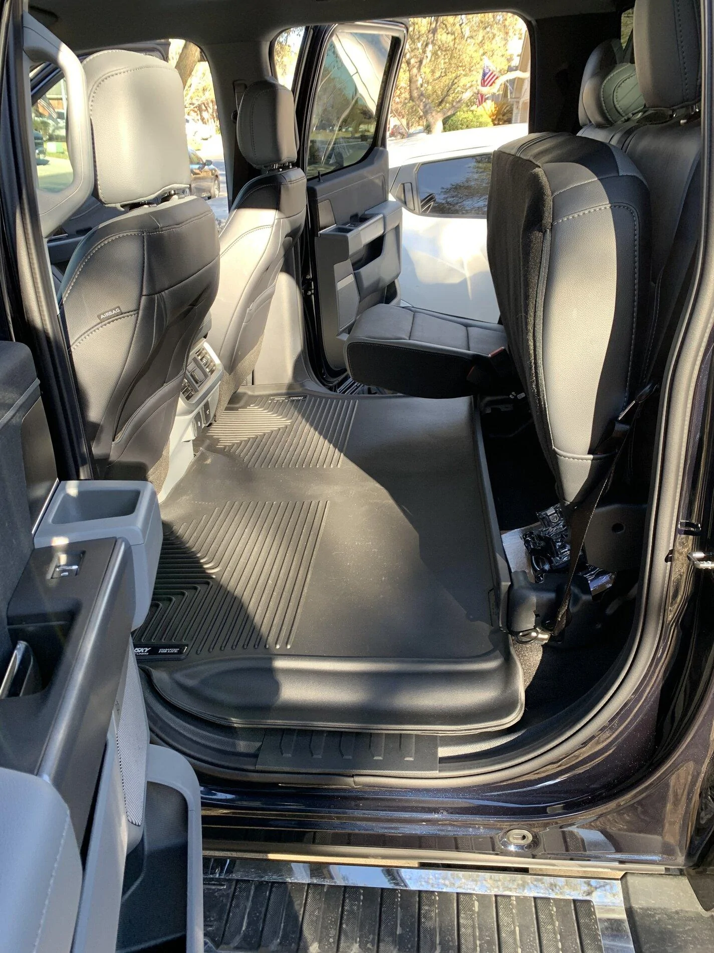

HUSKY MATS
Love the Husky mats... in my Lariat I don't have rear-locking storage so it was just a simple 3-second install. Love the fact they're hard, but also a little soft and giving. They're also known to keep their 'black color' over time, which others apparently don't.
