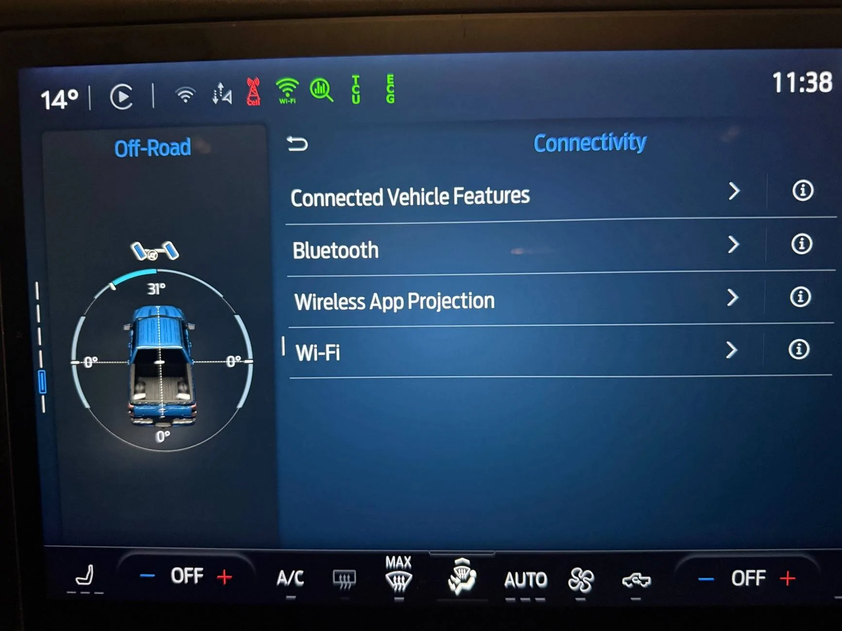

Jeff, this is the wi-fi network that is part of how you can use CarPlay or android auto apps on SYNC. Go into Settings > Connectivity > Wireless App Projection and you will see the Proj network. You can tap "show password" to see it. As to why it's asking for a password? Something isn't right in SYNC would be my guess. The things I would try are:
1: the phone suggestions above
2: reboot SYNC (hold down audio power and track forward buttons until the SYNC screen goes black)
3: Perform a "reset password" on the wireless app projection screen
4: reset SYNC from the settings > General (I think).
SYNC is meant to populate its own password for the Proj network, I believe. Because the phone and SYNC use Bluetooth for the initial connection to CarPlay or android auto, also make sure Bluetooth is on and functioning. Re-adding your phone after deleting it from SYNC and deleting the truck from the phone will prove that Bluetooth connectivity works.
