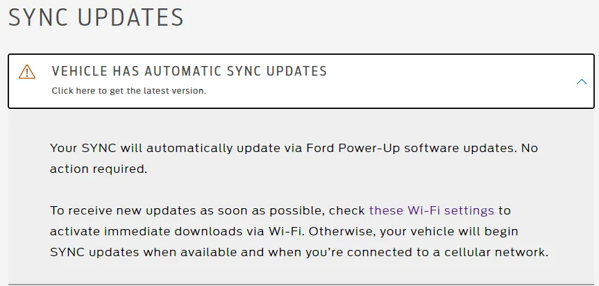

My 2021 Powerboost (VIN: 1FTFW1ED0MFB28588) is at Sync version 22177 product revision 473.

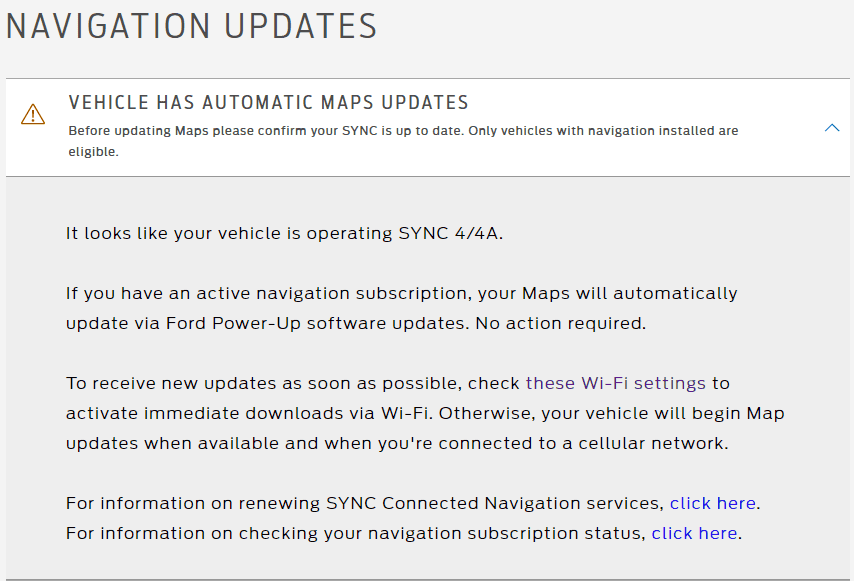

The website for Ford Pass says my VIN has automatic sync updates and map updates available.
But, my truck believes no updates are available.
I've tried with wifi on and off, and in both cases checking for updates doesn't find anything to download.
I believe SYNC 4 Version: 22293_PRODUCT Revision: 610 should be available.
When I call Ford Sync support they say I need to take my truck into the dealer to get it updated. So, essentially the over the air update system doesn't work.
Does anyone have a workaround that would let me download these updates and get them installed without having to schedule a dealership visit?
Thanks!

The "check for updates" button doesn't work like your phone or computer. It will only display something if an update has been made available for your vehicle. Other than the APIM/Sync update to add Alexa, most updates are small enough that they'll be downloaded and applied before you have a chance to hit that button and see something in progress.

Don't go by the FP website. It always says that. The box in the lower right of the screen shows the sync stuff. The above has always been there since I can remember.
