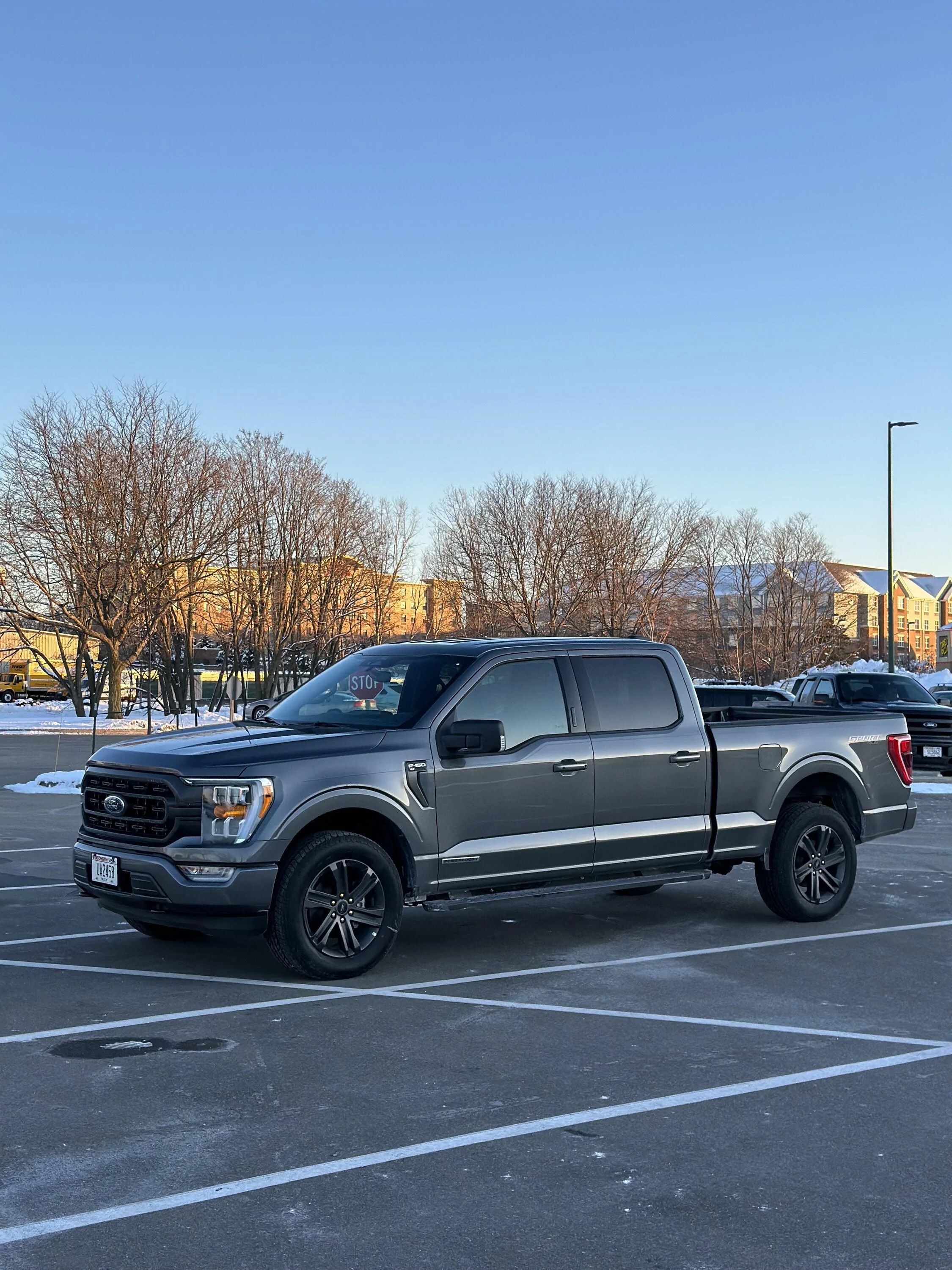

Here is my truck in stock form on the factory 20's: I weighed these with my cheap Amazon scale and they came out to 78lbs btw (I've seen other post a tad less).

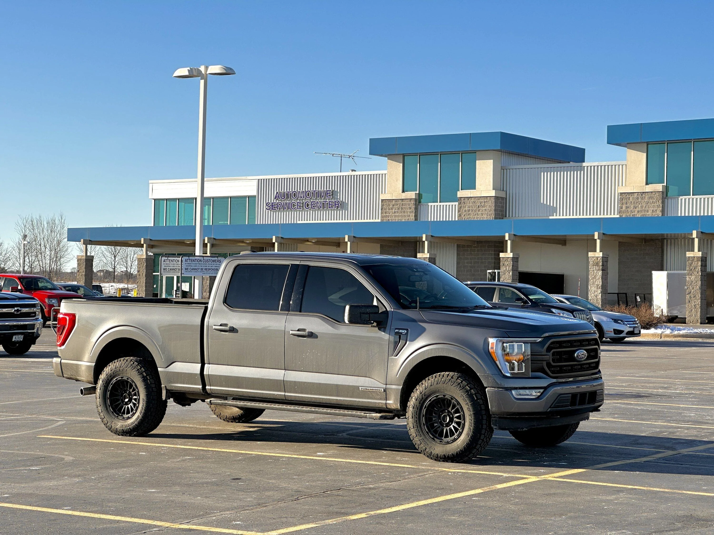

My First Wheel AFTER suspension: KMC Impact, 17x9" +18 w/ Toyo Open Country ATIII in a 285/75/17 (84lbs)
I decided to go with the 285/75/17 due to weight as the 285s are lighter than their 34x12.5 counterparts and 17's are also very light. I also wanted a 'skinny' tire because I live in WI for snow and because of efficiency. Being transparent, one of my clients is WheelPros and they own KMC which is how I got these wheels. There ARE lighter wheels but I like to support those who support me. I weighed these using my crappy scale too and they came in at 84lbs, 6lbs heavier per corner over stock (roughly).
The 285/75/17 with +18 fit fine with zero rubbing (I even think I could have fit these without a level) and when I first installed them, I had my front suspension set at the 2inch lift mark, rather than the 2.5 it's at now. Here are those pics.
285/75/17, 17x8.5 + 18 with suspension at 2inch mark on a PowerBoost (which is a little lower due to weight):

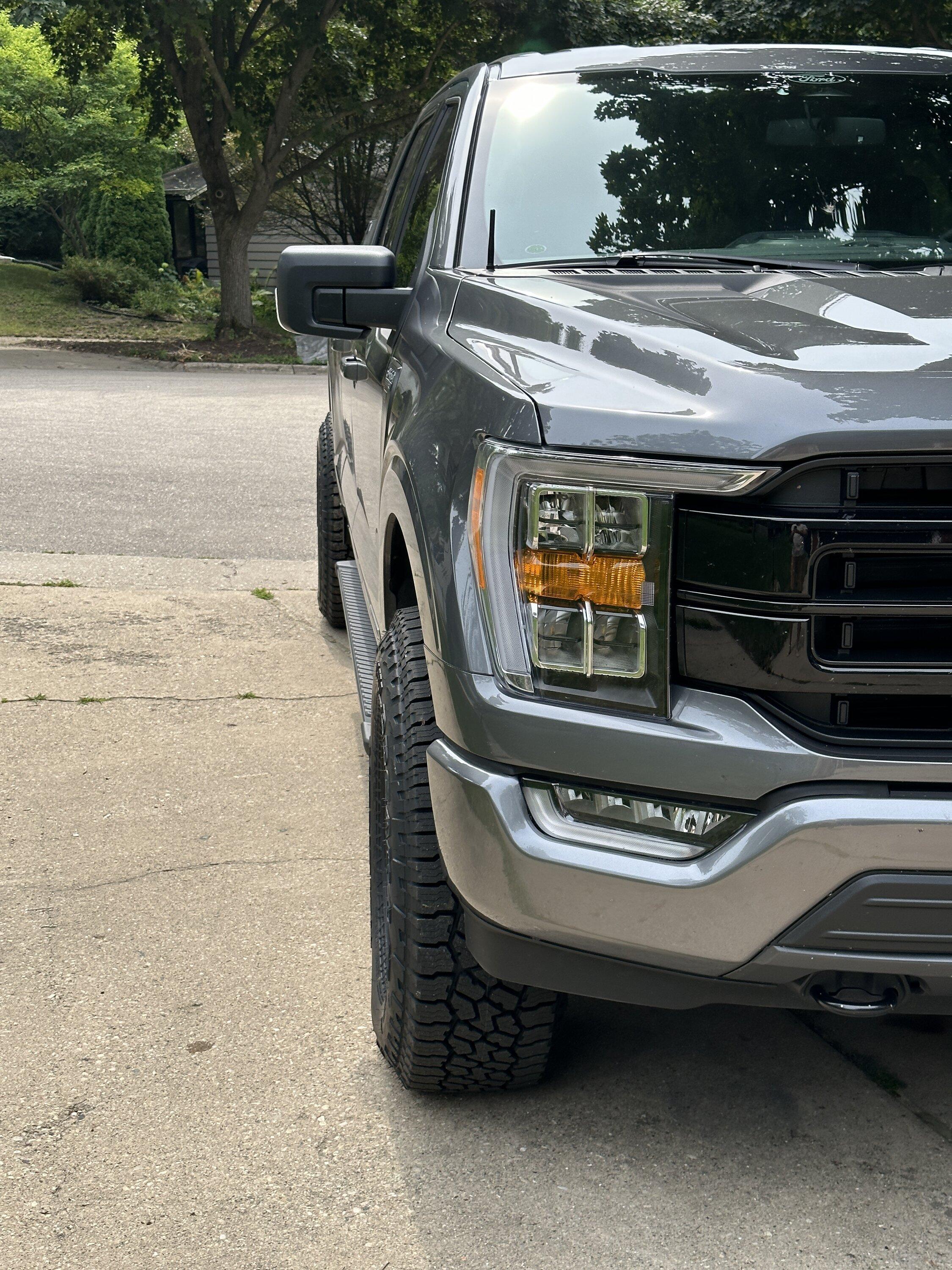

Here are those same wheels/tires with my front suspension set at the 2.5" lift setting (and a new grill):

Current Setup: 285/75/18 Falken Wildpeak AT3W w/ Black Rhino Chamber in 18x9.5 +12mm (101 lbs)
Why did I leave behind my beloved gas mileage and add over 20lbs per corner from stock in rotating mass to my hybrid!? BECAUSE 35'S, BRO!! ? :LOL: In all seriousness, at the time of writing this and getting the new wheels Black Rhino didn't have any 17's with a positive offset for the F150. They did have a few options in 18's ranging from +18 to +12 which is what lead my decision to go to the 18 (word on the street is they'll have a new wheel for F150s in a +38 this fall :cool:). I have to be on their wheels through the end of the year at least (and they are actually an incredible company to work with!) so I'll be rocking this setup for the time being. I would like to paint these though as I'm not a huge fan of black! Anyways...
There is a lot of discussion around fitting 35's on these trucks and we've all come to the conclusion that they fit no problem with a high, positive offset wheel. But what about a +12? The 285/75/18 isn't a true 35 (it is marked 35x11.5 on the sidewall though), but it's actually a 34.84" and this varies slightly based on manufacture.

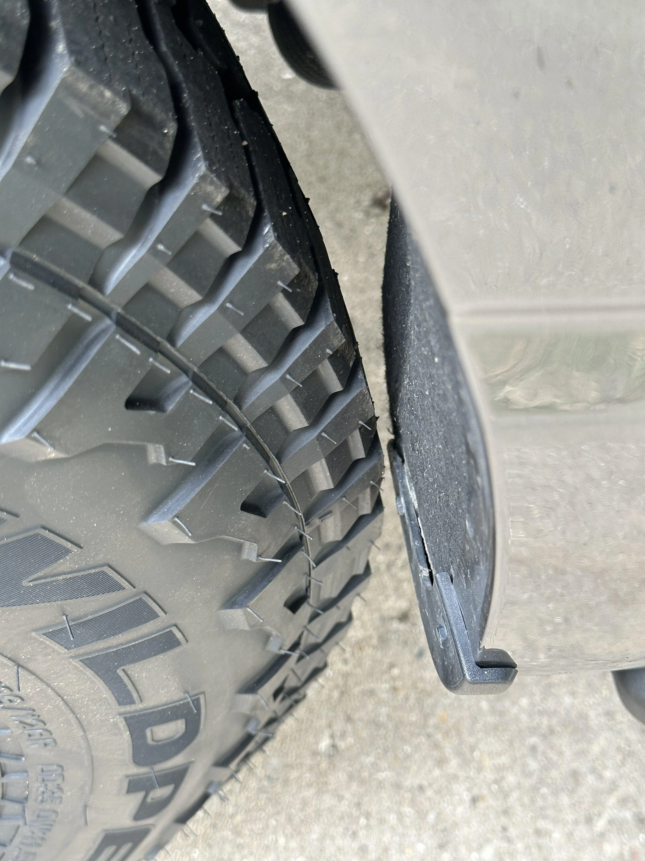

What all did I have to do to make the almost 35 fit with these new +12mm wheels?
  • Crash bars should probably be removed. I got away with bumping mine with a hammer a bit to widen them, but in stock form you're hitting crashbars when turning. After widening mine, I have enough clearance to drive around without rubbing BUT in the odd circumstance that I hit a large bump and am almost full lock, i'm rubbing for sure! Also note, the battery cooling lines run right behind the rear crash bar brackets. I've seen videos of people widening their bars, that could be difficult with the powerboost because you're very quickly running into these coolant lines if you do that.
  • Cut your air dam! Yup, just the inner fender bottom corners, so not much, but for sure taking off a half inch or so.
  • Level the front. Again, i'm at 2.5inch level setting up front and you need this extra height to give you clearance.
  • POTENTIALLY shave off some plastic on the front cab mount(?). I don't know the exact term, but the wheels is dangerously close to it. I've been driving and hitting bumps hard trying to listen for rub and haven't hit it yet, but I think if I did a trail with full compression, I'd rub there too. For daily driving, so far so good.
Driving Impressions: I've only had them on for two days so I'll update when I know more!

Driver Side, front cab mount clearance

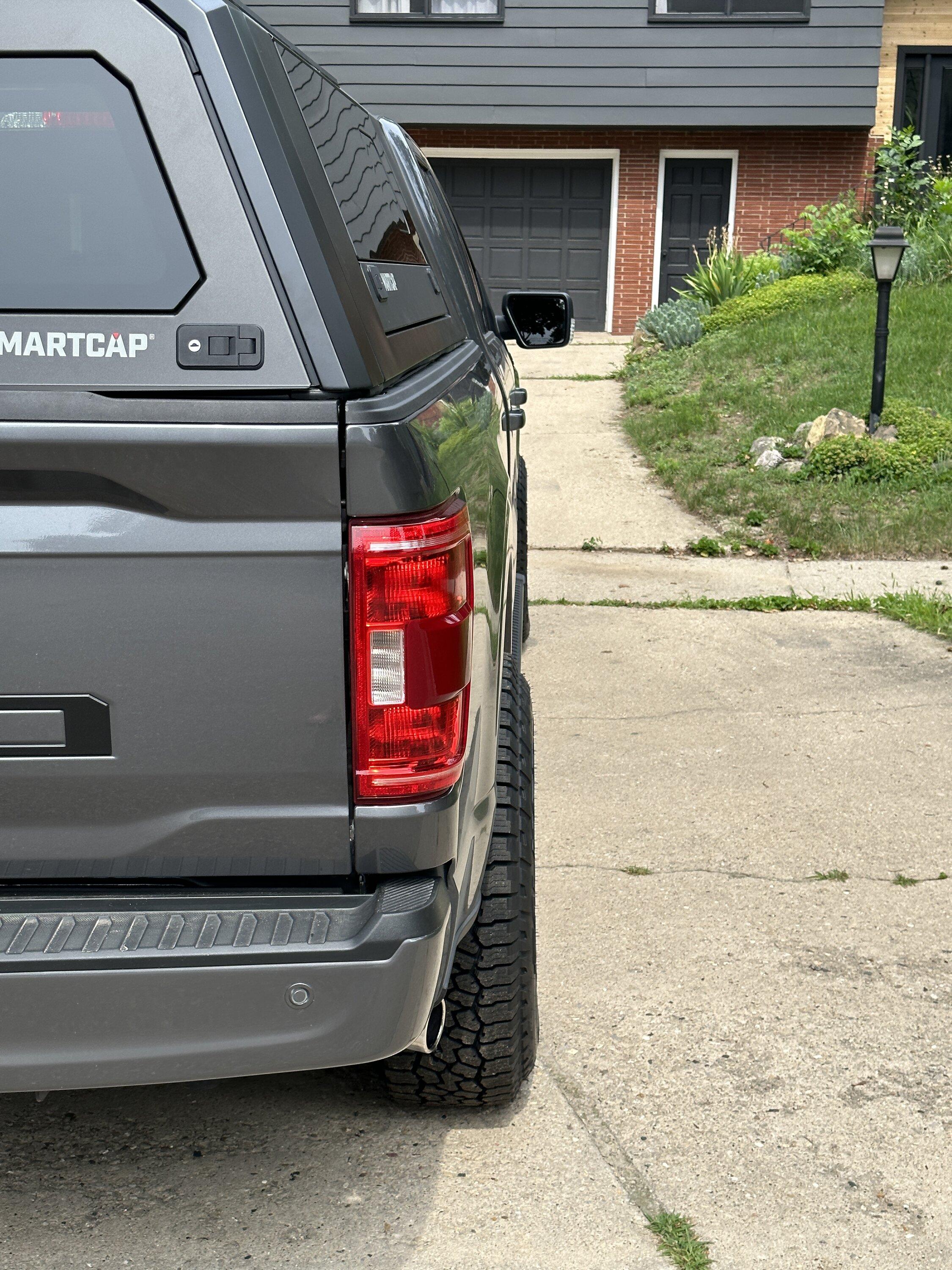

So far, yes. When I was debating which to go with I priced out a few fiberglass options to get close to the features I wanted here (mainly almost full bed access opening side panels) and that wasn't an option in non work-truck type tops. That narrowed it down to this style which made my decision easy. Go Fast Campers has a topper too, but with the cross support rails you still have a little issue pulling larger items out (like a foldable camp table in my experience) otherwise they were number 2 on my list!
Having the gullwing side doors are awesome. I just got back from a 4 day camping trip and I used them to hang towels on, easily grab camp chairs, etc., without crawling into my bed which was great.
I ended up paying around $900 more to get this than a loaded fiberglass version and feel happy about that. If you have a regular bed, the used market is pretty easy to find in the $3,300-$3800 range.
