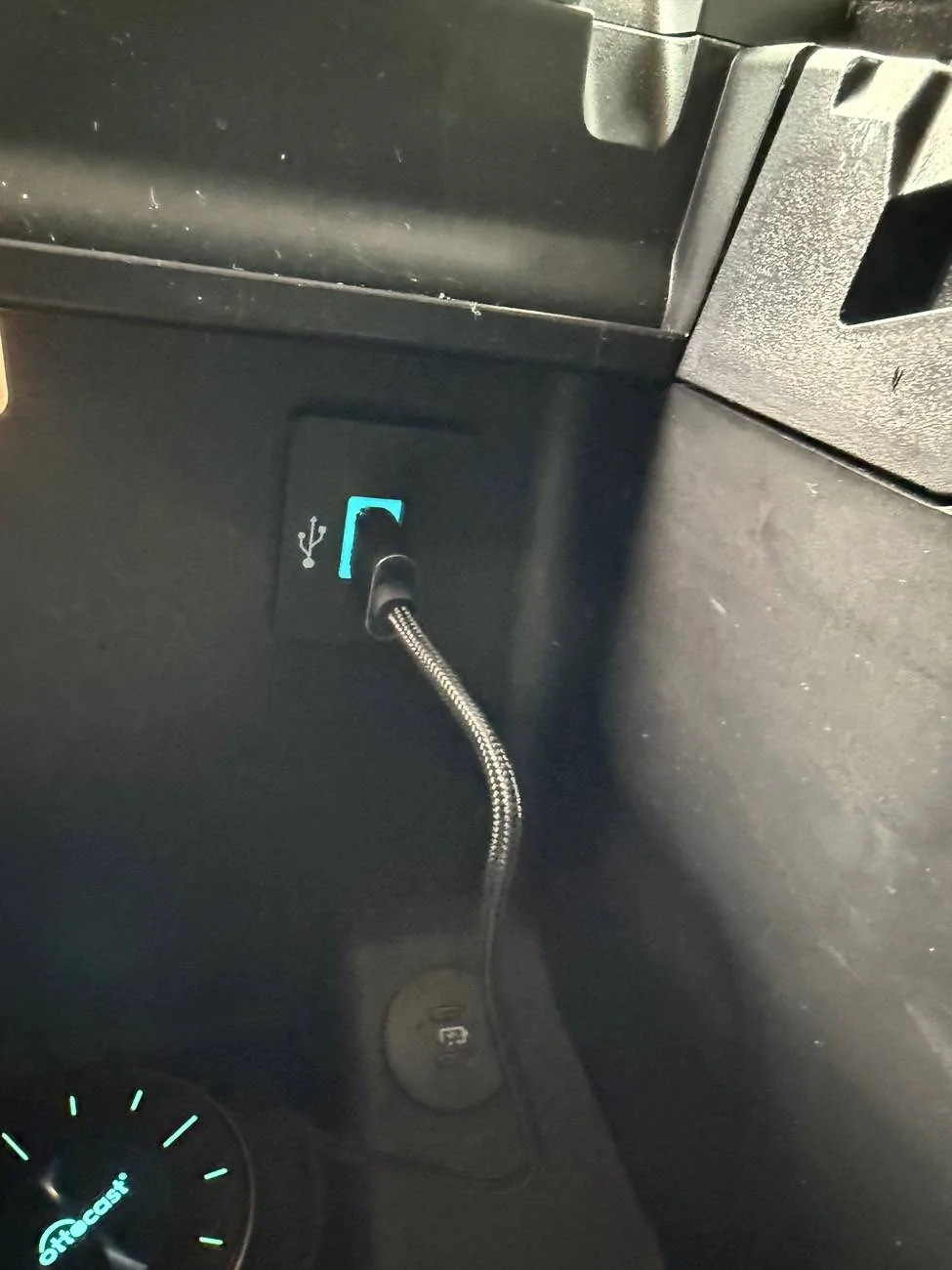

Probably a long shot, but do any of you Ford electronics gurus think it might be possible to swap the USB port locations in the media bin with those inside the enclosed center console? I would prefer the two ports in the media bin be for charing only and those inside the center console be for USB stick and wired AndroidAuto/Carplay.

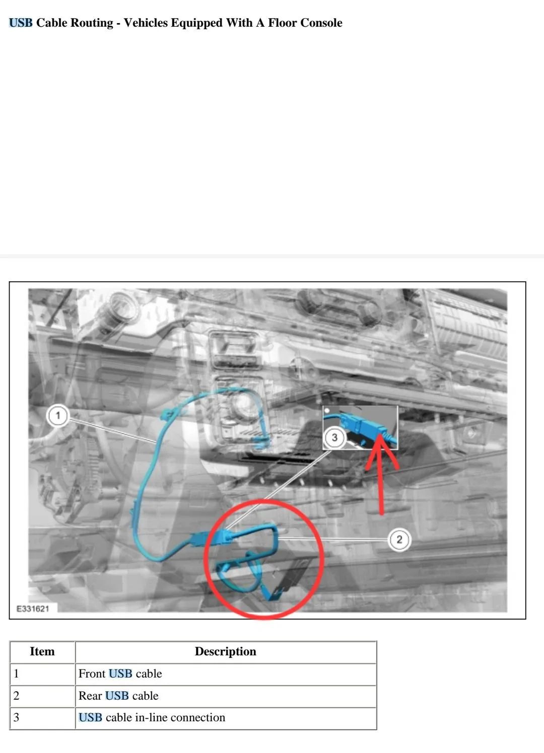

If you look closely, (second image) you can see the cable that connects the media bin USB hub to the cable that routes to the APIM or GWM? I don't know exactly which.
That's the cable that would need to be made longer and reach the USB hub in the console storage.
