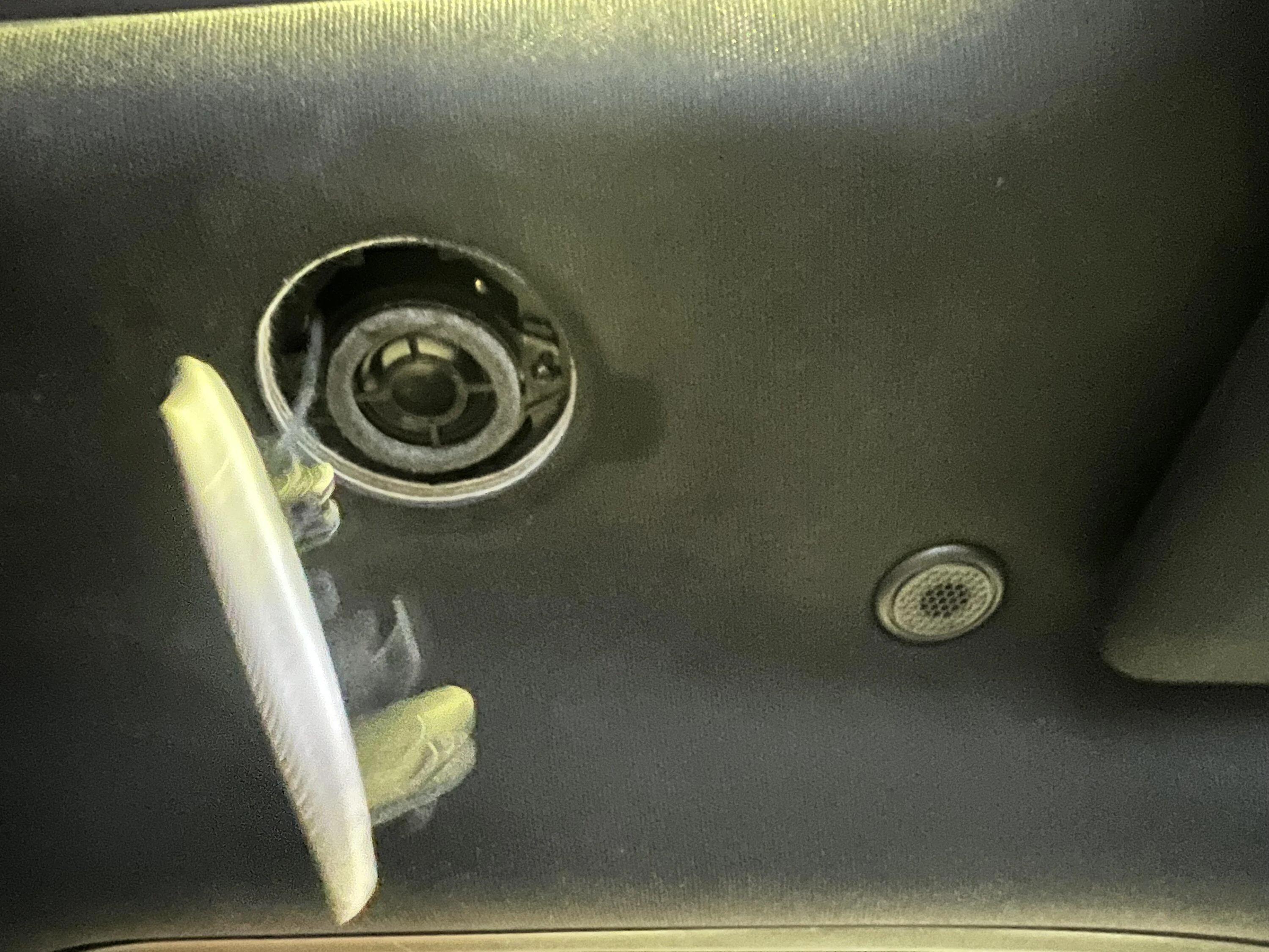

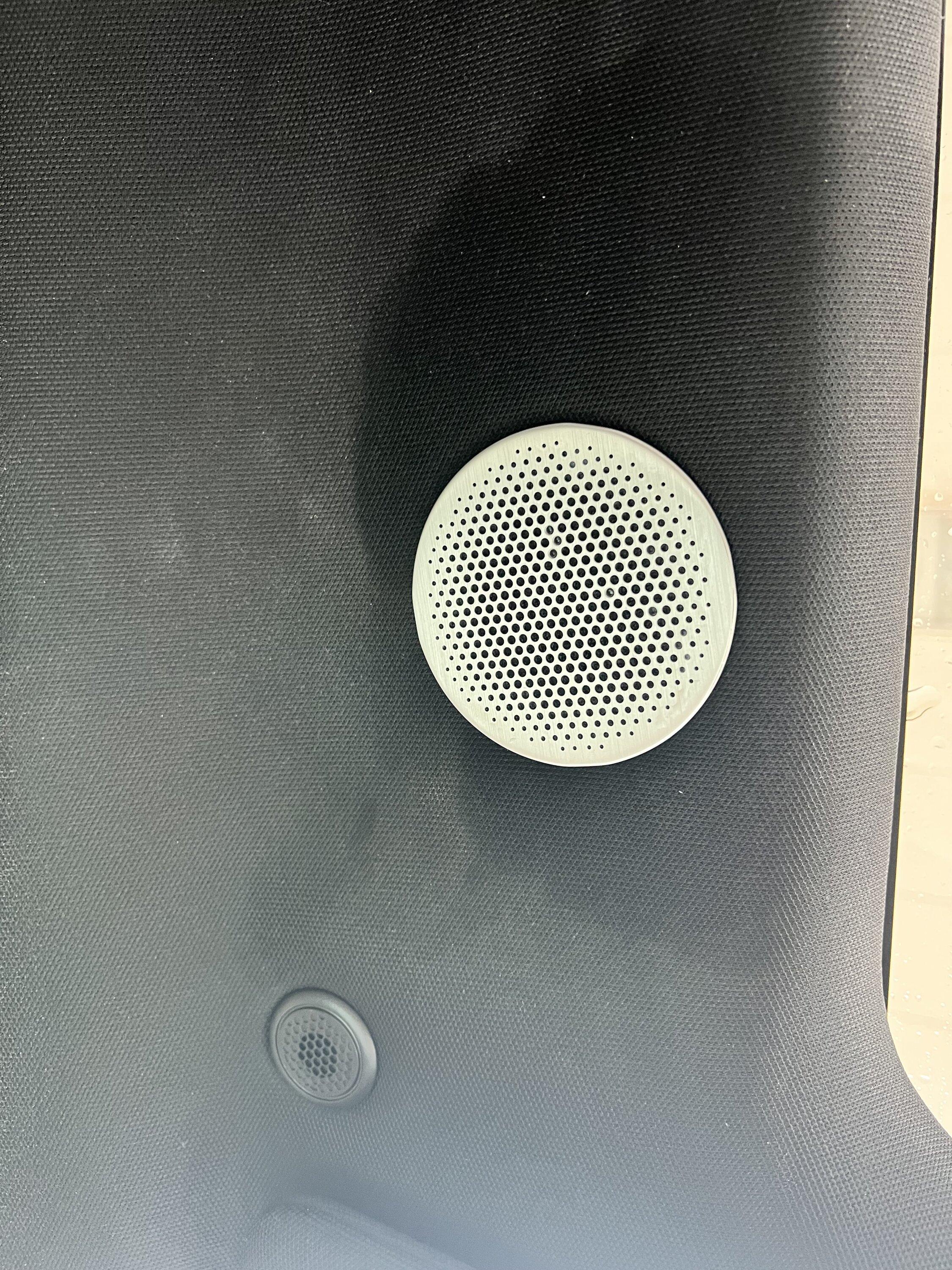

I am having the same problem, water seems to be coming through the drivers side tweeter and the headliner is wet around it.
I’ve taken it into Ford twice and they can’t seem to figure out the problem.
Vin #1FTFW1E89MFA80317
Dealer used:
Cambridge Ford Limited
2450 Eagle Street North
Cambridge, ON, N3H4R7, CANADA
