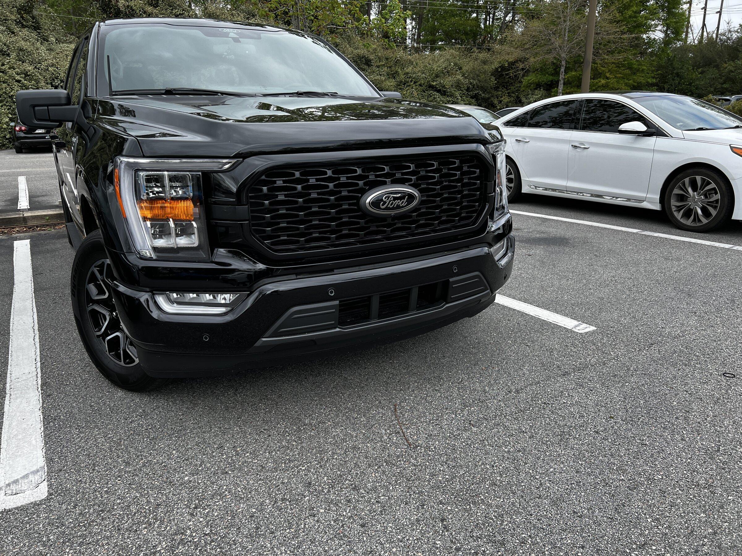

This is just a proof of concept post and to see if anyone needs the encouragement. I looked long and hard and found plenty of people posting asking about it but no examples of it actually being done - the STX to XLT grille swap. I bought an OEM 2021 STX grille from a dealer (comes primed from the factory) for around $600 and had it painted agate black to match my truck for $250. The dealer I bought it from and the paint shop both gave me a hard time since it was "incompatible". I'm glad they didn't scare me off because the job was simple, plenty of videos of the grille being removed and if you follow them you will succeed. The grilles are 100% interchangeable with no modification required. (p.s. if anyone wants the grille I'm in SC and willing to sell/ship)
Another part I'll mention since I did it during the grille replacement was fitting the black appearance package OEM Ford badge pictured. It's technically for a 2020, but I can tell you if you are even remotely handy it is an easy retrofit. The only fitment difference is behind the badge where the front camera sits, I had to glue it in place in the actual emblem so it's seated correctly and there's no difference from factory. I'm impatient, who knows how long before the 2022 BAP badges will be available lol
