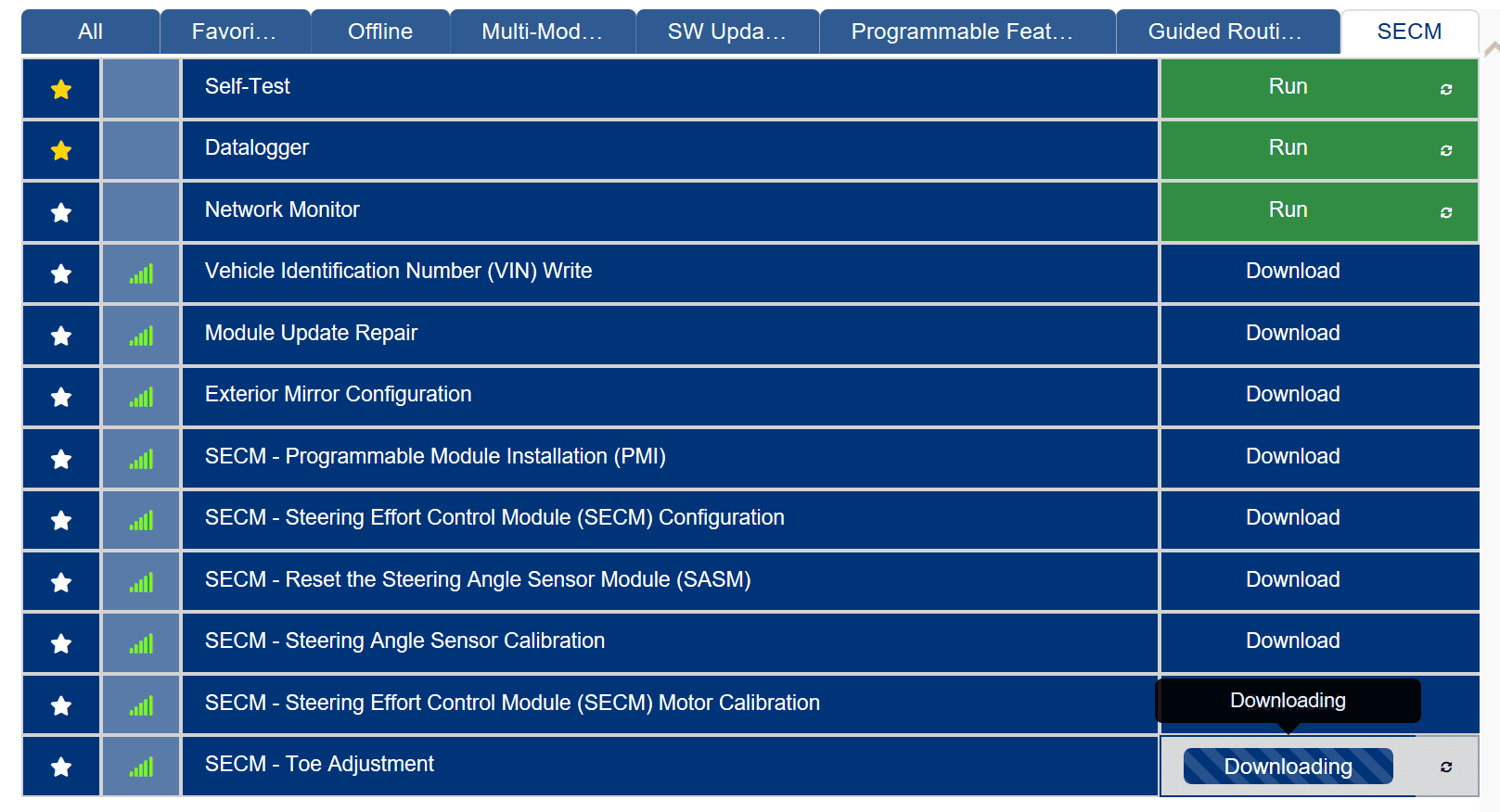

Looks like you would need FDRS. If it isnt in the Wrench section of Forscan. Toe adjustment seems to be something that needs to be done while on the Alignment rack

Thanks for this. I was afraid that was going to be the case. Seems strange that FORscan would not have this function. I wonder if they’re working on it.
That SECM doesn’t even appear in FORscan when I connect. I found a device from a third party company that claims to be able to access the SECM and perform the reset. I may give that a try.

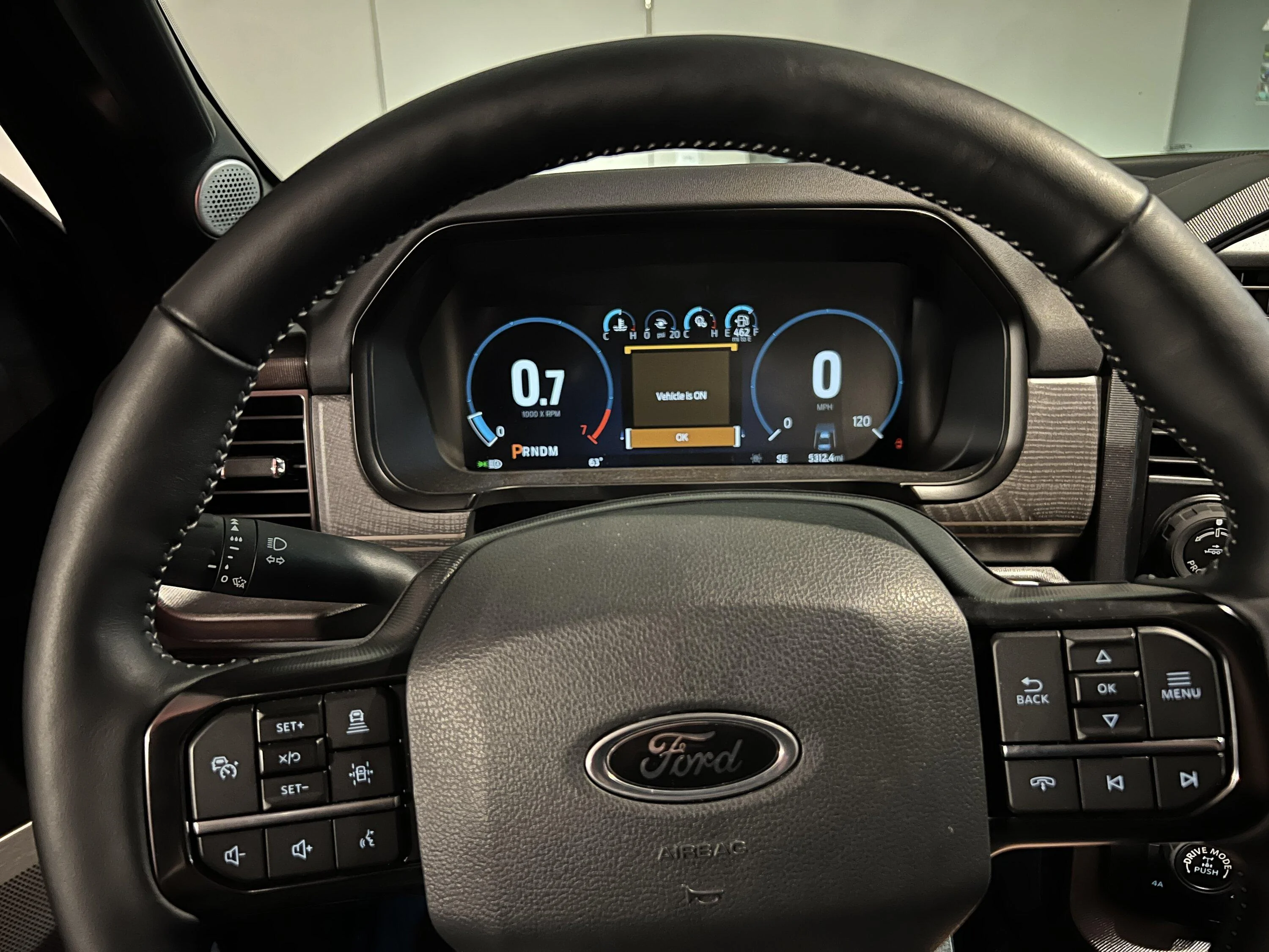

Here's a short video I made showing how far off my steering wheel is from center compared to the FORscan STR_ANG_C readout: Video link (YouTube)
I can only think the truck must have come this way from the factory and that the dealer who did the first two alignments didn't re-zero it afterward. It's about twice as far off as the steering wheel centering that I was trying to correct with the alignments ever was.

Adaptive Steering System
The SECM controls the functions of the adaptive steering system and communicates with other modules through the SASM over the HS-CAN2 . The SECM and the SASM communicate over a private CAN .
To activate, the SECM requires the following:
  • Battery voltage
  • Ignition voltage
  • Communication with other modules over the HS-CAN2
  • Power pack status message from the PCM
The SECM uses a motor to turn a toothed hub connected to the steering shaft to add or subtract incremental turns to the driver steering shaft input. At low speeds the same steering input from the driver delivers more front wheel angle, providing more low-speed agility. Low speed maneuvers require significantly less steering wheel rotation. At high speeds, straight line driving precision is increased, providing the driver with an improved highway driving experience and feel during moderate-to-high-speed cornering.
As the driver turns the steering wheel, the SASM detects the speed and direction of the steering wheel rotation and transmits this information to the SECM over a private CAN . The SECM responds by activating the motor in the appropriate direction and speed to change the turning ratio of the front wheels, thereby reducing the necessary number of steering wheel turns required by the driver.
The SECM is self-monitoring and is capable of setting and storing Diagnostic Trouble Codes (DTCs). Depending on the nature of the DTC set, the SECM may send a request to the IPC to illuminate the adaptive steering system warning indicator and display a message in the message center, alerting the driver of a potential adaptive steering system concern. The warning message is sent over the HS-CAN2 to the GWM where it is converted to a HS-CAN3 message and sent to the IPC over the HS-CAN3 .
Buy a mongoose and get FDRS so you can get it handled. Take it back to the alignment shop and let them use it to do the alignment. That is how the alignment is supposed to be don e in the trucks witht he SECM.
