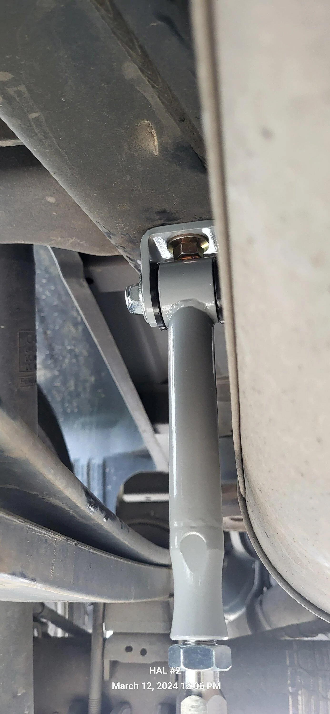

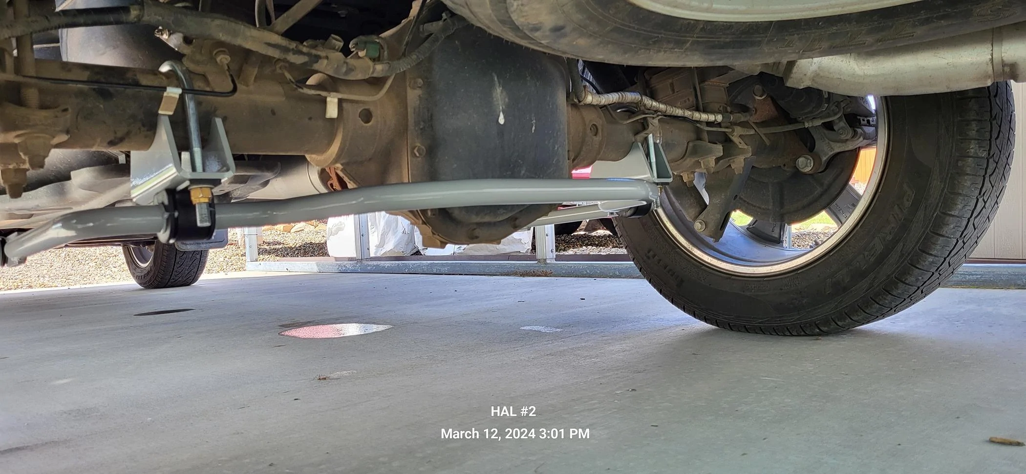

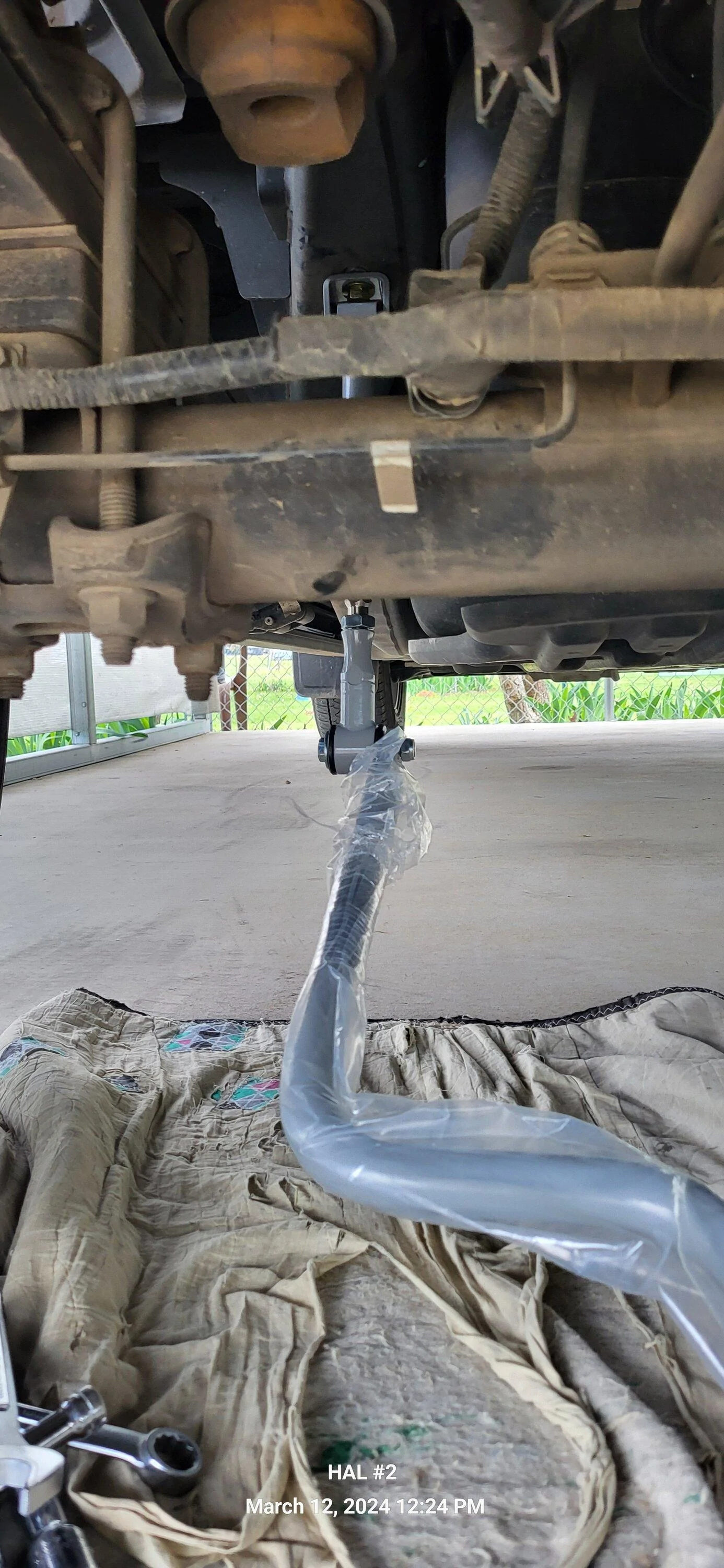

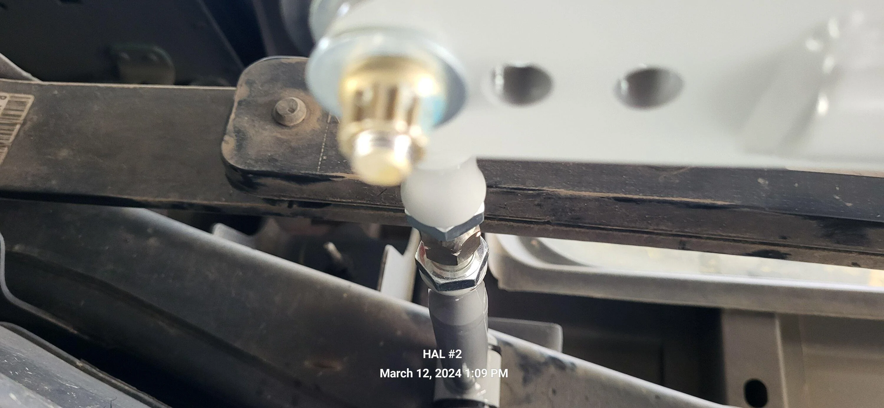

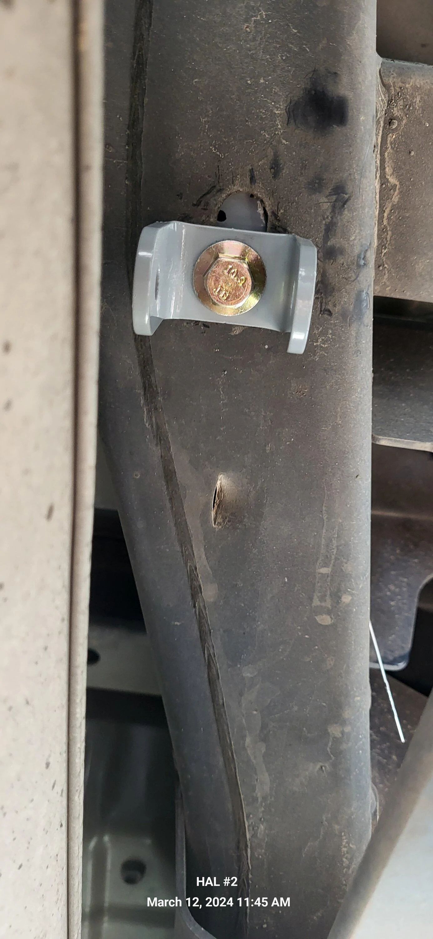

i installed it this morning in the driveway, with no need to lift truck in the air
even my large frame had room to slither around on a blanket
my score is 1 to 10 with 10 being the best or easiest
price was 619.95 and took just under 2 weeks to arrive
i give price a 7
time to delivery after purchase an 8
fedex getting lost and delivering 2 days late..a.4
installation instructions PAPER 5, (included)
Installation instructions VIDEO 10 (online, really helpful)
ease of installation an 8
i figure the average person, with a good knowledge of hardware, torques, and some mechanical knowledge would have zero problems installing it.
i have not driven it yet, as i ran out of time this afternoon. I did the bounce check before installing it to listen for noises. my truck is pretty quiet
after installation..still very quiet with no noticeable new noises

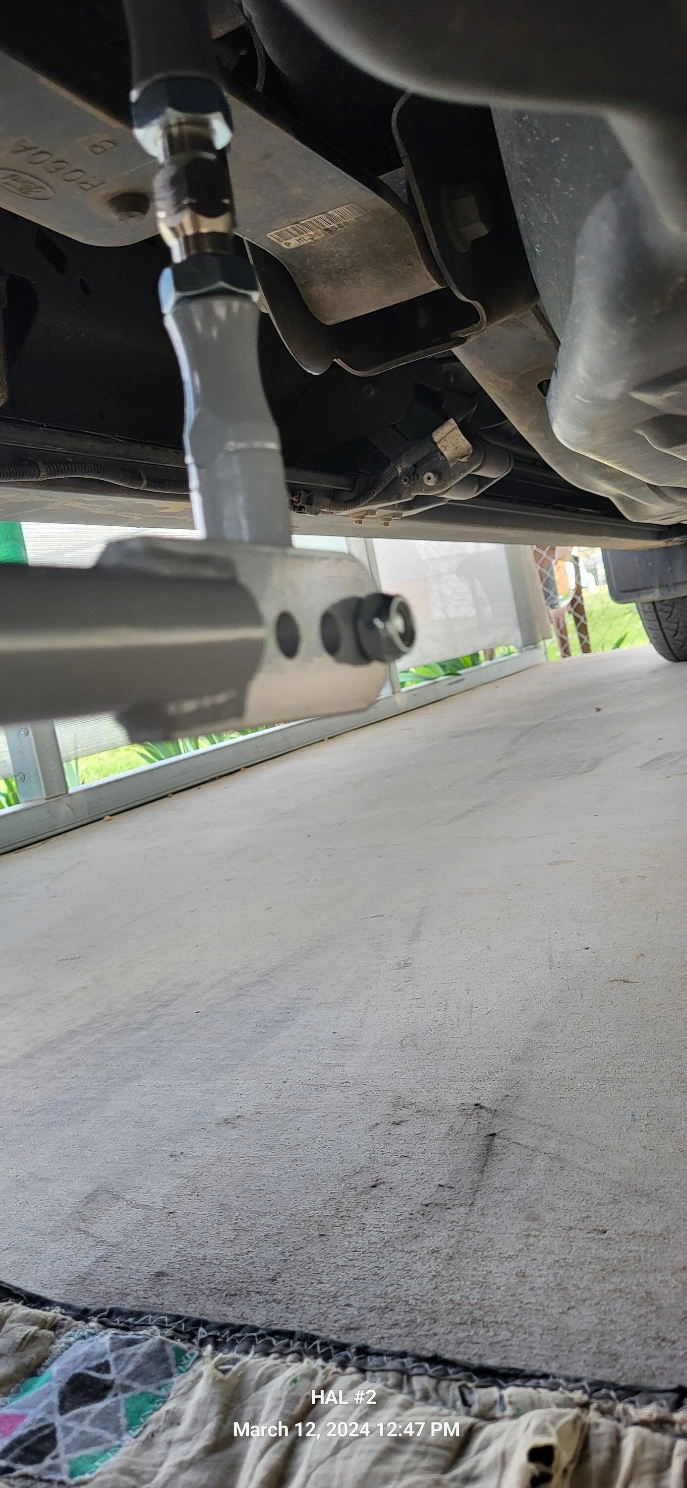

i used a floor jack to hold the bar up after i loosely attached the front of the bar to the front struts and it made it very easy to hang the u-bolts and get the bar set to a good position on the axle
i also moved the wire harness we had the recall on, UP and clamped it in place above axle with a cushion clamp
no need to move any brake lines on passenger or driver side of axle. yours might be different .

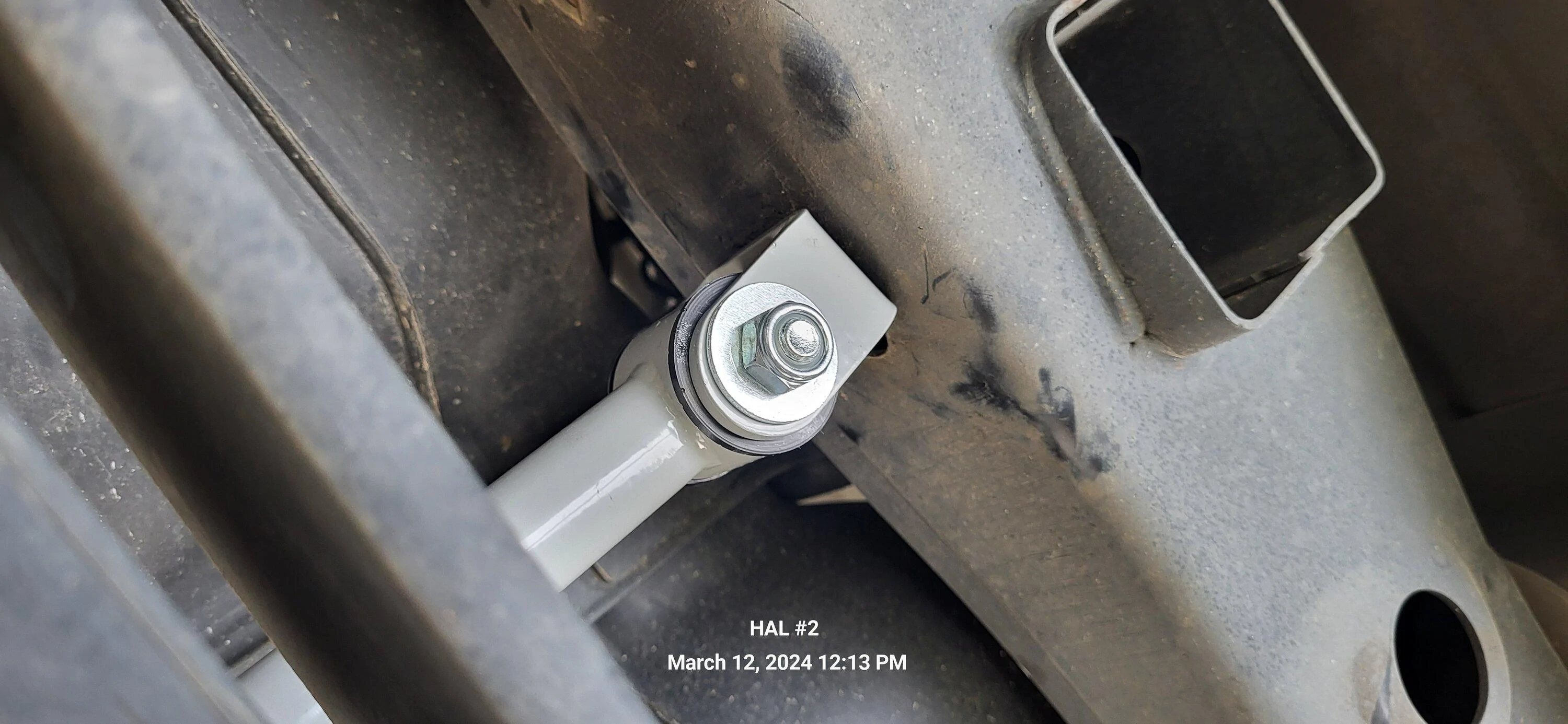

my biggest issue is the hardware included;
the lower strut hardware used to attach the forward end of the bar to the strut is to short, the instructions have you use the nut as the washer and nut. which is wrong from every thing MECHANIC. I am an aircraft mechanic and we never ever use the nut without a washer.
so i used aircraft bolts for the lower strut to the bar attachment point and of course a washer under the nut.
i was also missing the 4 washers and nuts for the U -bolts and steeda is sending them out. I used self locking friction nuts and washer in the interim. If the steeda nuts are superior, i will swap them out when i do the torque checks after a few miles
Steeda was very positive about sending out the missing hardware. great interaction with them.
In my opinion the nuts being absent from the hardware bag is UN-acceptable. Given that somebody signed off on the packing sheet to indicate all the parts were included, it sort of tweaked me, then add in the 600 dollar cost, no excuse for missing hardware.
On a positive note, they included extra slick stuff for the bushings, in fact, enough to lube them 3 times. so if they start squeaking, i have lube for the bushings.
i posted up some pictures and will follow up after a good drive and torque checks.
one other note: the passenger side strut is about 1 inch from the factory muffler, so i see a new exhaust in the future.
the struts are also bottomed out in the short adjustment , which leaves the nose of the sway bar pointed down about 1 degree but it levels once PEOPLE are in the truck. I kept the bar at attach point on axle, in line with the axle tube. It may need to be moved slightly aft to push the front of bar nose up by 1 degree
I also parked in my bar ditch so passenger rear tire was fully extended and driver rear was compressed.
To see if wheel lost any travel. Seemed same as before

My 2006 tow boss dually had one from the mother 'ship
I am eager to go put some spirited miles on the country road to see how much it changed tye handling
powerboatr

took a spirited drive this afternoon on one of may curving farm roads that have a speed limit of 70.
very noticeable ride difference in the long curves and short somewhat sharp ones.
did a re-torque on all the hardware, we are good.
sprayed the exposed u bolts with some fluid film until i get time to pressure wash and put good black preservative paint on the shiny parts
i may paint the steeda stuff black to match the frame, but have not fully decided on this yet

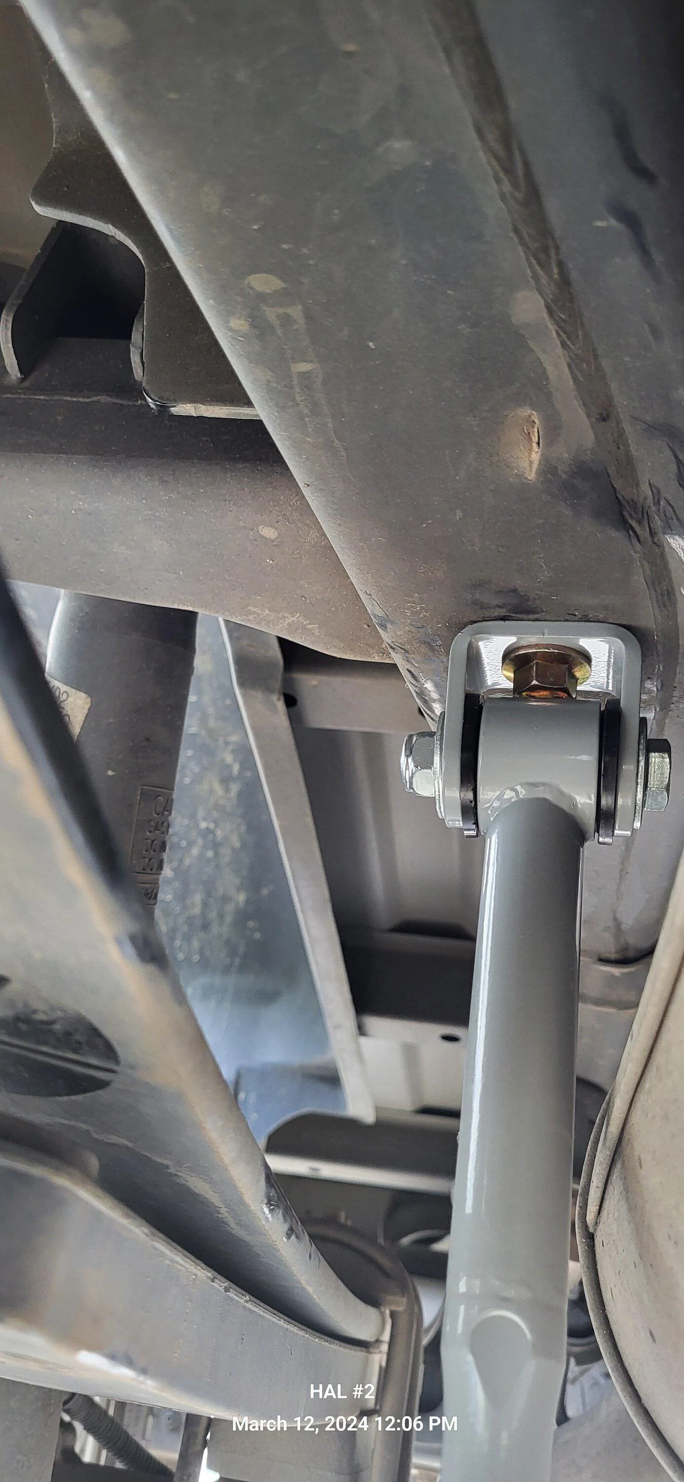

Nice write up! I installed the same one last year. Mine has the slight forward pitch as yours due the the end links being too long. I have mine in the middle adjustment position. I'm hoping that once the weather gets better I can switch it to the rear most position and get rid of that forward cant.
powerboatr
powerboatr
May 9, 2022
4,343
5,427
North East Texas, Piney Woods
2024 F250 King Ranch Chrome
Retired Navy Senior Chief
very good to know. it seems to be the theme on the 4wd truck kits with the bar being down a degree or two
i did mange to move it nose up a degree or two, but that pushed the bar where it was not square in line with the axle tube center.. so i moved it back to center
i also tried moving it to the rear of the axle and off square with axle tube center, it tilted slightly up, but then the bar is off the center line. not sure if it would matter or not?
it back to center now.
i was curious as to what effects would be if i used the second hole or the rear hole in the bar on keeping bar parallel with ground
it seems to me a more nose up attitude of 3 degrees would be better if your off road and the bar hits something it would go up and over vice dig in
i even moved the struts as far to the rear as i could in the frame mount hole (oblong) and it made a slight change , almost perfect.
I also measured and think the bar could be mounted to the top of the axle and then fabricate some much shorter struts. this would keep every thing up out of the way..
but the spare would need to be removed and a few wire harness re-routed or tied back
its doable. but links would need to be 3 to 4 inches

Yours looks better than mine. I also was unsure about the effects of pushing the entire assembly forward to get rid of the tilt so I didn't move it. Maybe someone smarter than I could explain the geometry in a way I could comprehend. ?
powerboatr
powerboatr
May 9, 2022
4,343
5,427
yes sir....me to
i passed geometry, but the variables are more than my old brain can compute right now
When I get the topper back and a ll my stuff pit in bed,I will see if I need to move bar rearward on axle to get a slight nose up on the bar.
I found 2 people in front seats . Didn't move rear suspension enough to notice. But did compress front a little

Man , Looks really Nice .. Id like to put one on my 21 but from the pics theres too much hanging down to be a problem when your off road a lot . It would definitely be a problem off roading , not on gravel or dirt roads .. I’m talking rough stuff that your doing less than 5 mph .. crawling over big rocks and tree stumps .. Probably why you dont see them on 4x4s from the factory .. But I’m betting they help the rear end handle better cus these trucks get sloppy in the rear real quick .. I’ve got Fox 2.0‘s on all four corners and they help a ton but not as much as I’d like … Swaybar woulda been nice but not hanging down that much … Thanks for the pics cus I was about to buy one till I saw those links hanging down so far …
powerboatr
powerboatr
May 9, 2022
4,343
5,427
this picture has me pretty convinced i can rotate the ubolt and holder aft and up a bit to pull the bar back and lift the nose of the bar
there is a good bit of room and i am not sure now why the bar has to be dead center of the axle tube.
those bracket has an easy 1 inch that could be rotated towards the rear

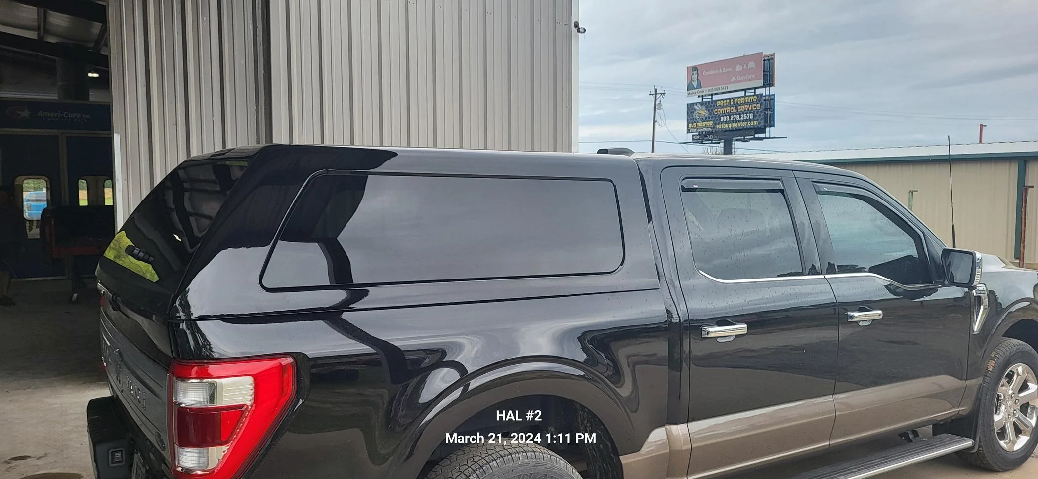

Got topper back this afternoon
Now I can get the final adjustments done this weekend to account for the few hundred added pounds out back
Monday I had to do long road trip
On some pretty uneven County roads.
So far a huge plus in ride quality
