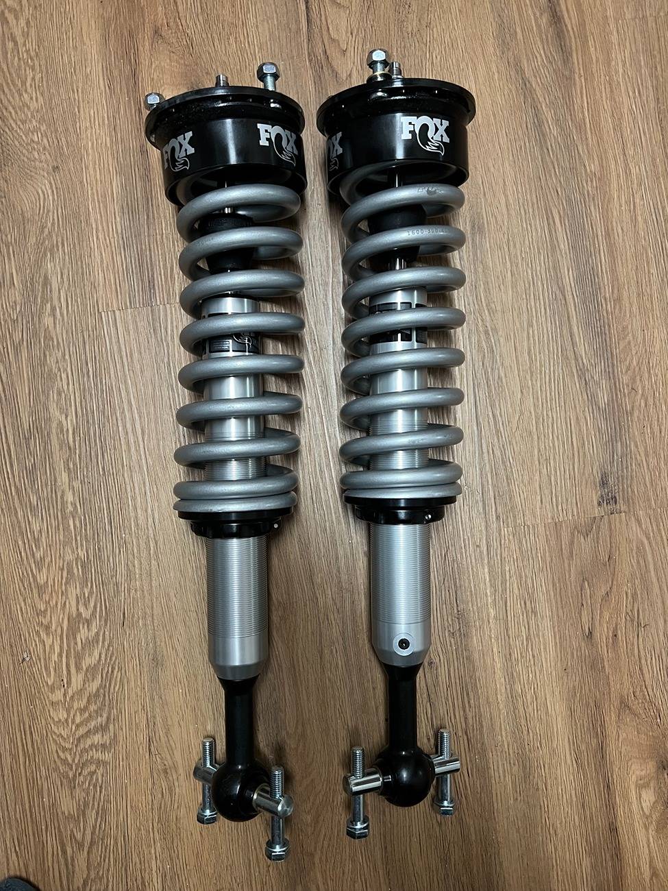

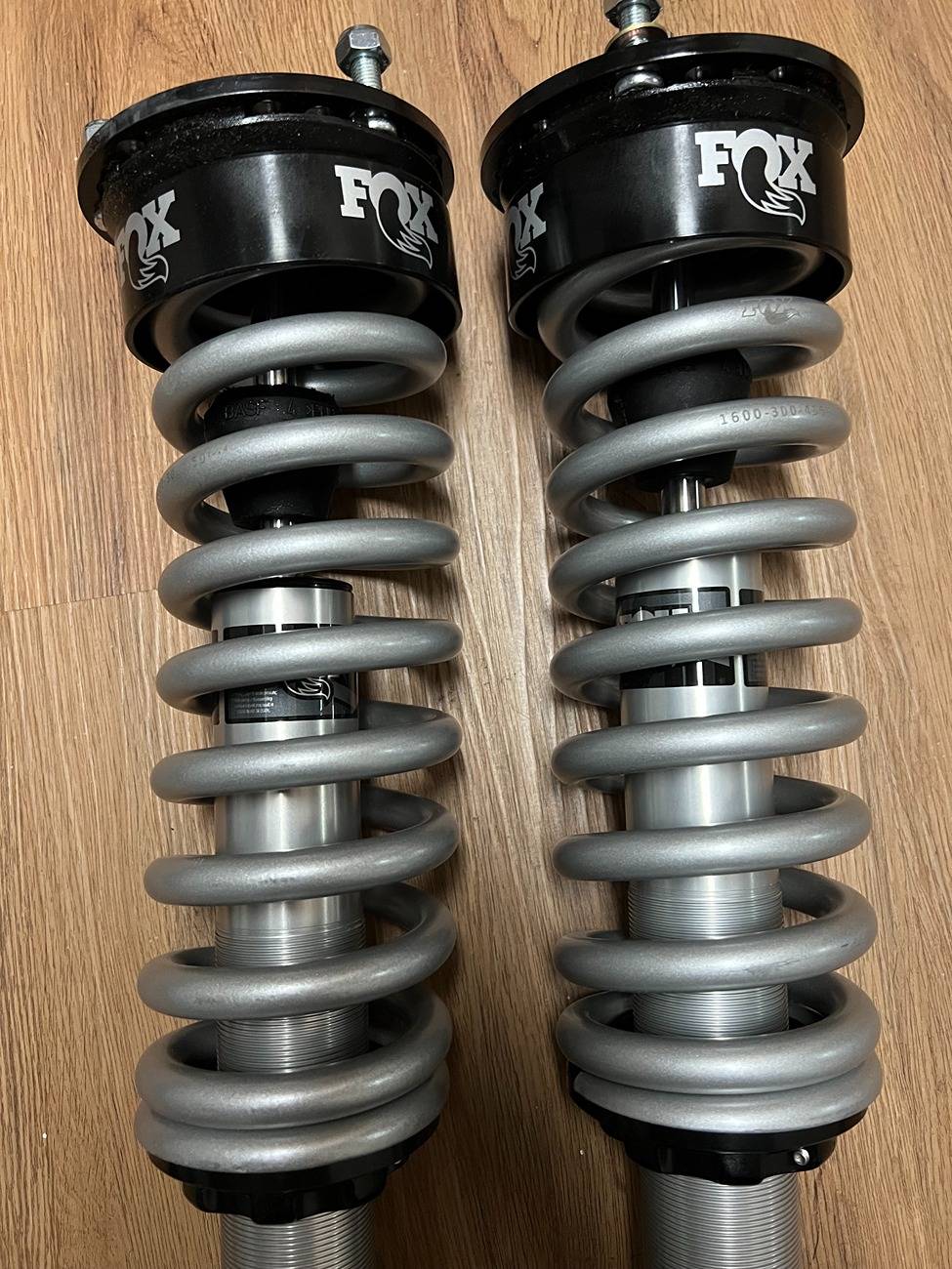

I have a similar noise coming from my front passenger side after installing a Fox 2.0 kit on my 21 Lariat. I think mine is due to a poorly assembled coilover from the factory. The shocks inside the coilovers I received were way off-center inside of the spring and the top hat looked super crooked. I reached out to the company I bought them from and they told me this was normal and that they would settle and straighten out once under the weight of the truck. After taking their word and installing them the drivers side looks ok now but the passenger side is still way off and is now making a similar noise. They did send me another set of coilovers and this time one looks ok while the other is even worse than the first two. This weekend I'm going to replace the squeaking one with the one good one I received in the second shipment and I'm hoping I'll be good to go after that.
MADE IN THE U.S.A. they said ...... ?
FK that noise, man! Tell them to shove that piece of crappy QC Boo-Sheet for some other dummy. :poop:
