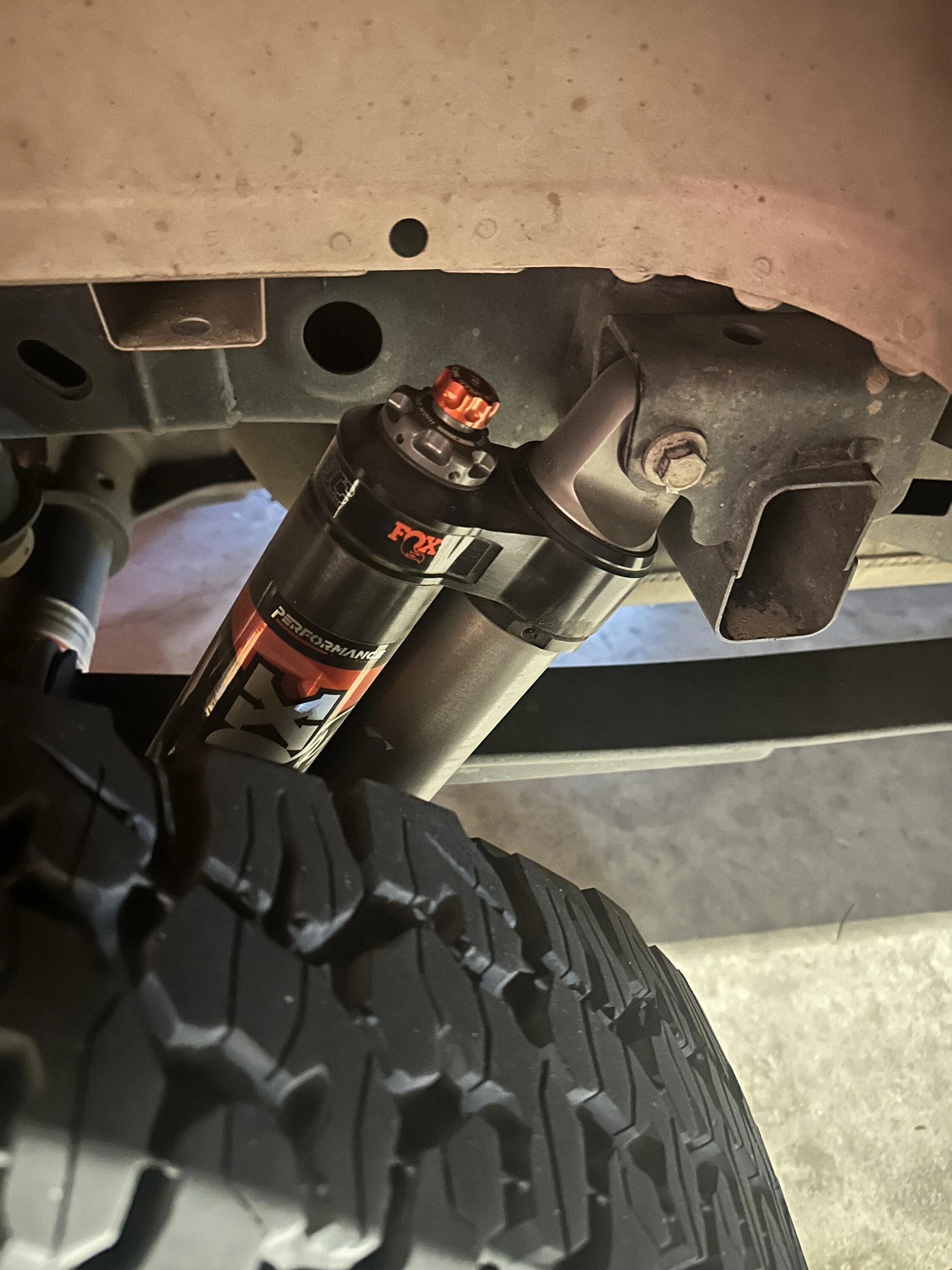

Yes, I have mine adjusted as low as possible on my 24” lariat with the 5.0 and still lifted it over 2” in the front but since then they have settled down around a half inch but still have a good 2” inches of lift. Show me a pic of where the top adjustment collar meets the shock body so I can see if there is anymore adjustment if possible. I run the high speed setting fully open on all 4 shocks and low speed are 4 clicks in on the front and all the way open on the rear. This is what works for me.
here are mine.

Get a pic of the very top of the coilover so I can see if you have anymore room for adjustment. Like above the black top ring/collar. I can’t quite see the top of the coilover on that top pic you took.

Your pretty much topped out maybe one more turn of the collar but even with that it’s only gonna make about an 1/8” of an inch difference. After about 1k miles or so mine settled down about a half inch and also smoothed out a bit more so I’m sure yours will do the same. Also if you’re unhappy with the rake you can always install a 2.5” inch rear block like I did, I only had about a half inch of rake after the coilover install and 1.75” with the bigger blocks looks awesome.
