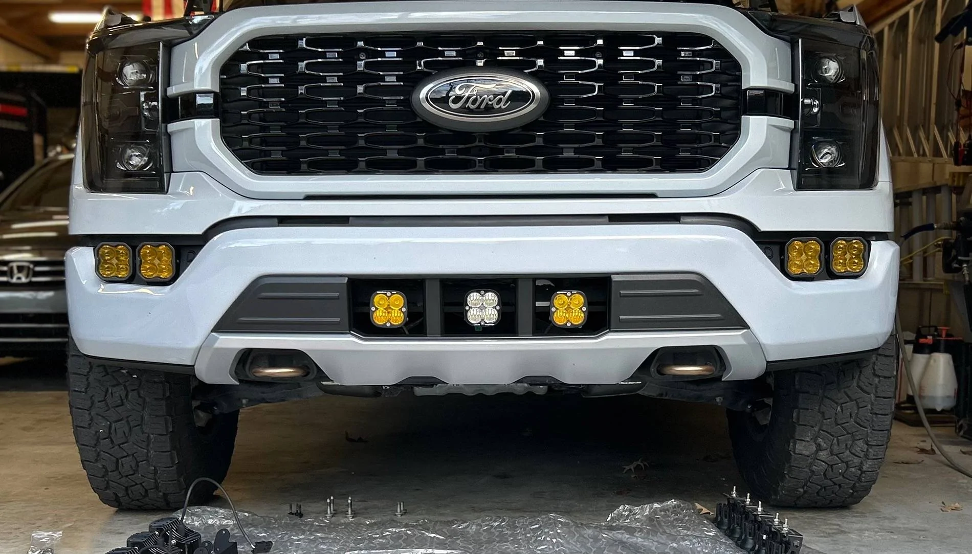

Since I was having to replace my bumper why not upgrade fogs since the bumpers off!
Overall very easy install, since I had to remove the entire bumper to replace it. If you were doing this just to upgrade your fog lights it is a hell of a lot of work but very worth it.
Install: 10/10
Fit and finish: 8/10
Output: 12/10

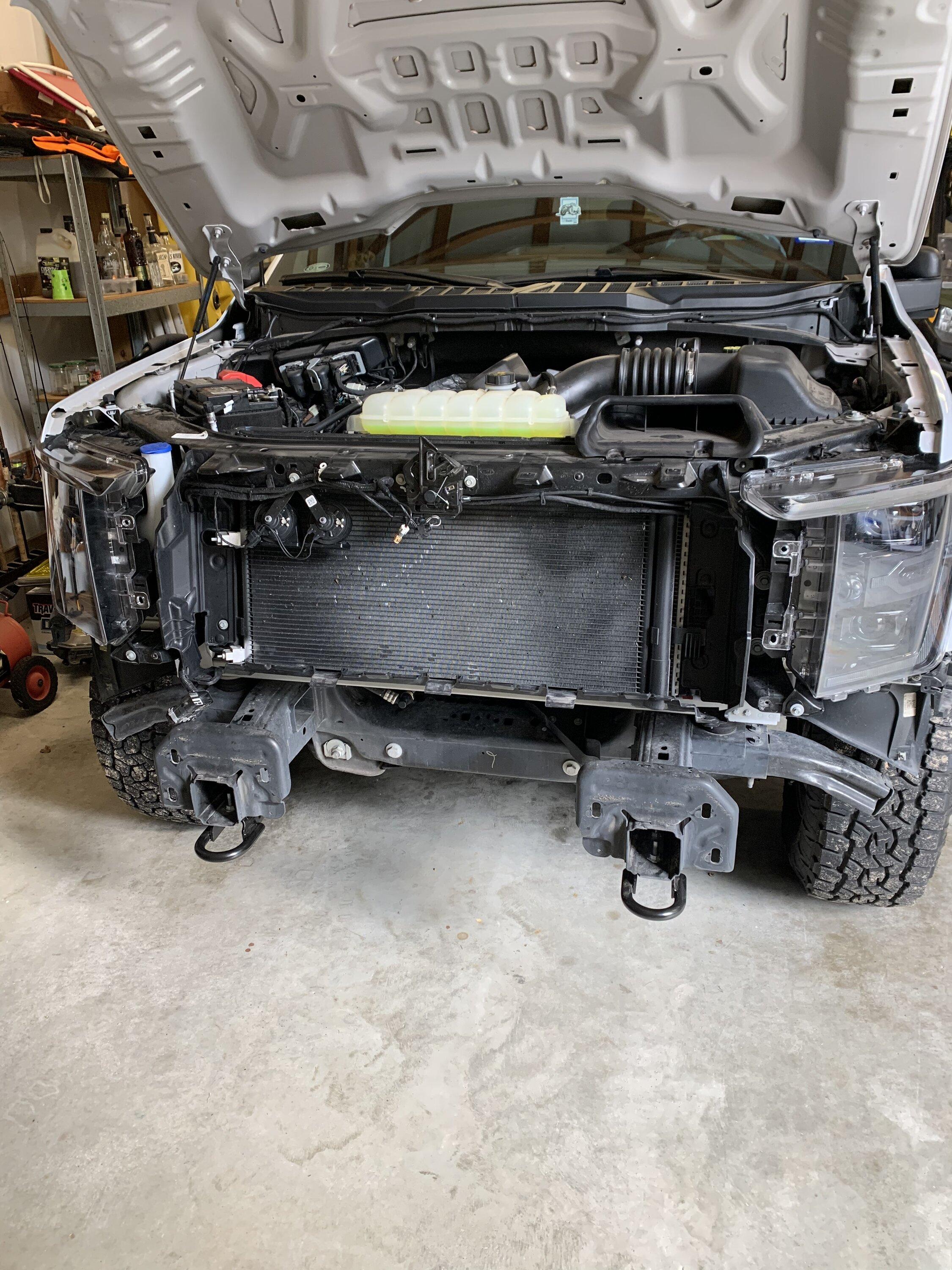

Before installing
You have to remove the entire front end just to replace fog lights, c’mon. Very simple must of us have already done this before!

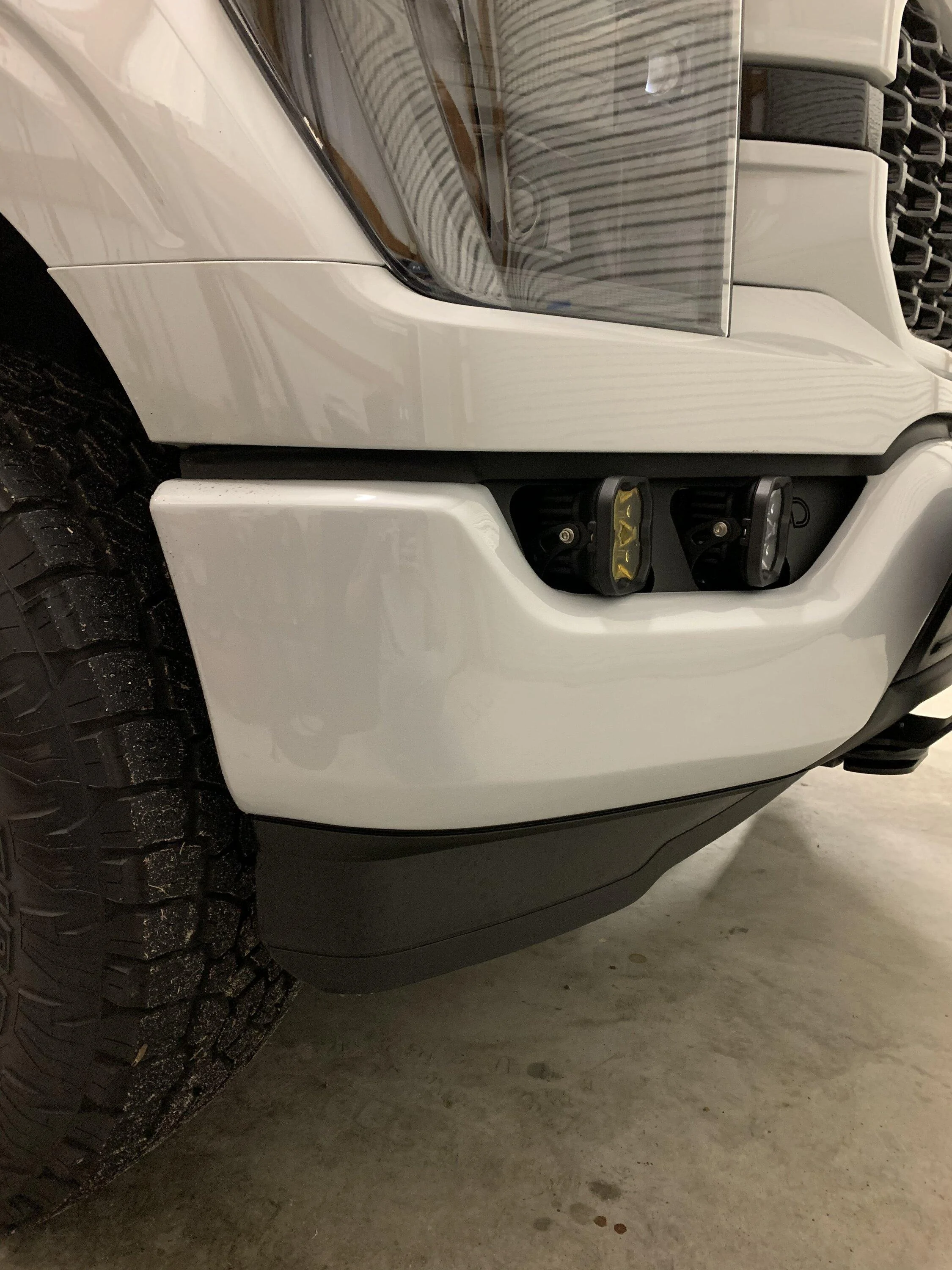

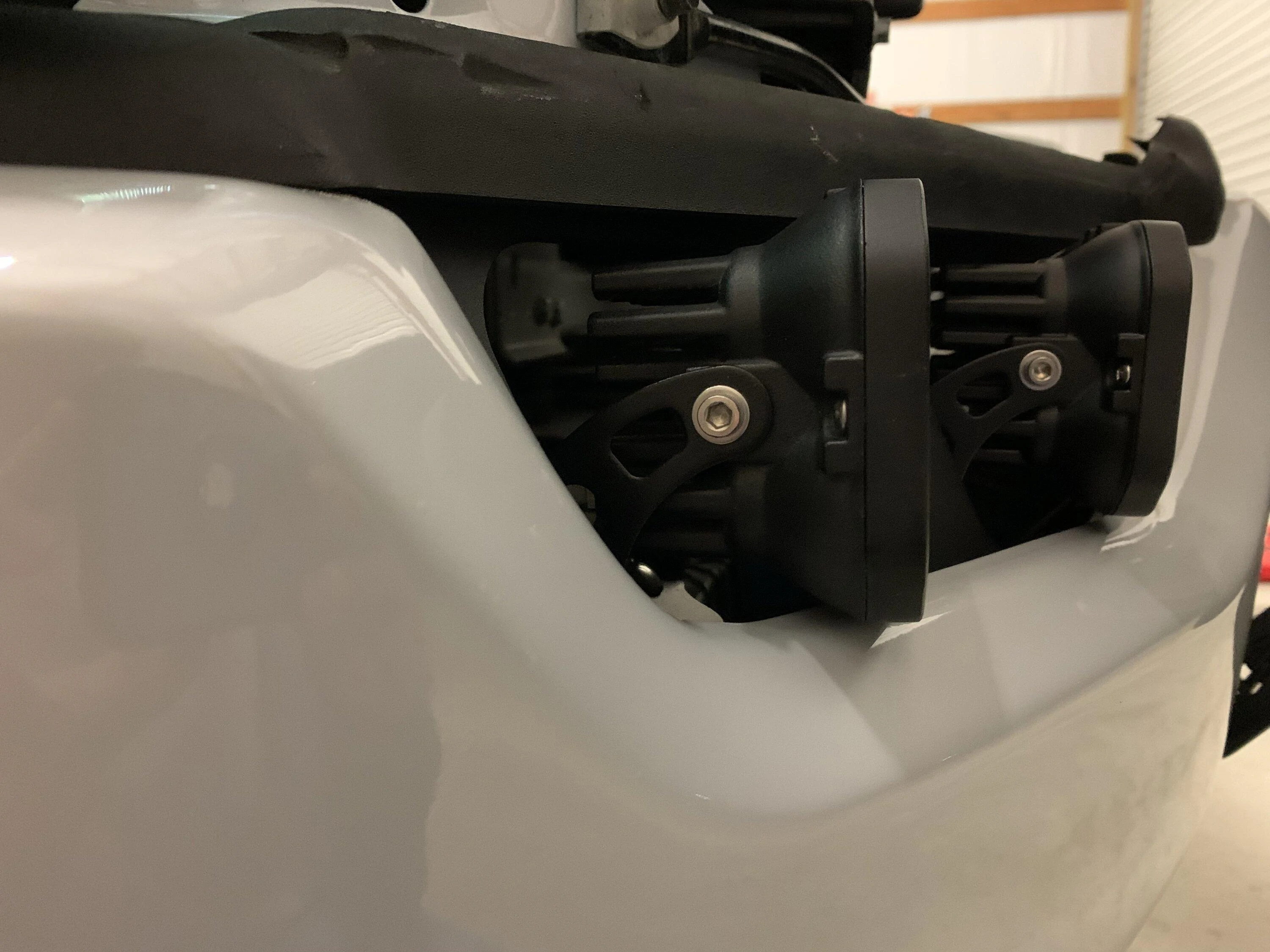

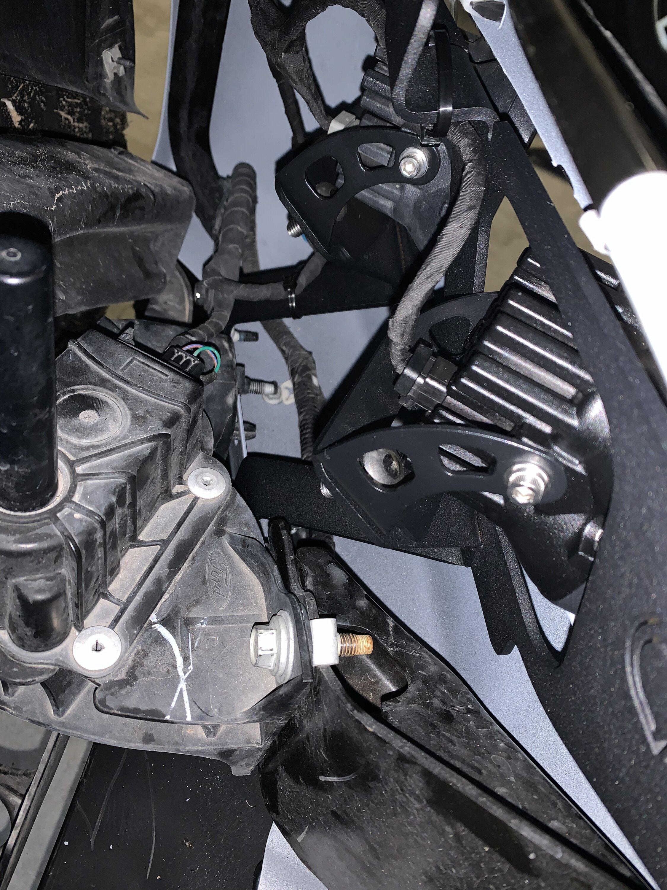

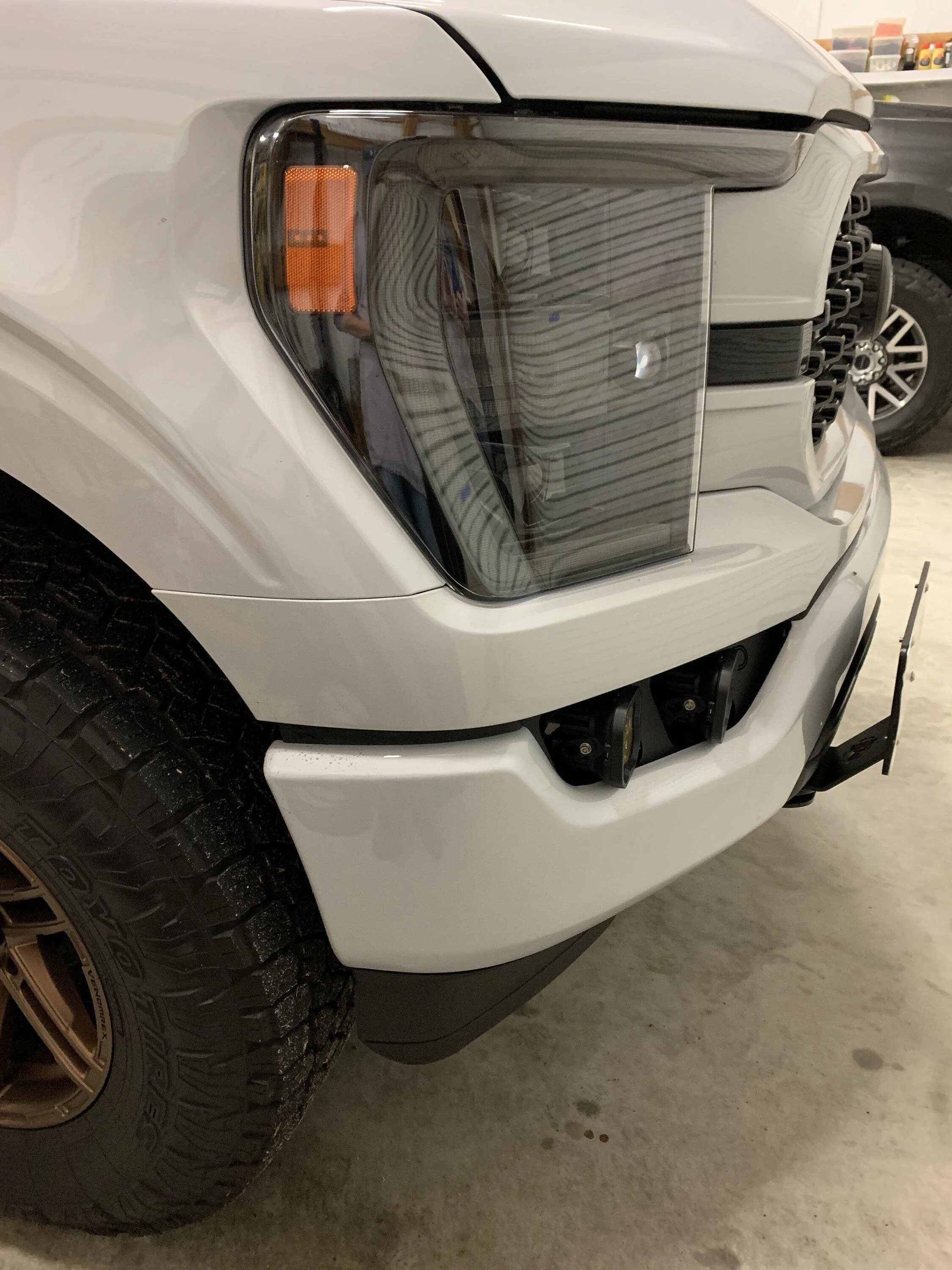

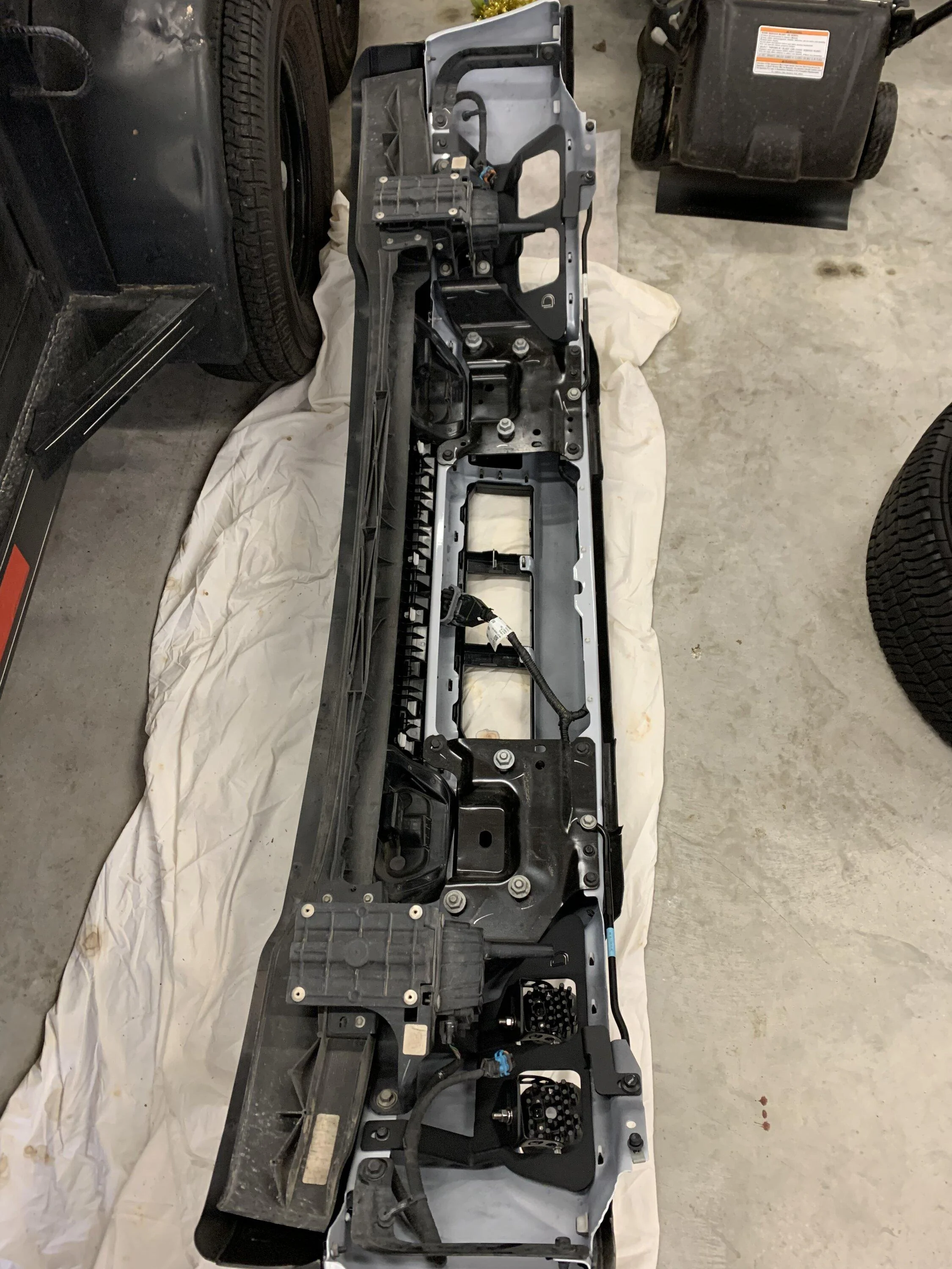

Installing the DD brackets
You have to remove the air dam if your truck is equipped, six bolts. Mounting is very simple the same bolts used to secure the factory lamp are reused for the bracket. It just uses two less screws.

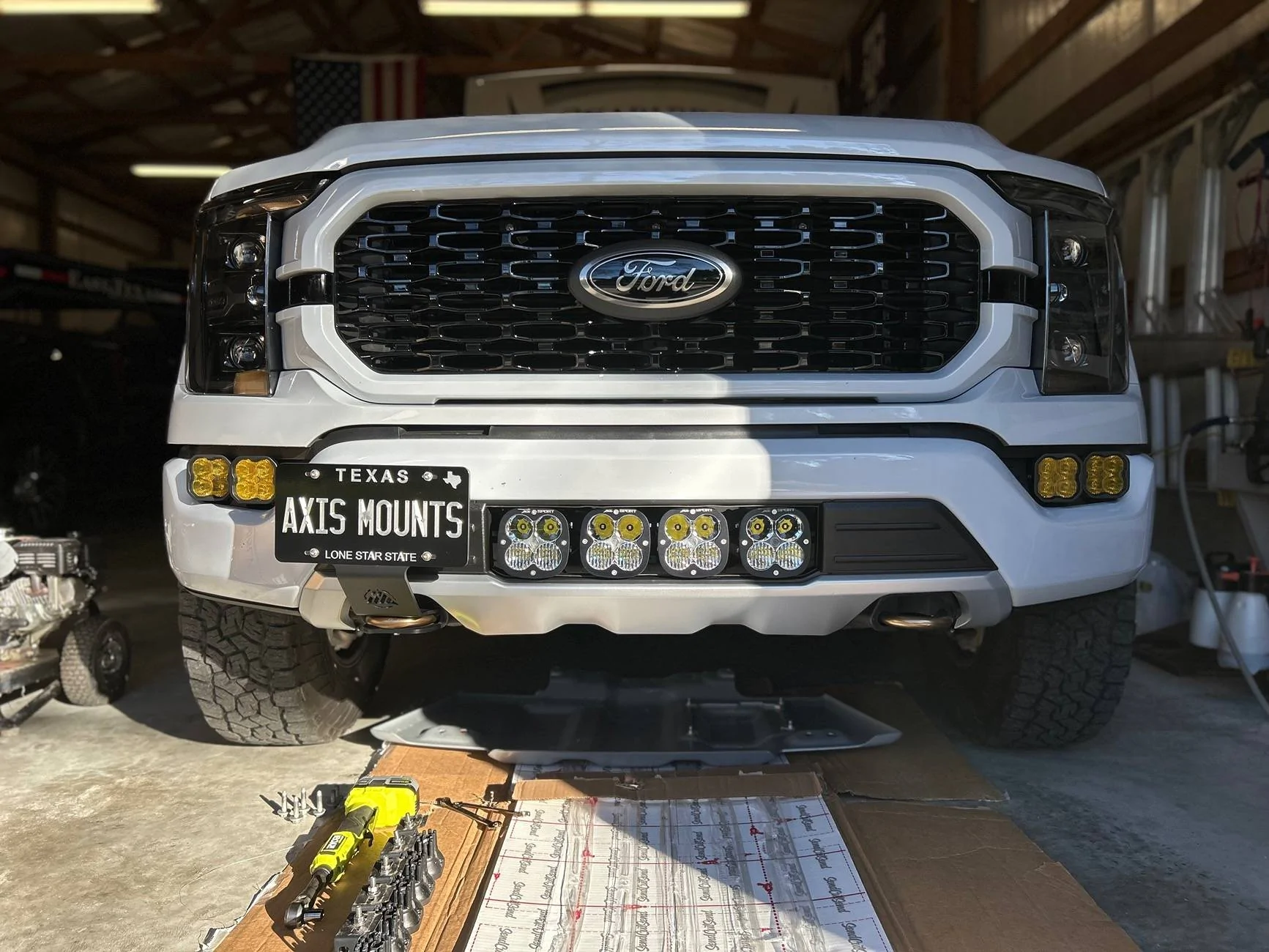

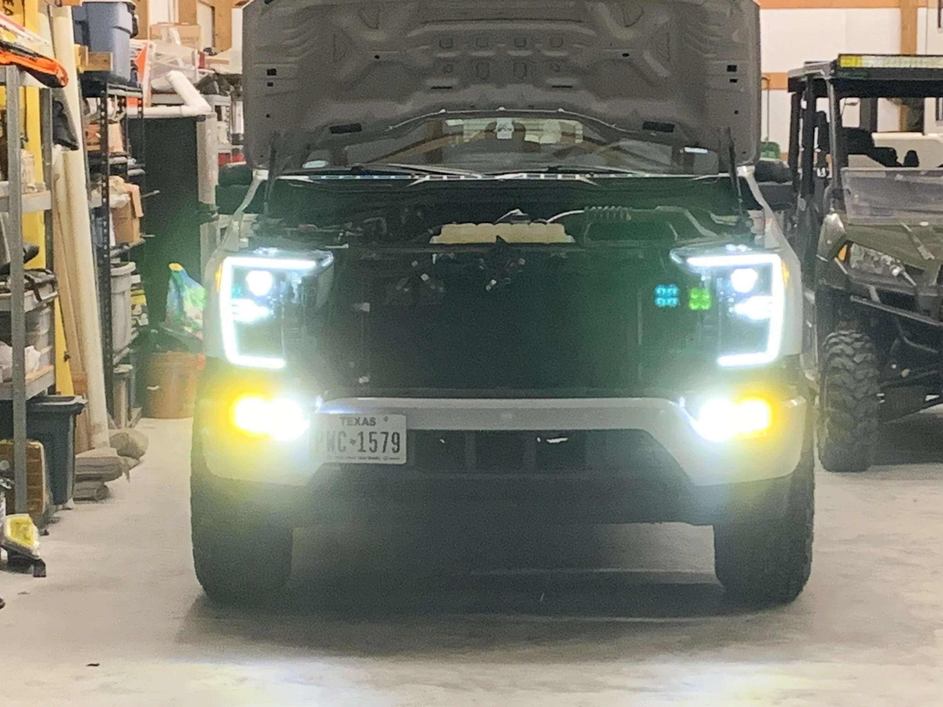

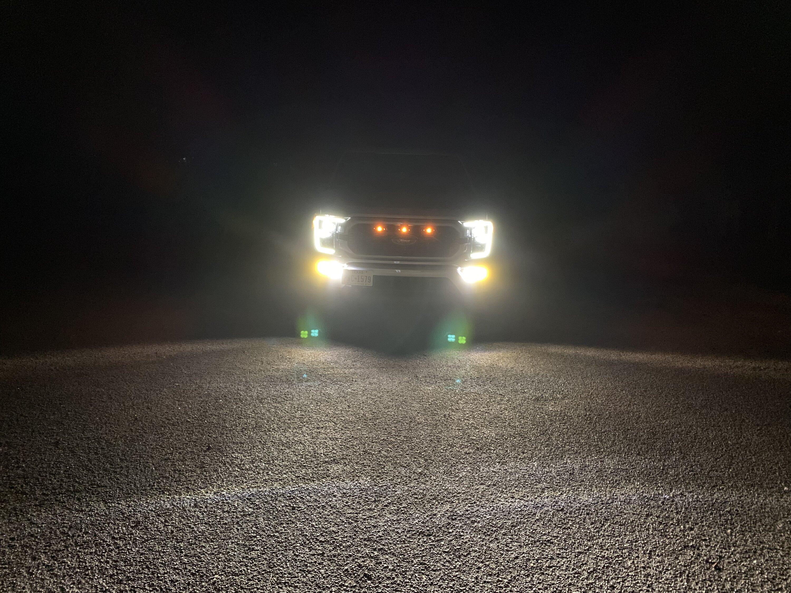

I decided to wire the pods together and run the lights off the factory switch. I used white pros on the inner opening and selective yellow sports on the outer opening.
custom h10 to dual duetsch to power the lights

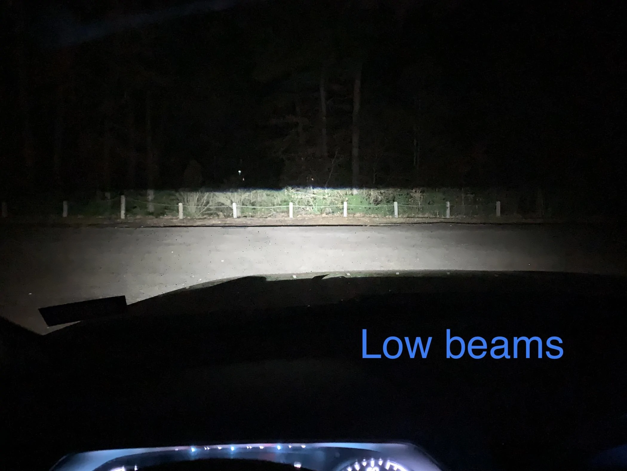

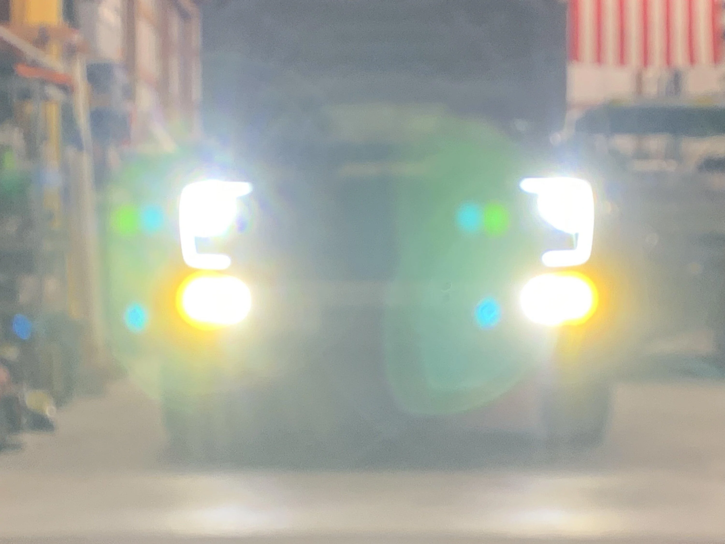

I tested to make sure everything was working and then spent time aligning the pods. The light projection from the pods is so precise it is amazing. I put the pro whites the lowest and then put the selective yellow slightly higher.
I will definitely play with the alignment in the future but after the first night drive I’m very happy.

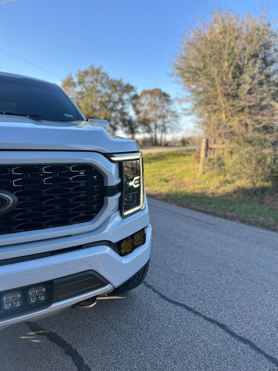

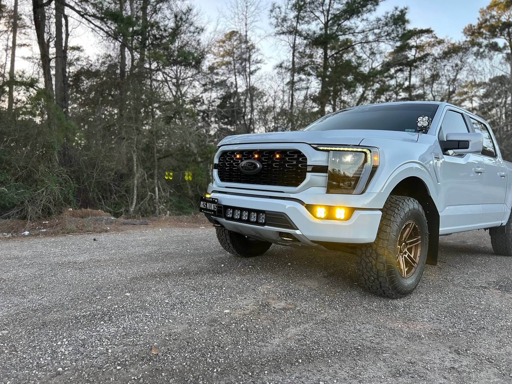

Final Results

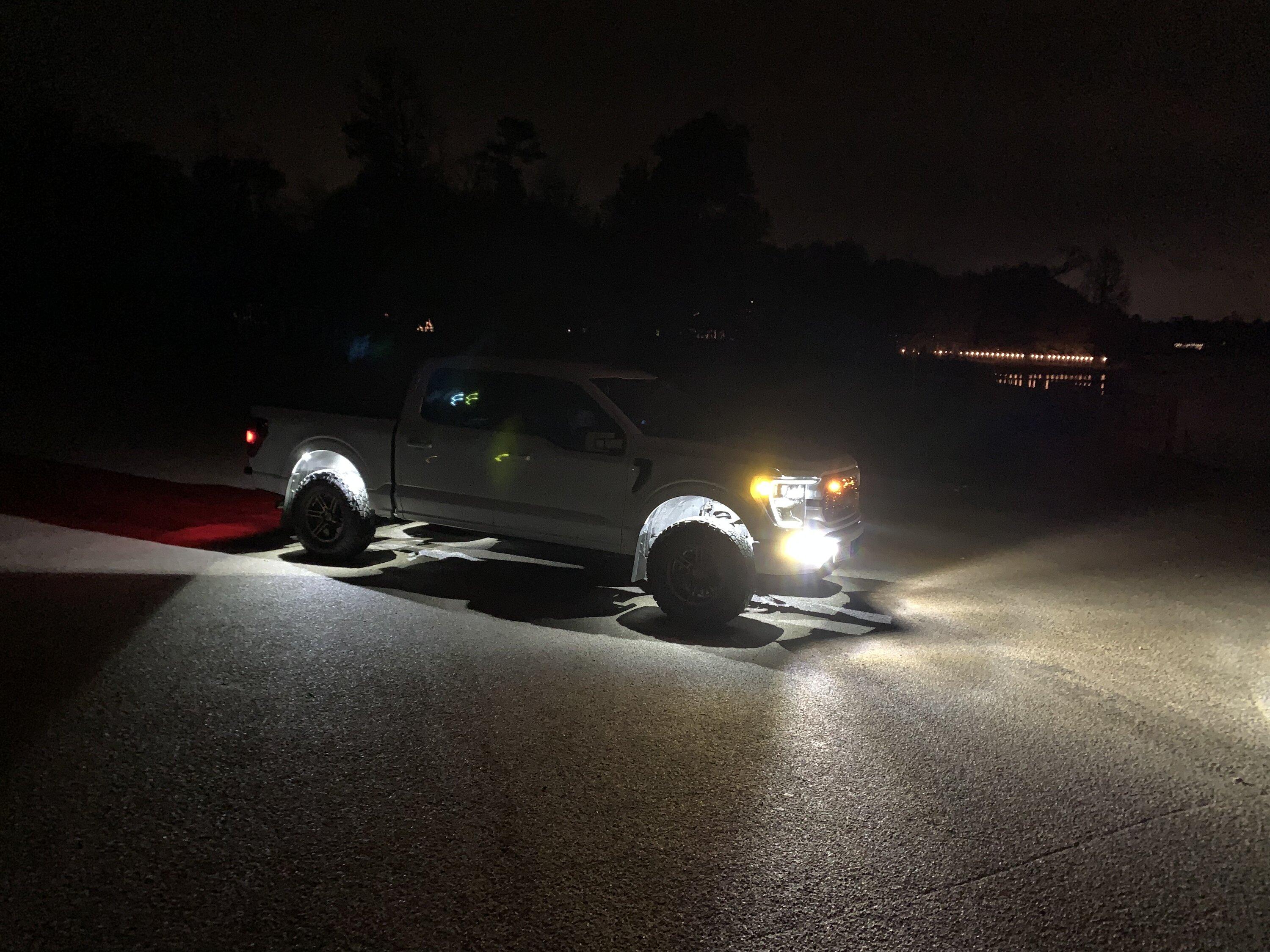

Output
Now I just need to enable Bambi mode!
