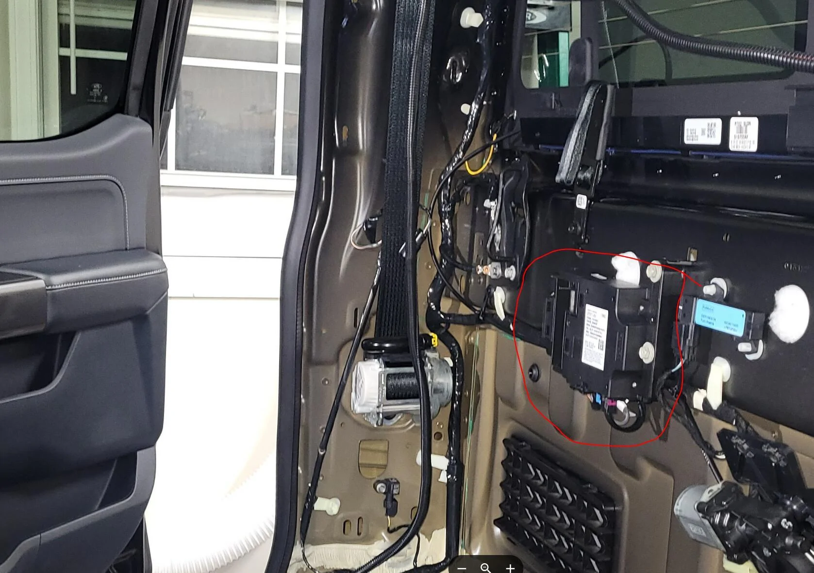

One option is to bypass the issue with a cell phone range booster with the antenna mounted outside the cab. Not the cheapest option, but you get a decent added benefit in addition to completely bypassing this problem.
Issue is unrelated to what you installed on walls, doors, etc... There's likely an aluminum foil layer in it for holding it all together and the truck is also aluminum. Now if they covered up / encapsulated the TCU, that could be an issue. Unclear where exactly the phone-to-APIM wireless connection takes place / wifi hotspot signal. I believe it's in the APIM itself so unless you've foiled over all of the dash/console parts, it shouldn't be related.
Running a signal meter on the phone may be able to help you diagnose a little bit as the wireless carplay / AA has a beacon and the wifi hotspot has another. Make sure they're not sitting on top of each other (frequency wise, you can change hotspot to 2.4ghz if they are -- wireless AA/caplay is one wifi radio, the hotspot another). While data comes via wifi, the phone to truck music / calls comes over bluetooth. If nothing was done in the dash, make sure the TCU on the back wall hasn't been covered over.
This is the TCU
