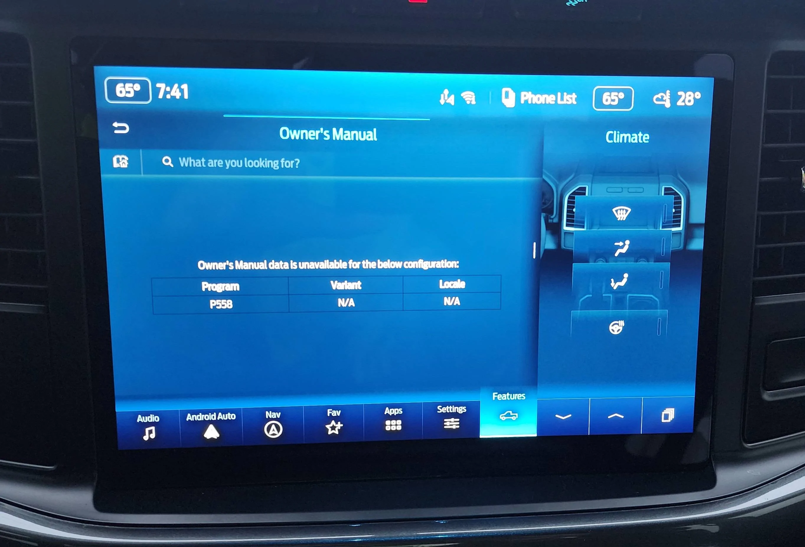

I have a 23 XLT and wanted to see what was required for my upcoming 20,000 mile service. I went to check the owners manual through the features tab on the touch screen and get a message that says owners manual unavailable.
I'm going to talk to the dealer about it but was curious if anyone else had this issue and had it fixed.

You have the wrong vehicle program setup on your APIM. assuming you did some Forscan changes? Your showing program P558.

I have made a few. The forscan spread sheet is showing 7D0-03-02 **xx-xxxx-xx-- as vehicle type, my as built file has 10 which is V P558. It should be B for V P702 correct?

Correct. Assuming it was changed for the climate Side card?
You are correct! I forgot about having to change that to have the climate side card with the soft button for the heated steering wheel.
Thank you for your help, I'll close this question.
