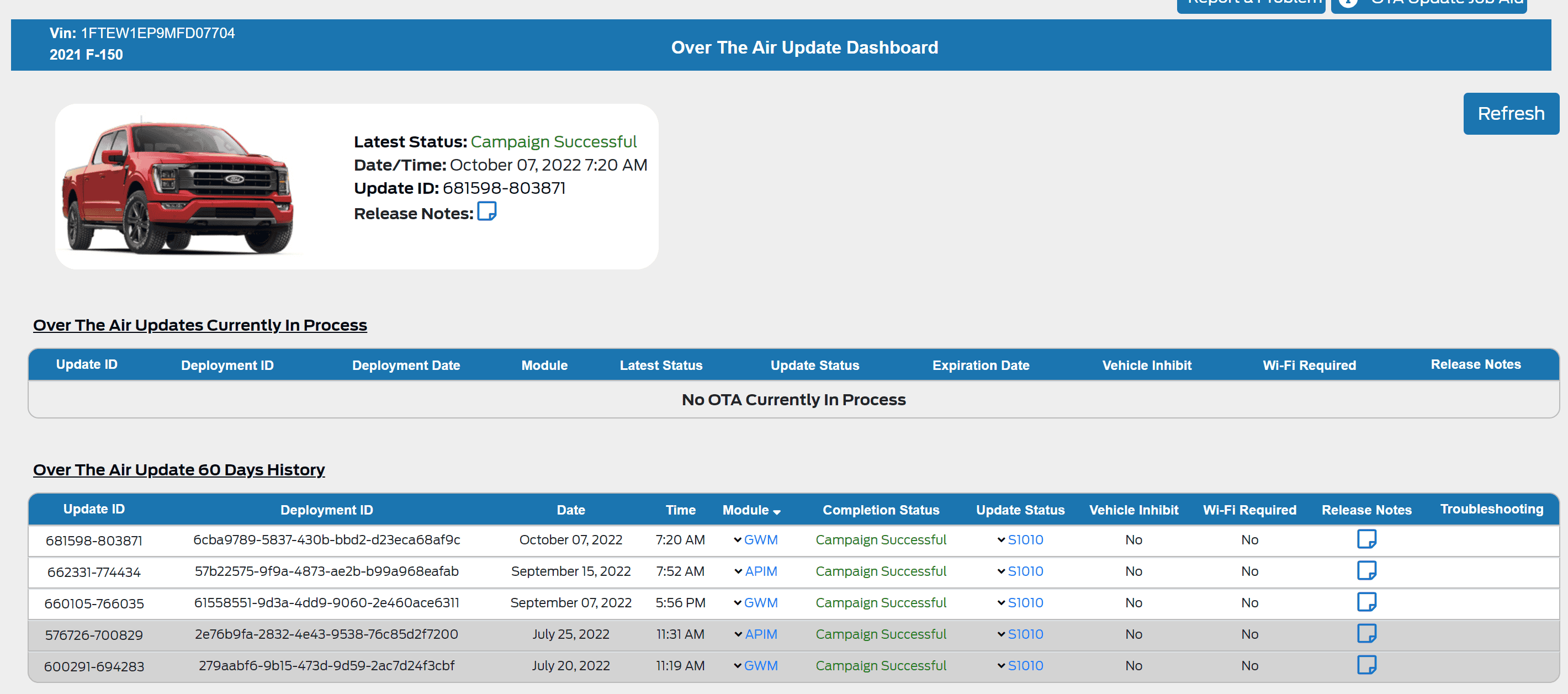

Hi Jesse,I wonder if you can help me find out if my truck was given the tsb22-2224 update,still runs like crap,thanks,Vin1FTEW1EP9MFD07704
You have actually received several updates and the last was the gateway unification to 2022. The APIM update should be coming your way soon
