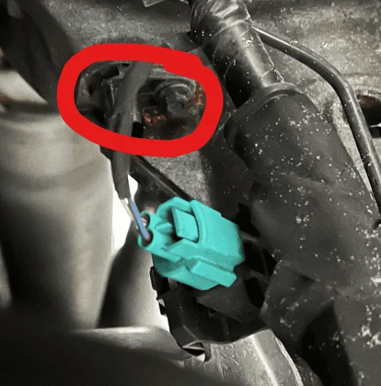

I noticed a small green male electrical connector near my rear diff that was not connected and was just dangling. I found a female connection attached to the top of my rear diff that the plug fit perfect, so I plugged it back in.
What is that connector for? I suspect I've been driving for some time with it disconnected. I don't go off road, so have only put the vehicle in FWD on very limited occasion and didn't notice any ill effects that I was aware of.

I would think it is th connection for the diff lock..

I would guess that sensor is either the diff lock or a temp sensor.

You plugged the connector into the holder meant for non-locking trucks. The plug should go to the diff lock connector here:
