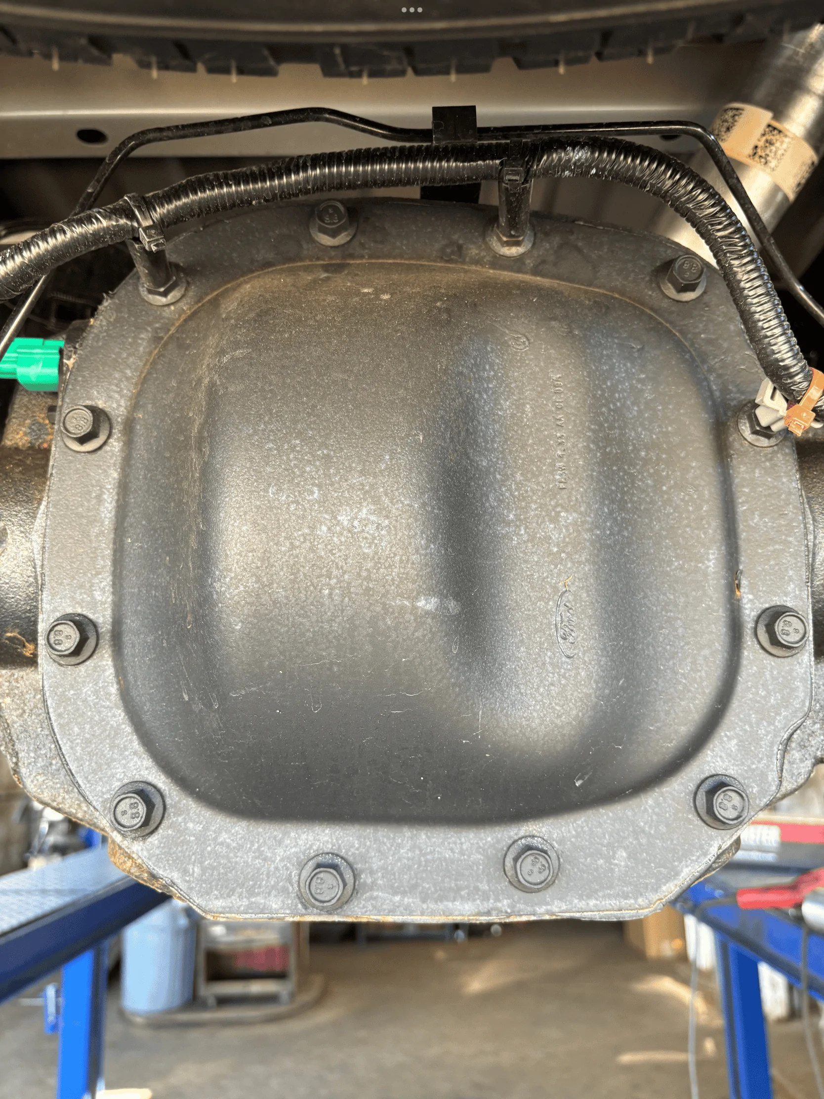

What rear end is this?
Lobostang77
Mando
Feb 14, 2024
2023 F-150 Platinum
I’m just trying to make sure this is the 9.75. I bought 4.56 gears for my previous truck but never installed them. I got the reverse 8.8 fronts as well.

That's a Super 8.8" differential, not to be confused with the previously used 8.8" differential.
Darn it. Is the front still a reverse 8.8 you think? Now I have to buy just the rear correct?
The front axle is still a reverse 8.8" so everything you bought for the front should work.
That is an 8.8 but that has nothing to do with those bolts. :) that is just a happy coincidence. Also the 8.8 is an awesome axle and has 34 splines in our truck. The 8.8 is an ISO 898-1 strength rating for the bolt, nothing to do with the 8.8 ring gear in Ford axles.

The 9.75 has an assymetric shape looking at it from the same angle this photo was taken.

I’m building a Sport/Street truck so I’m using the gears for off the line fun. But thanks for clarifying even more. Now I have to order the rears again. My truck does come with the e locker.
