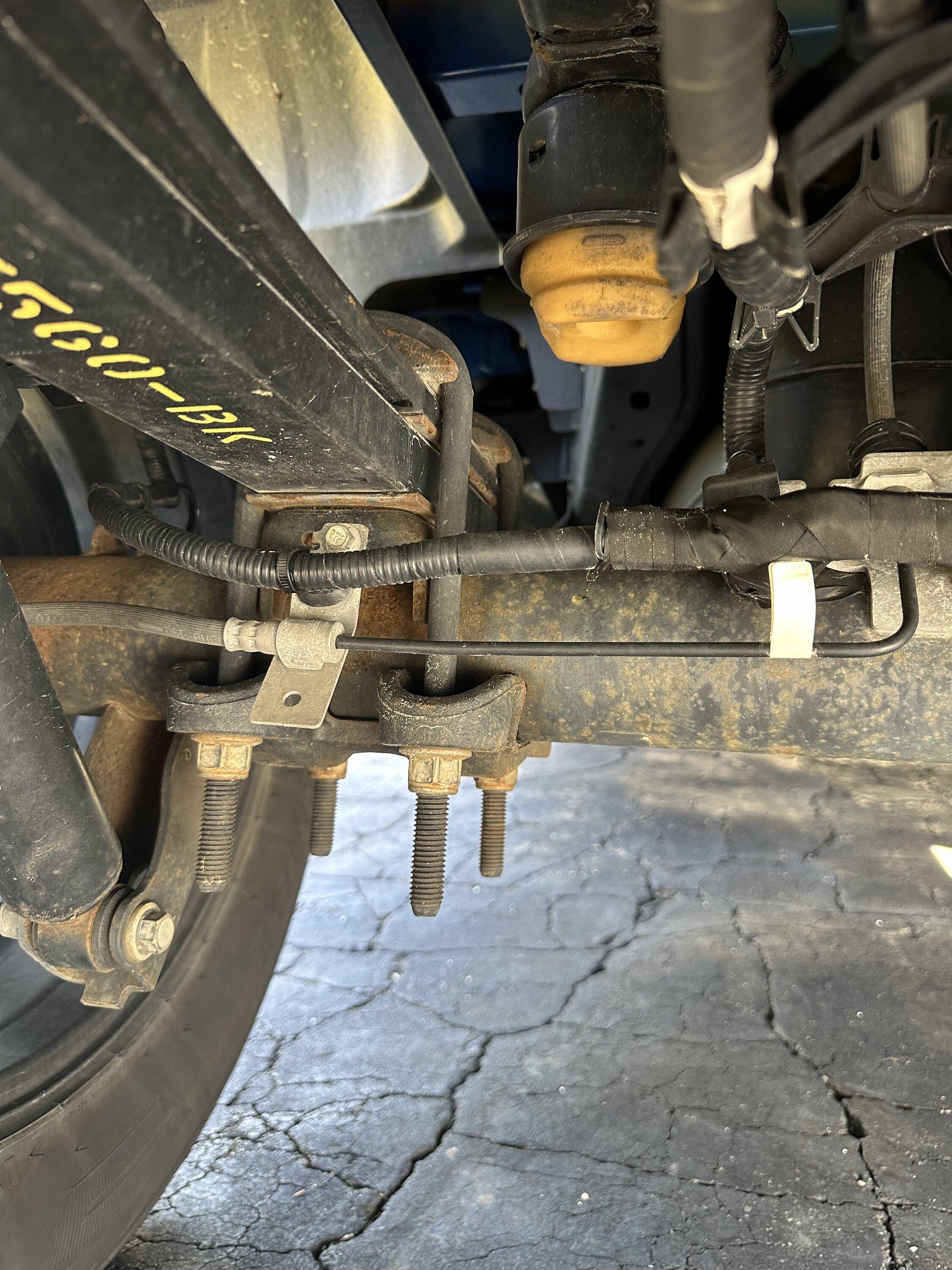

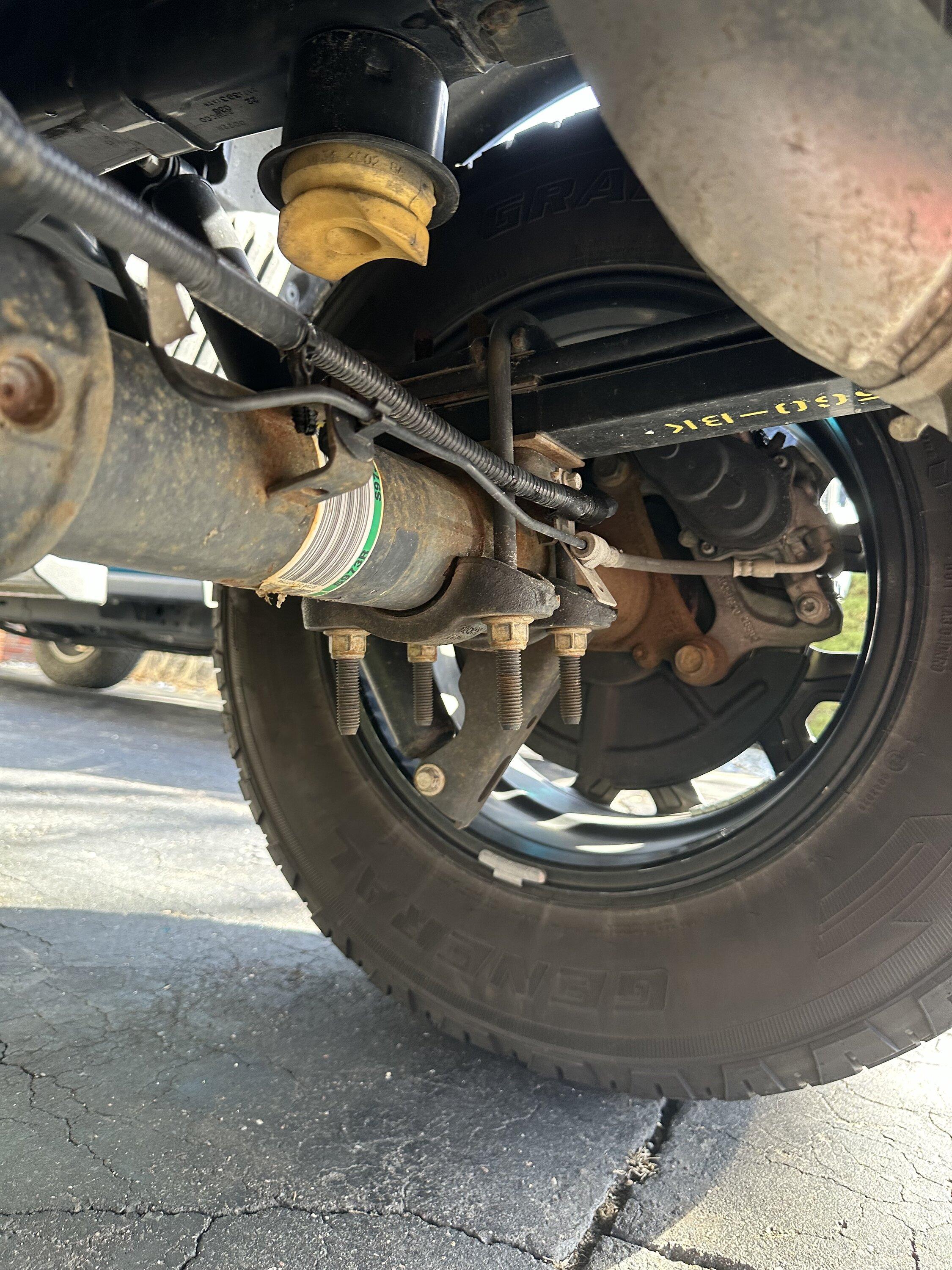

Hey Everyone,
in the near future I am looking to add the ford performance leveling kit. I purchased my truck as a CPO and it was lowered when I first looked at it, before purchase I had the dealership return it to stock height (so they say). I know they replaced the shackles for the standard height ones, but I’m wondering if I should also have the spacer blocks? To complicate things they truck has the snow plow prep package (which I never intend to use)
I just want to make sure when I level the truck I don’t have a reverse squat when setting to the 2.5 level setting.

Yes they are gone as confirmed by the extra long exposed U-bolts.
There should not be that much U-bolts hanging down.
Don't have an answer for your other Q, sorry.

thanks that’s what I was starting to think too… I guess I should look into part numbers
I'm only familiar with this because I plan on pulling my spacers as soon as the weather warms up a bit. I would offer to give them to you but I am going to keep them so that I can go back to stock if I need to or if the future purchaser of my truck wants them.
Is that an aftermarket snubber under your truck? I haven't looked under mine to see if I have one but that would be cool if you have that and it's aftermarket.

thanks I appreciate that, but totally understand. Also I do t think so to my knowledge, should be stock… at least that’s what I thought lol
