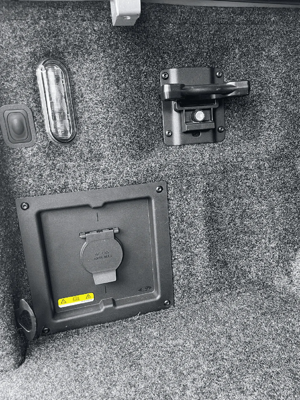

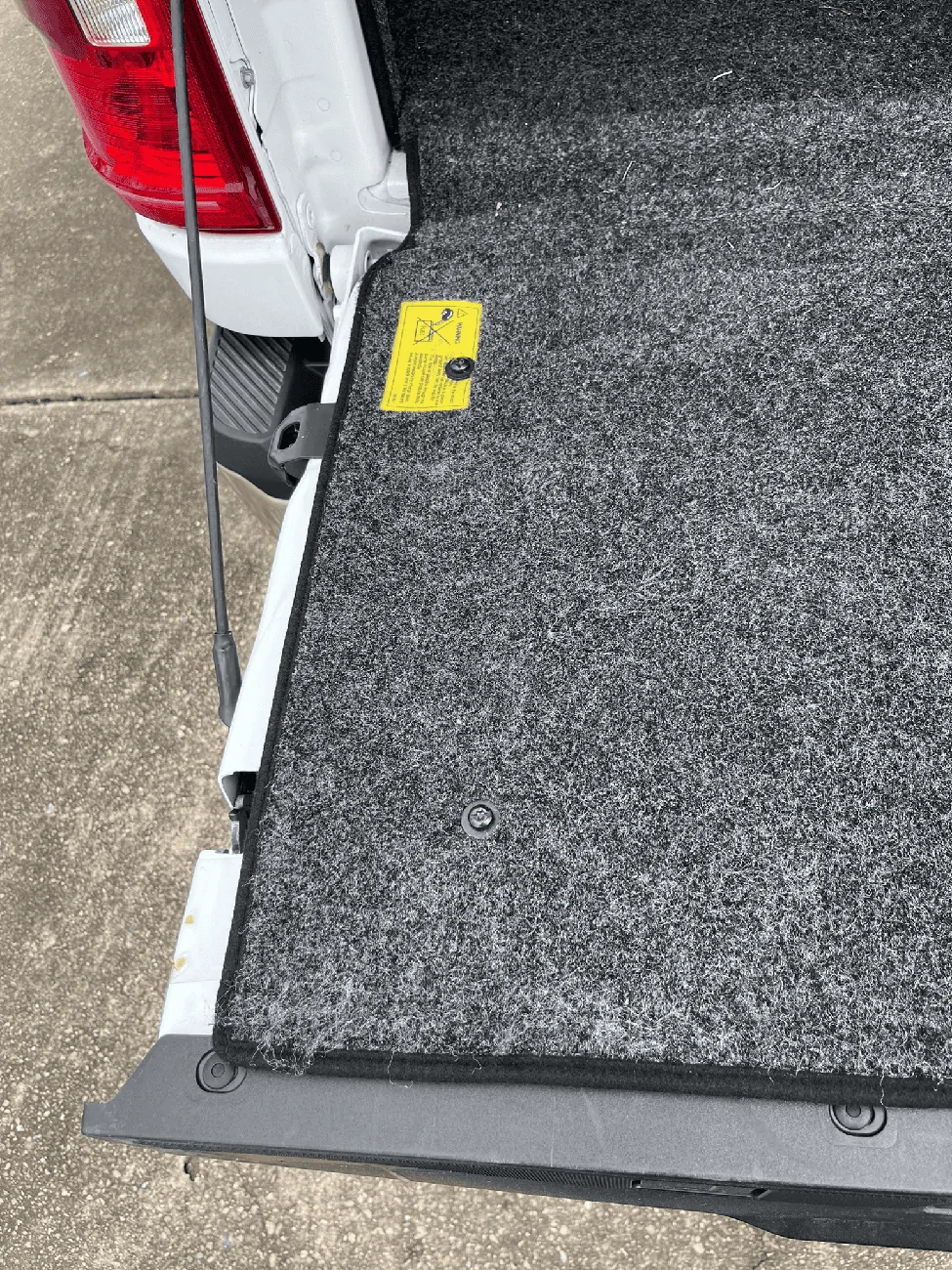

Take your time, I installed mine behind the bed lights, fasteners and outlet. I wiped the painted surface with rubbing alcohol and the velcro strips provided. I actually have leftover velcro from the project. I changed the velcro process and used one long piece on each side of the bed side next to the tailgate. I'm sure the 3M 2 sided tape would work nice as well but not needed.
I also tried to install the plastic tailgate cover over the rug for a custom look but the edges of the rug curled up so i switched it back and used the bed tailgate screws to hold the rug on the tailgate with an additional strip along the edge. Note, i had to put washers under the tailgate rug so it would lay flat. I don't recommend unless you use spacers under the screws.

@Jeb536 Wow yours turned out great, well done. I've noticed in many other pics the bedrug does not contour very well around the bed section near the taillights and yours does. Did you use extra Velcro in that particular section or just what was already on the bedrug? Is this the area you were referencing " I changed the velcro process and used one long piece on each side of the bed side next to the tailgate..."

Correct, I used one long continues piece on each side
