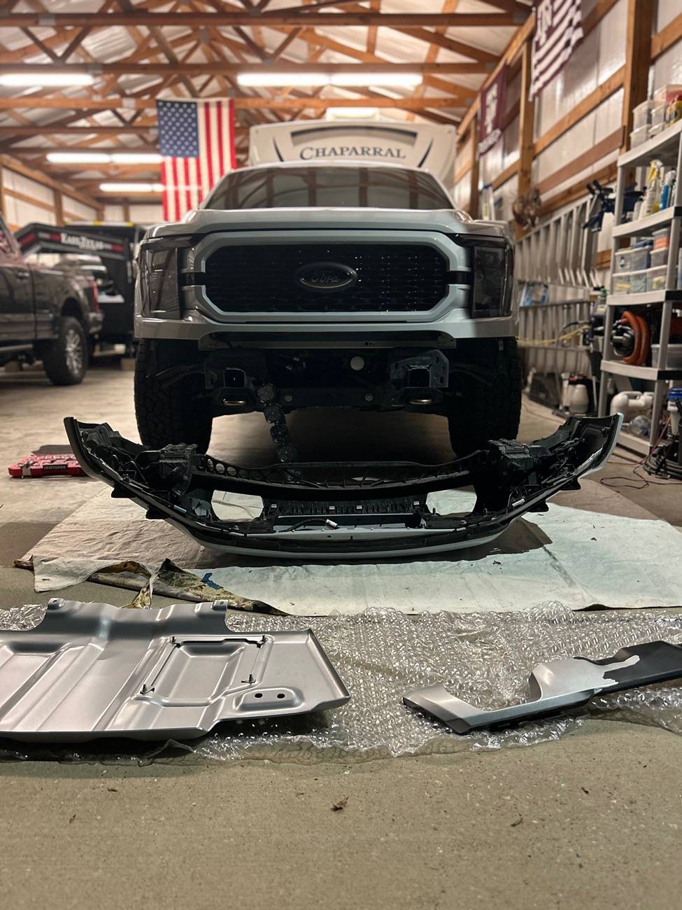

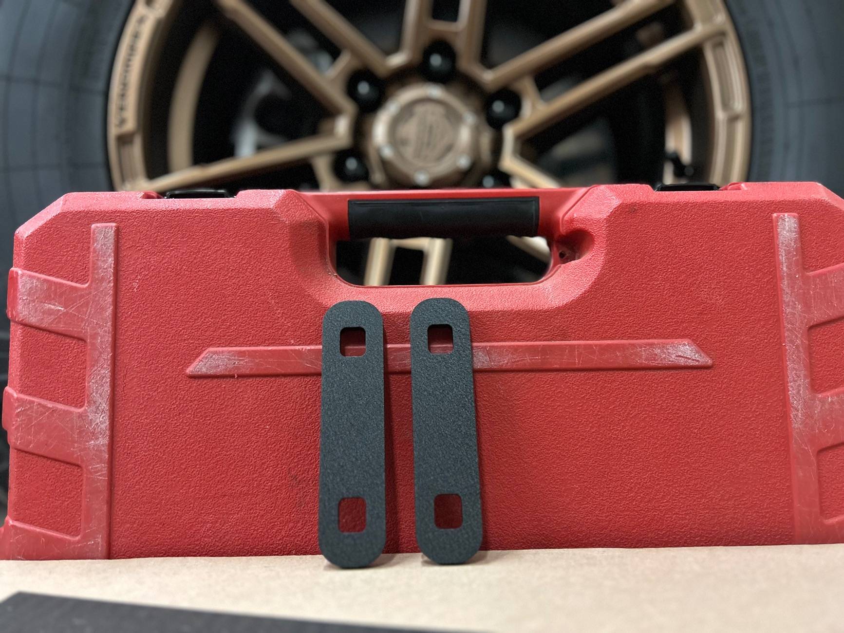

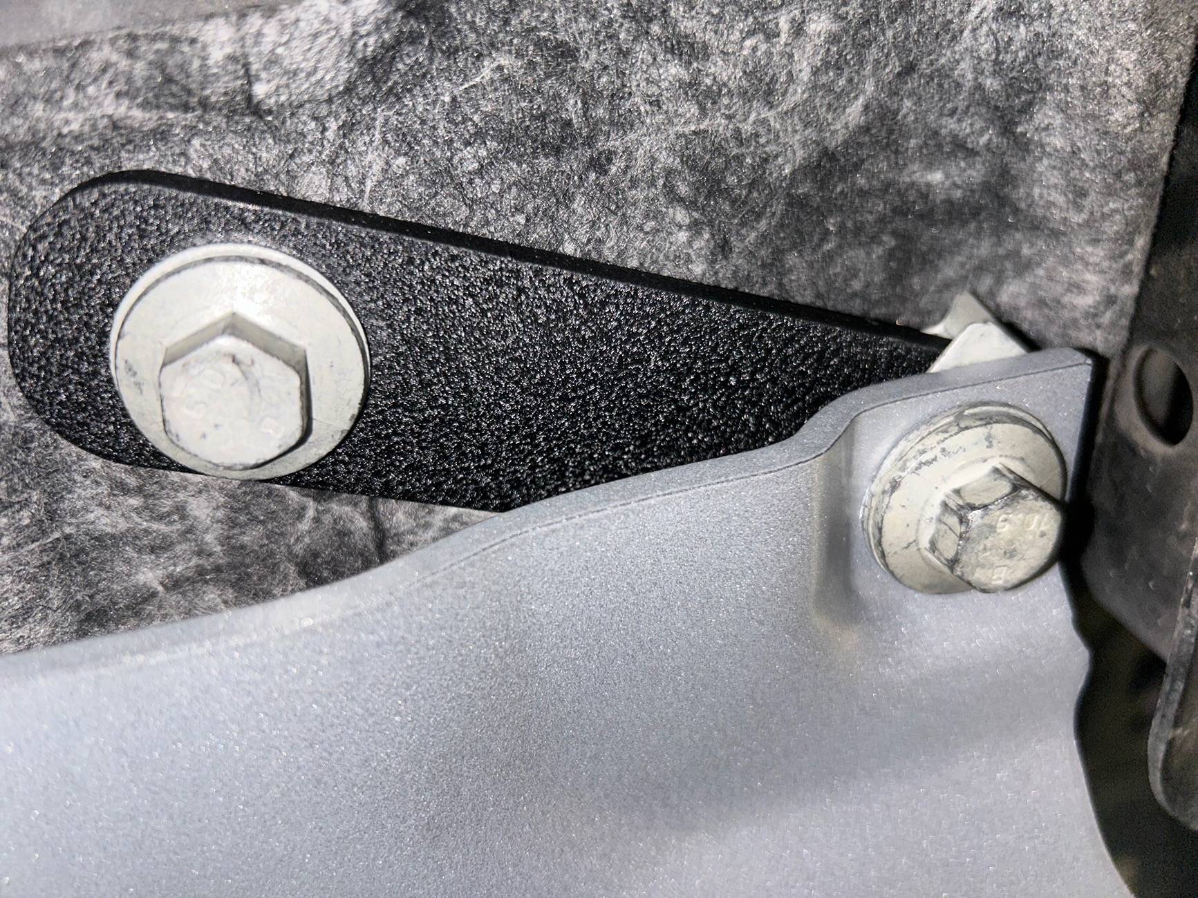

I just tried to install a tremor skid plate on a 2021 f150 with the correct front holes in the frame. But the back holes that are supposed to be on the crossmember are not there. I’m about to have a couple brackets cut that makes it work, if you are wanting to do this to your RWD let me know I’ll cut some for you!
