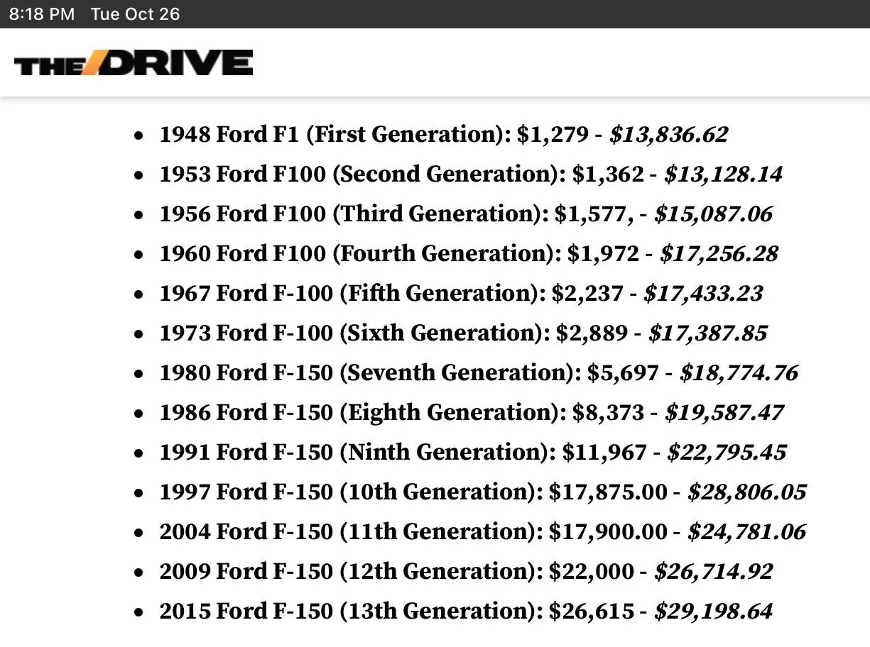

With the price manufacturers are selling new trucks for, it's shameful that they have decided that frame and axle coatings shouldn't be much better than they were nearly a century ago. If new trucks were more affordable, it wouldn't be as bad getting a new one every few years because the old one rusted out, not to mention the ability to enjoy better trade-in prices and last but not least, safety.
With how much new trucks cost and the fact that they use thinner higher strength steel, I'm surprised that there aren't any companies stepping up to strip frame's cheap dumpster paint and then hot dip galvanize them before powder coating and reassembly. It would be expensive after the fact but the frame would probably last 3X as long, even longer if using rust preventative spray and inspection/repairing of damaged coating. A rust belt dealership would probably be able to do it the most efficiently, and they would enjoy better economy of scale.
Ford F-150 Rust Protection Spray 726FB621-9C91-4AA9-818F-986D6CCDC97B
https://www.thedrive.com/news/34333...f-150-has-increased-in-price-over-the-decades
