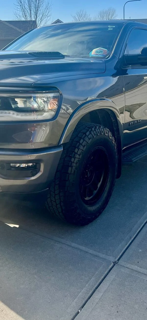

Looking to trade in my 22’ Laramie for a new 24 Lariat. I’d like to keep my wheels and tires but not sure if they’ll fit when it’s leveled with that offset.
Method 18x9-12 with Cooper 295/70r18.
Thanks for the help.
Ford F-150 Rubbing with 295/70r18 on 18x9-12 wheels ? IMG_7633
