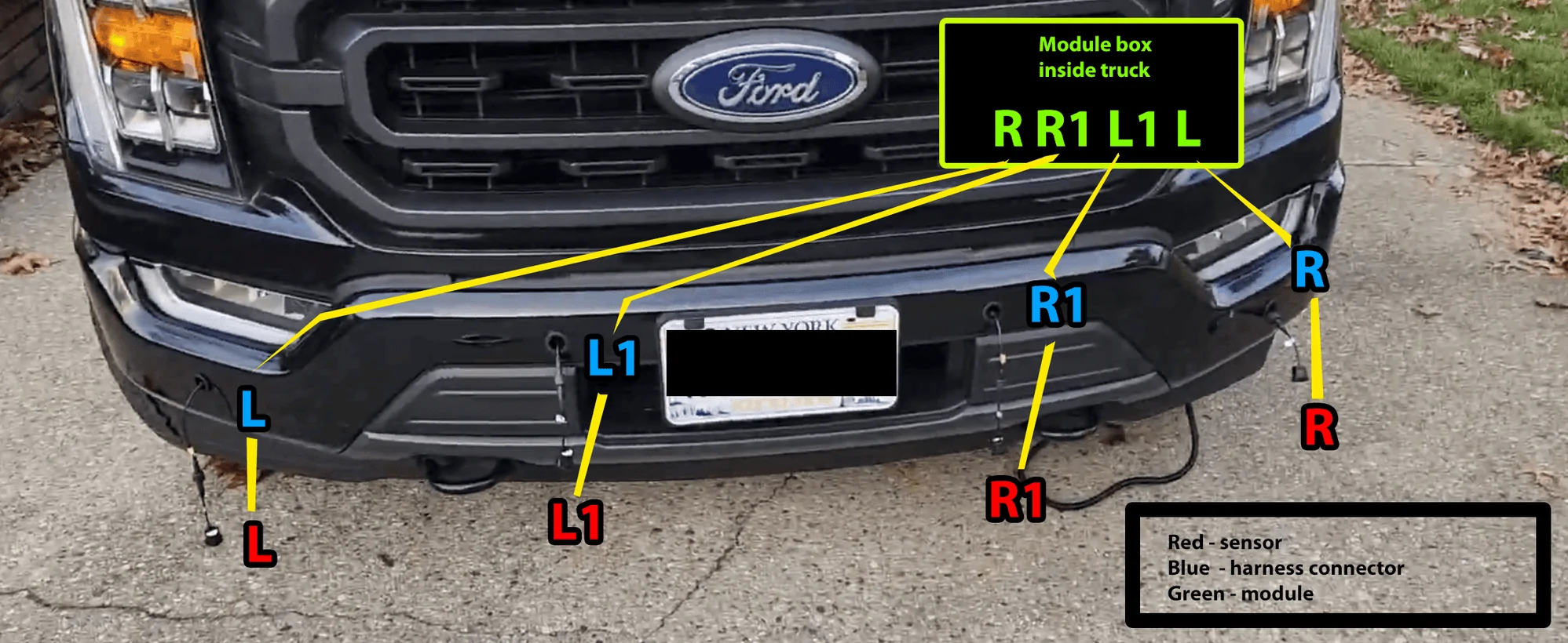

- If you were standing in front of the car directly facing the hood and layed out the long sensor wire that has 4 leads from left to right it would be layed out like this:
Passenger side ------- hood -----driver side
-------- L ------- L1 ------- R1 ------ R------
- According to the manual, the sensors must be installed like this:
Passenger side ---------- hood ----------driver side
------- R ------ R1 -------- L1 ------ L -----
- I installed mine like this:
Passenger side ------- hood -------driver side
---- L ------ L1 ------ R1 ------ R-----
Because I installed the wires backwards, when I hooked it up to the main computer module I just rearranged the wires. So it doesnt matter how you install the wires, as long as the sensor/wire are the same, they can always be rearranged at the module to give the correct result.
My installation
Passenger side ------ hood -----driver side
----- L --------- L1 --------- R1 -------- R------[Sensor]
----- L --------- L1 --------- R1 -------- R------[ wire in bumper]
----- R --------- R1 --------- L1 -------- L -----[module inside]

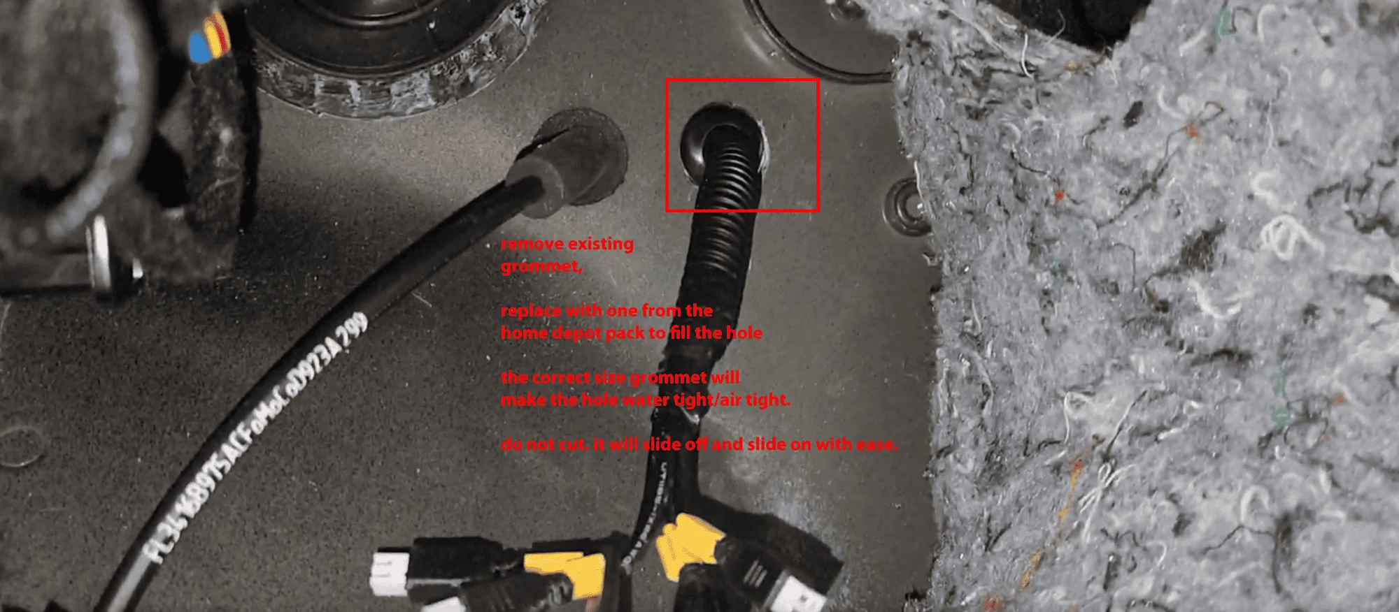

- look where there is a large rubber grommet going through fire wall close to where the pedals are
- To the left of that there is a bare metal surface. you need to drill 3/4th inch hole through there
- On the interior driver side, peel back flooring to expose metal wall behind brake pedal. to the left will be the large rubber grommet, drill directly to the right of it with 3/4th inch hole saw.
- From engine bay, feed wire harness through hole, remove the existing rubber grommet, replace with one of the rubber grommets from that gardner bender pack from home depot.

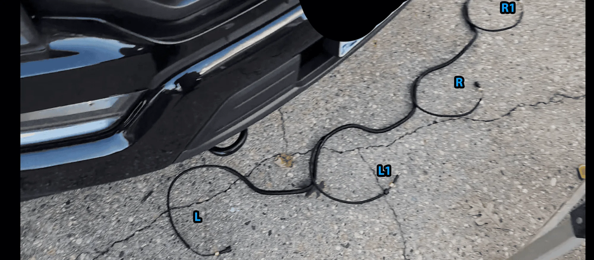

- now run the other side behind air box, and down through wheel well behind felt/plastic to the floor. pull out the long end with 4 wires labeled from left to right L-L1-R1-R

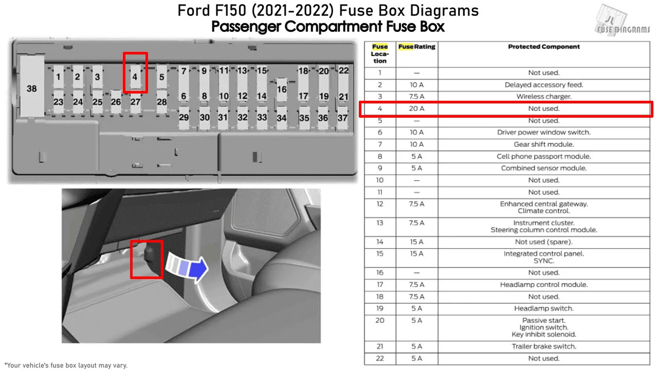

- On driver side passenger fuse box you need fuse number 4 which is a 20amp circuit.
- each fuse has two slots, one to the left and one to the right, the right is the "hot" lead
