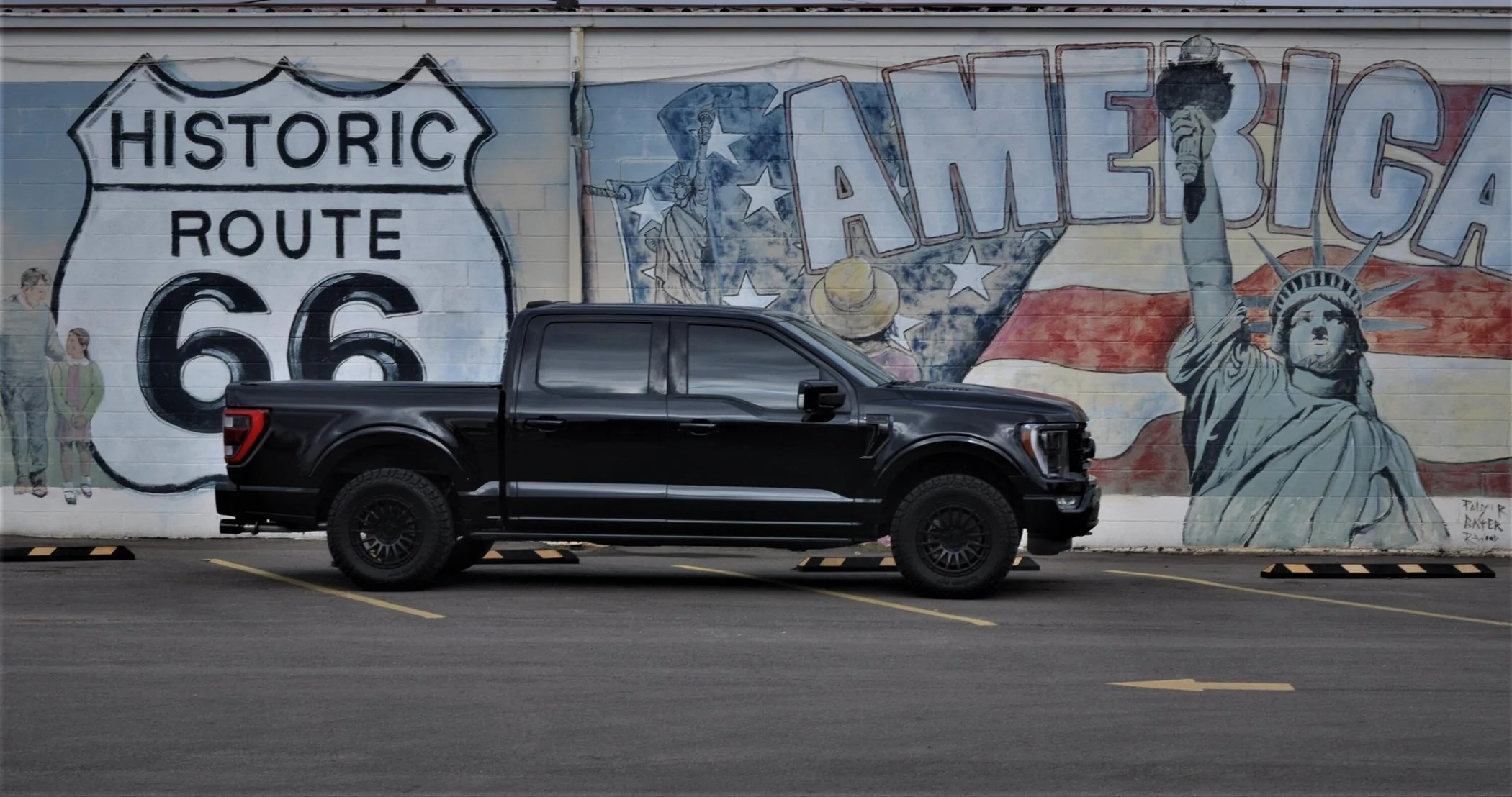

Maxtrac 1" shackles, block removal, no shims, no alignment. Everything rides good. This truck has gone over 140mph on the highway several times so if the alignment was off, I would know it lol.

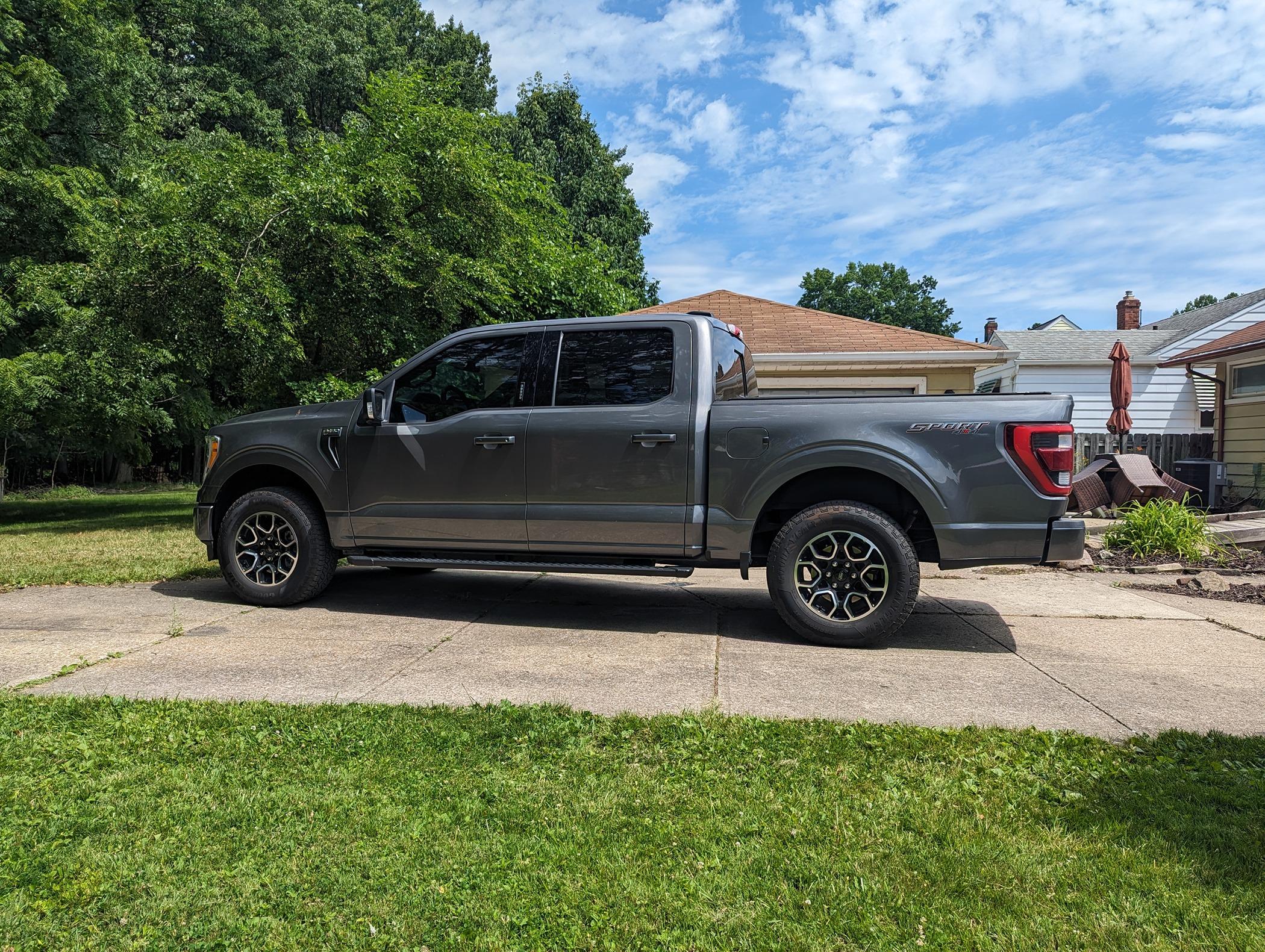

I just pulled the rear blocks today. Still has a baby rake but much better than before and of I tow itll still have a bit more to give before the front launches up.
