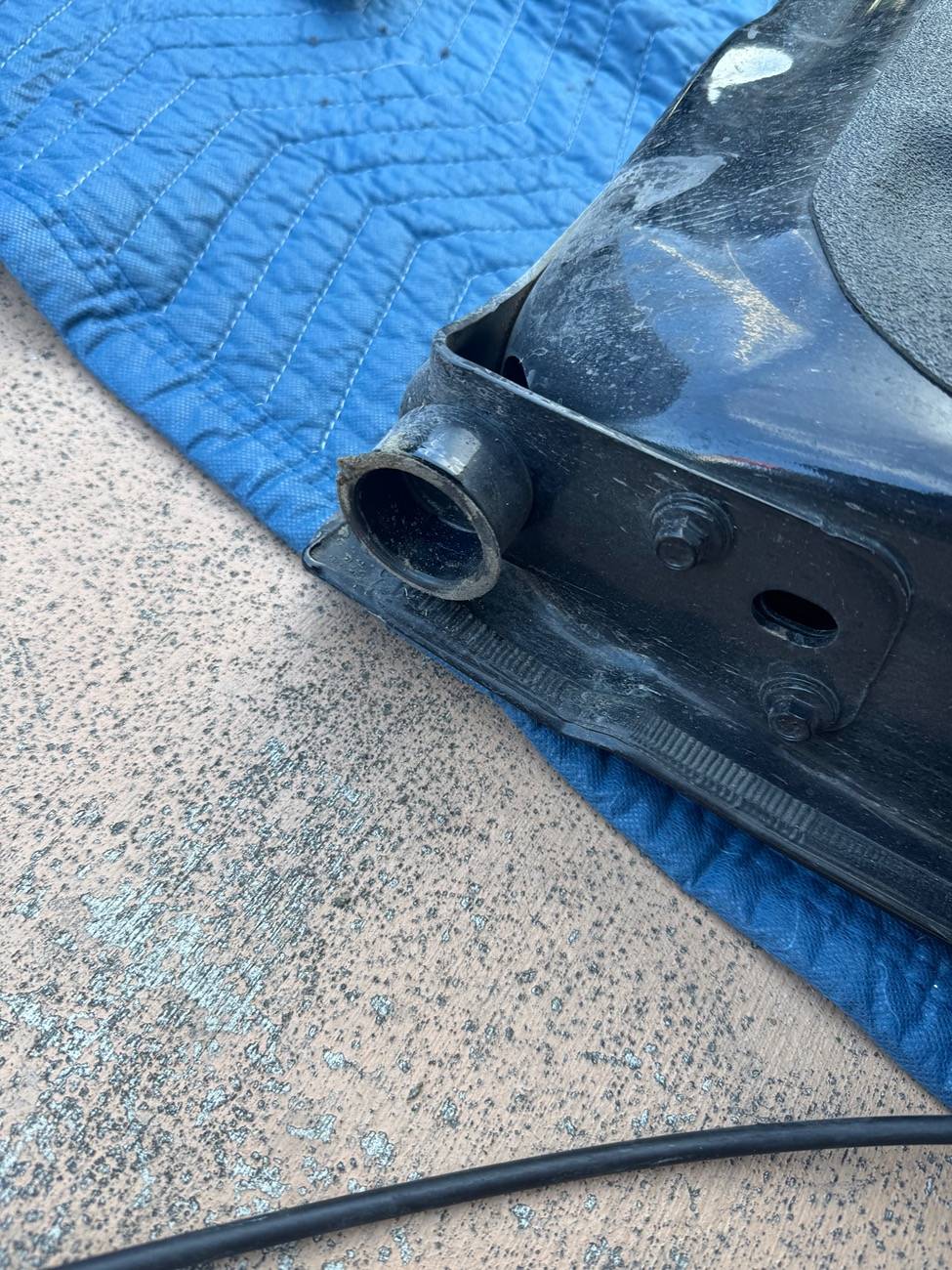

this is the factory hinge on my drivers side. this piece is incompatible with a motorized tailgate. I did manage to order the correct piece from Ford parts department and I should have it in a few few days.

So the brackets on the original tailgate is no problem because they aren’t connected to anything, but on the new tailgate, the bracket has some type of driveshaft going through it, which goes into the hinge on the side of the truck.
The original bracket doesn’t allow for that shaft to go through it.

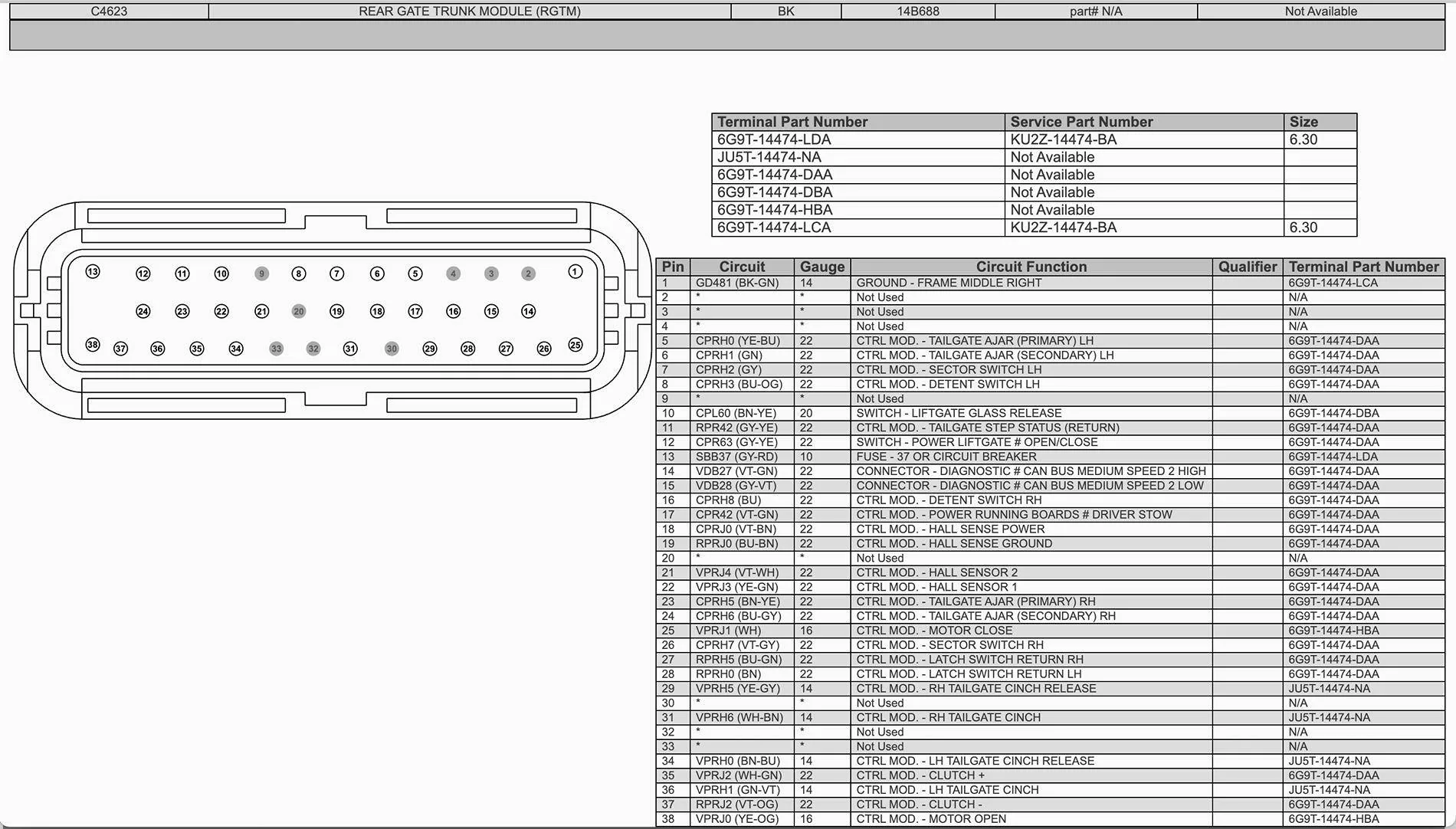

I gotcha, yeah that’s probably for the actual motor

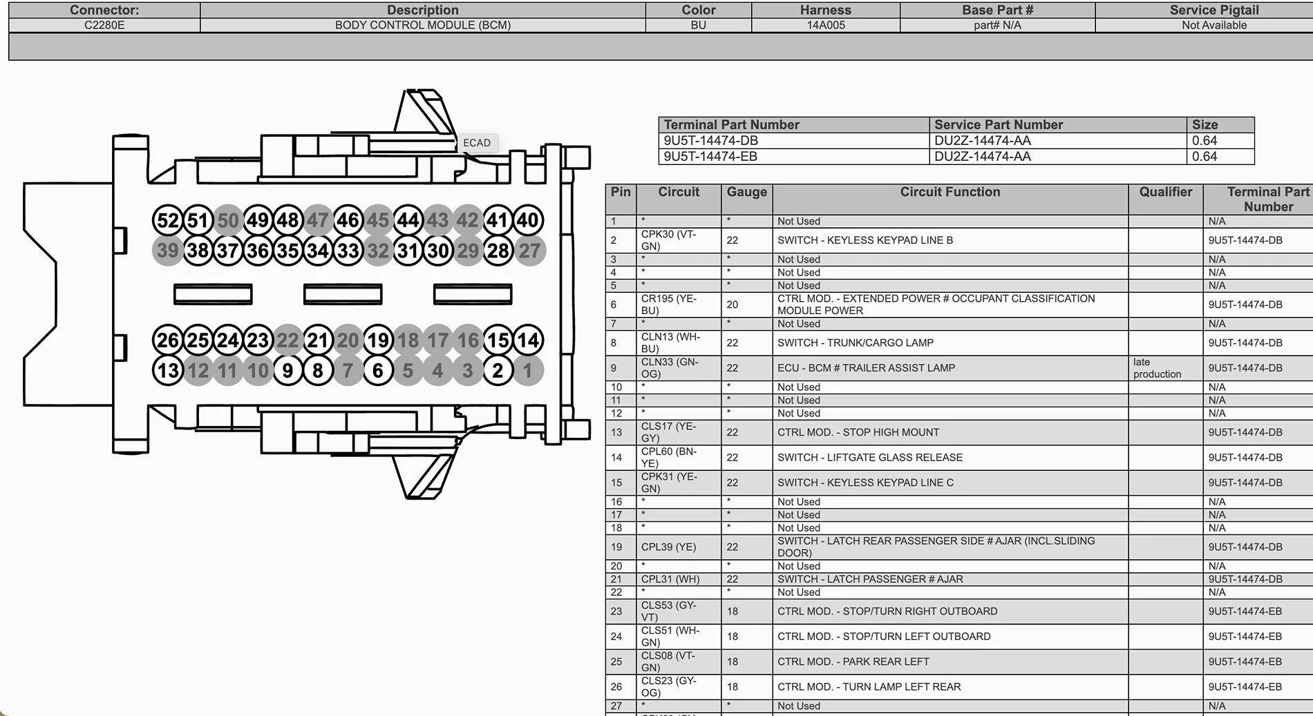

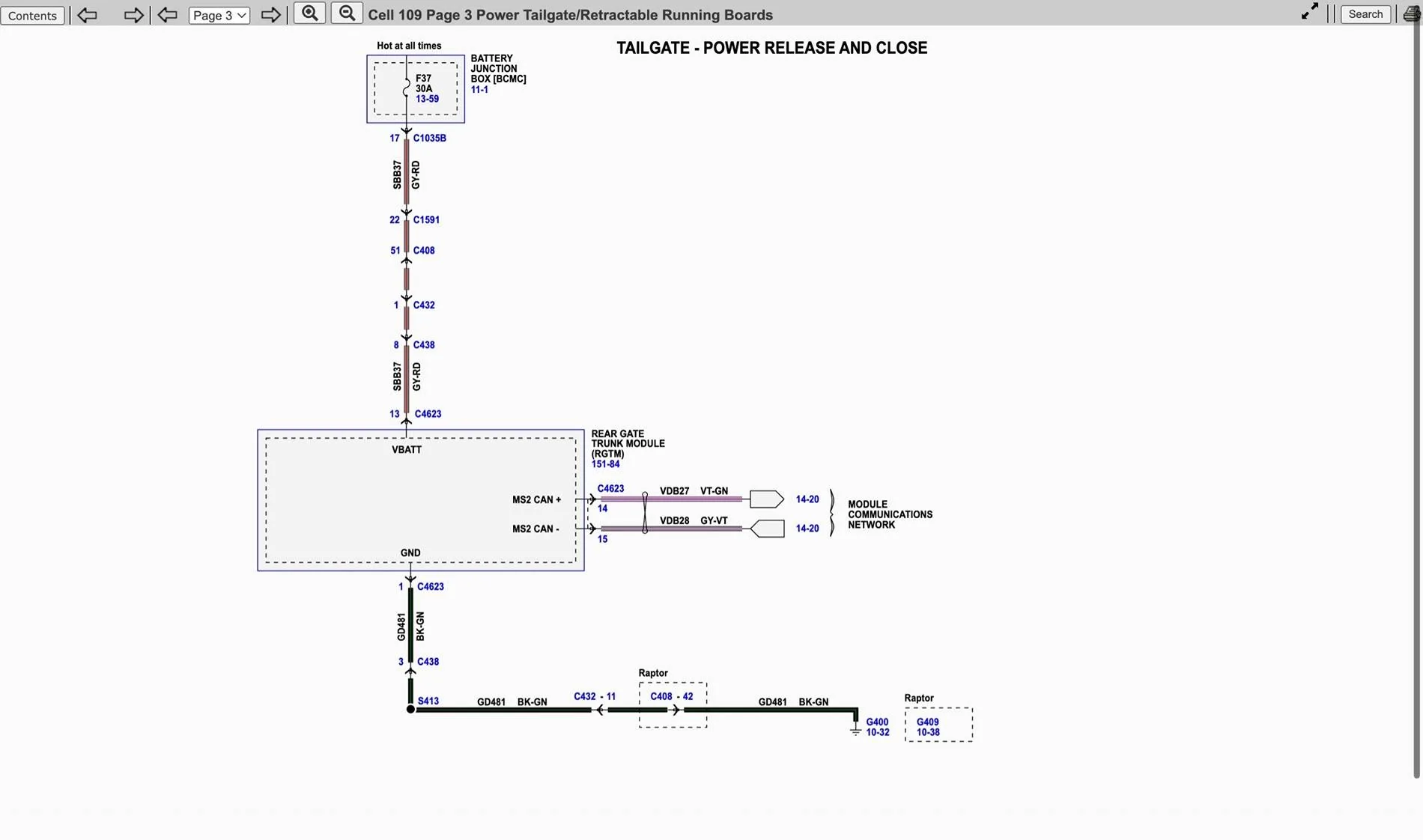

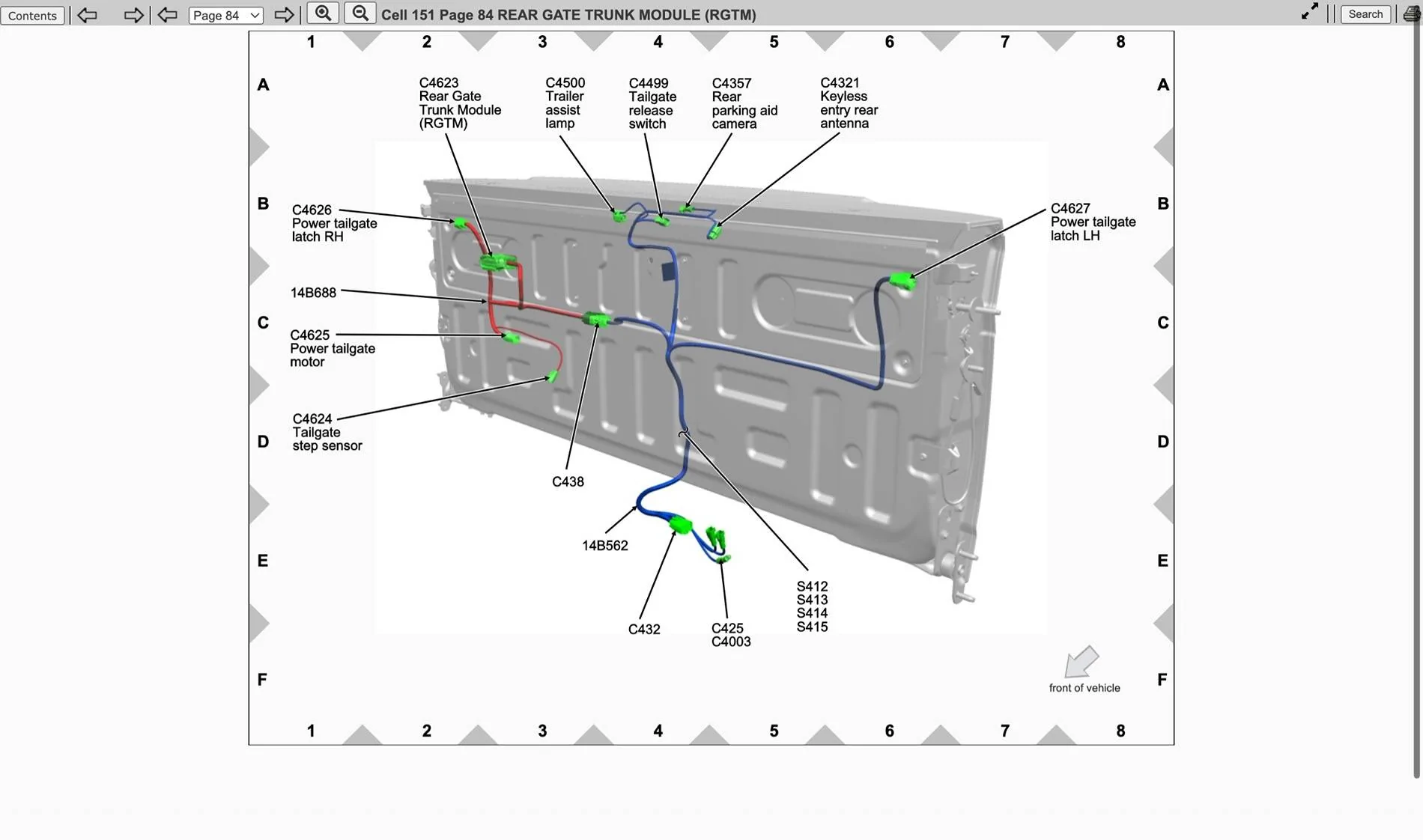

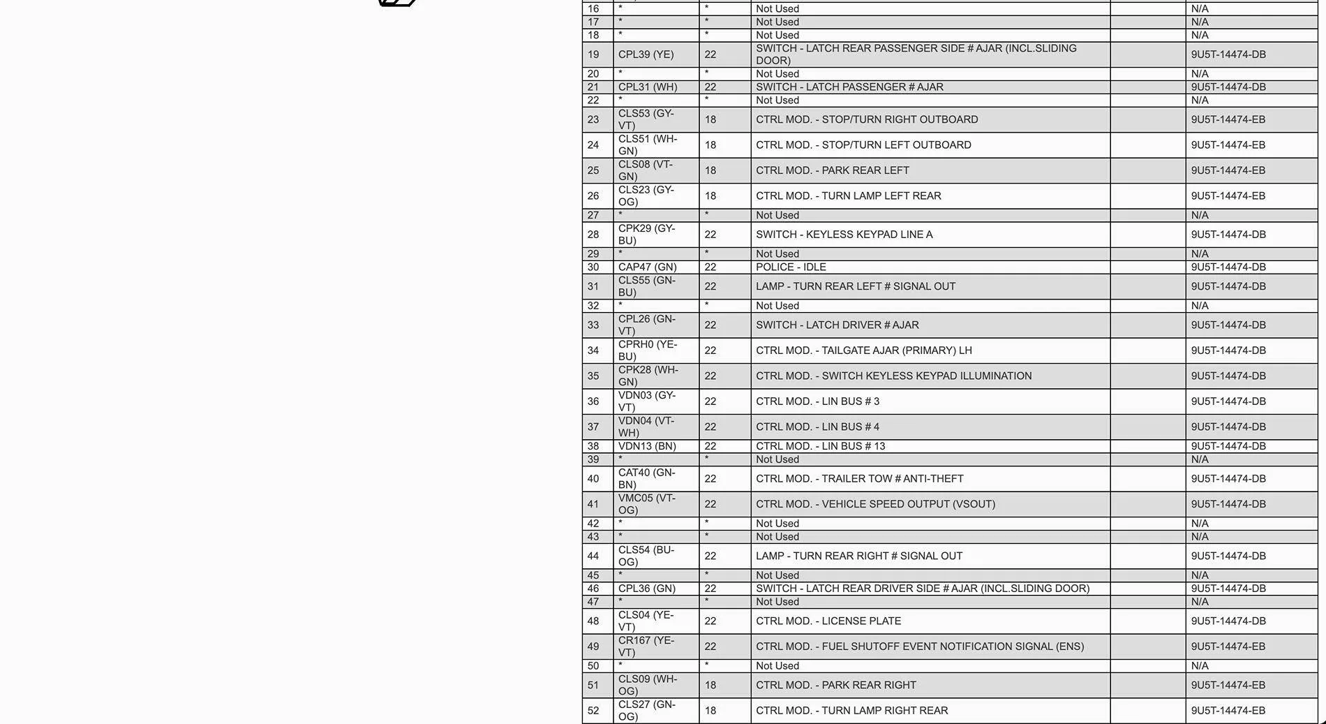

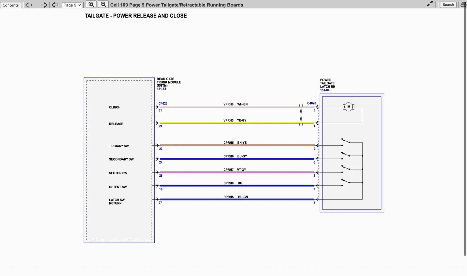

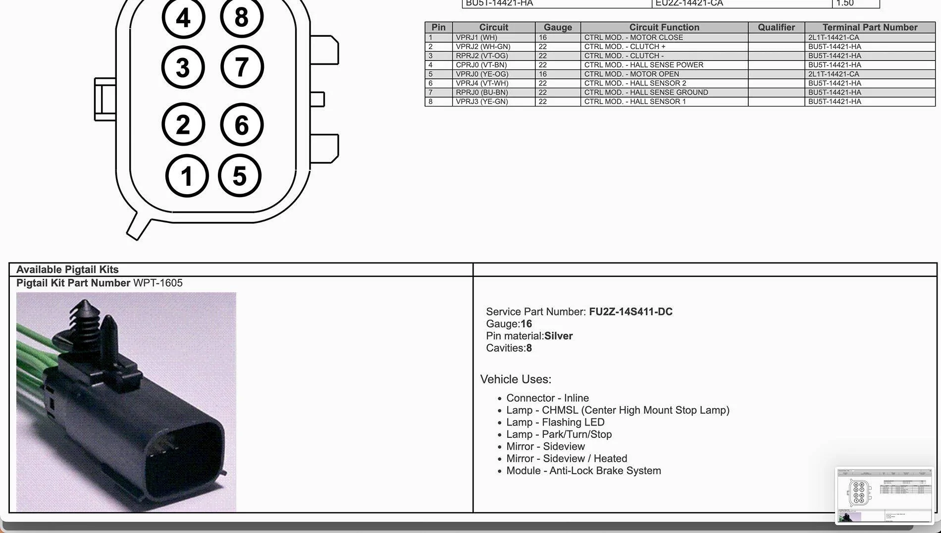

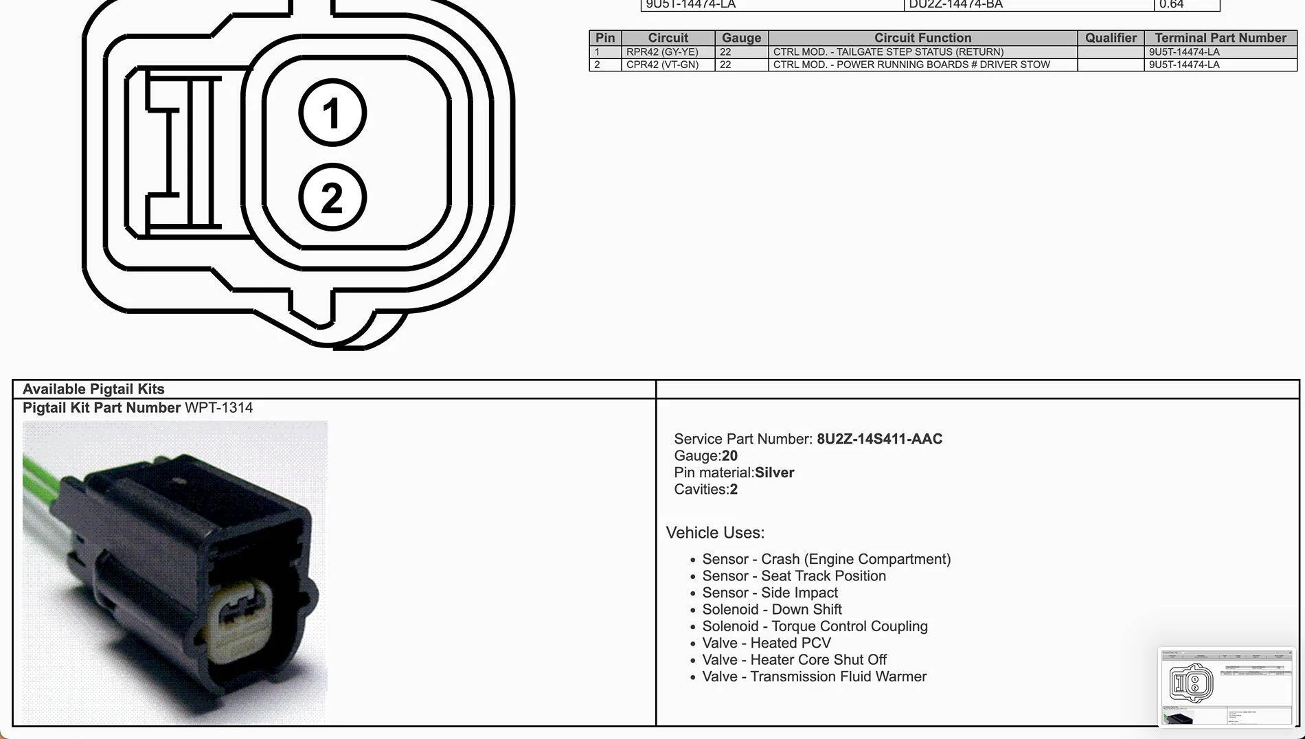

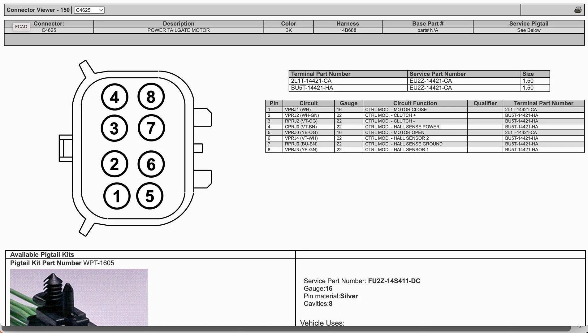

Here are the diagrams I have
Ford F-150 Retrofit power tailgate? BCM_RGTM to Latch
Ford F-150 Retrofit power tailgate? BCMC to RGTM
Ford F-150 Retrofit power tailgate? BCM Cont.
Ford F-150 Retrofit power tailgate? Tailgate Sensor Cont.
Ford F-150 Retrofit power tailgate? RGTM Connector
Ford F-150 Retrofit power tailgate? RGTM to Latch
Ford F-150 Retrofit power tailgate? RGTM to step sensor
Ford F-150 Retrofit power tailgate? Tailgate diagram
Ford F-150 Retrofit power tailgate? BCM Connector
Ford F-150 Retrofit power tailgate? RGTM to motor
Ford F-150 Retrofit power tailgate? RGTM_BCM_Release switch
Ford F-150 Retrofit power tailgate? RGTM to Release switch
Ford F-150 Retrofit power tailgate? Power Tailgate Latch Connector
Ford F-150 Retrofit power tailgate? Motor Connector Cont.

Oh my. Thank you! That’s a lot of info. I’m not sure how I’m going to figure all this out.
Once you take it one module at a time, it’s easy to figure out

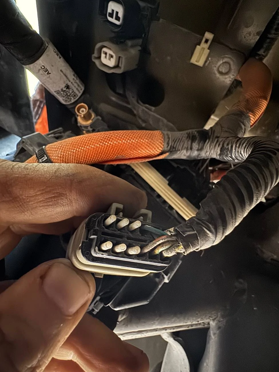

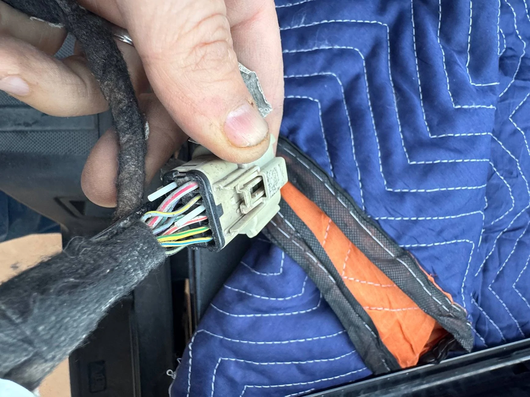

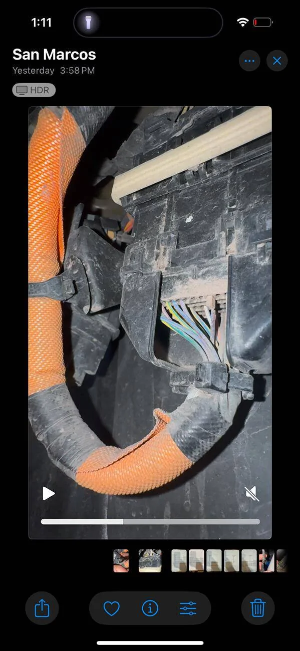

Does anyone know the pin layout for this harnesses how to get it? It appears to have al the wires I need.ita located near the spare tire and appears to be connecting to twilights , tow hitch, and tailgate
Ford F-150 Retrofit power tailgate? IMG_3717
Ford F-150 Retrofit power tailgate? IMG_3716
