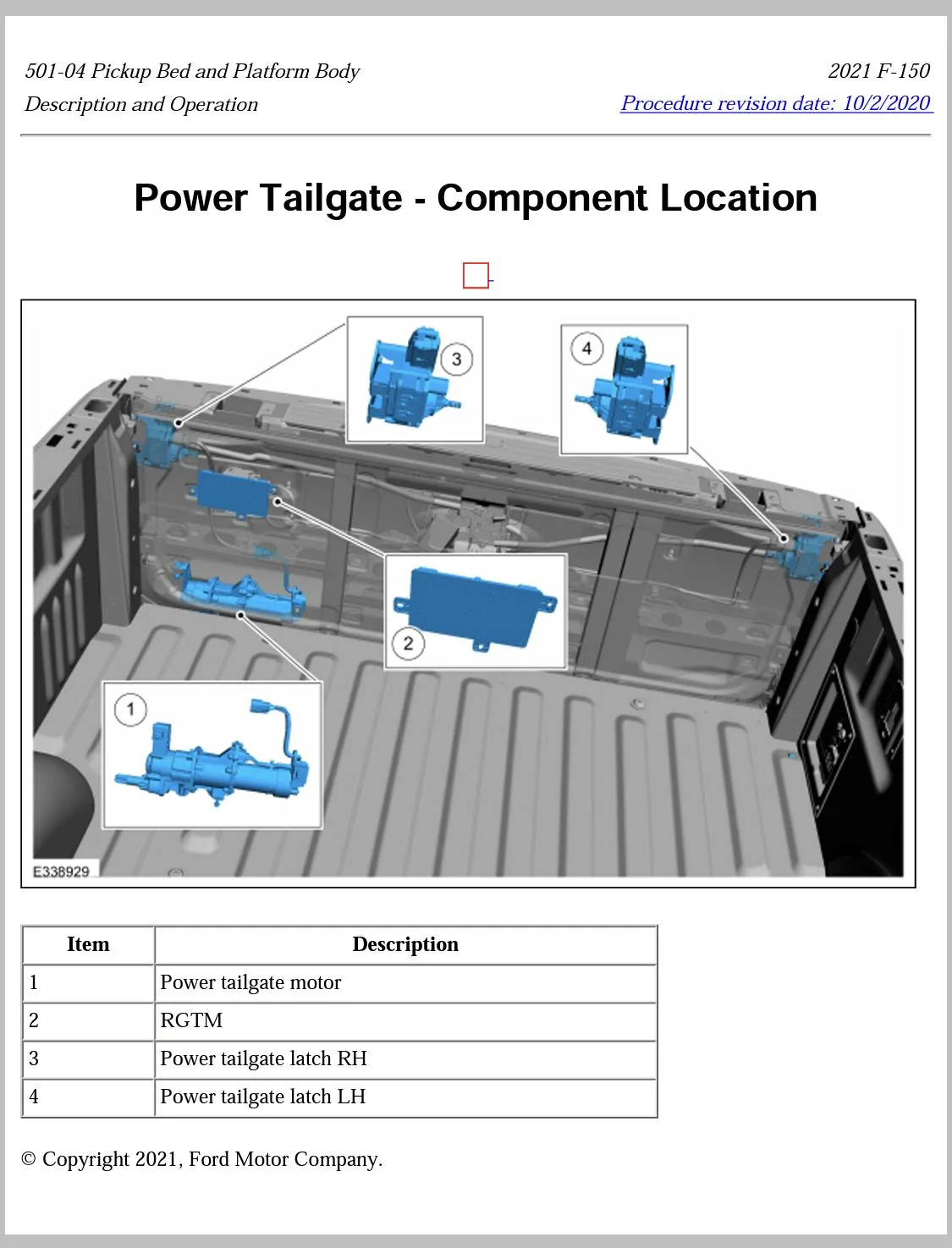

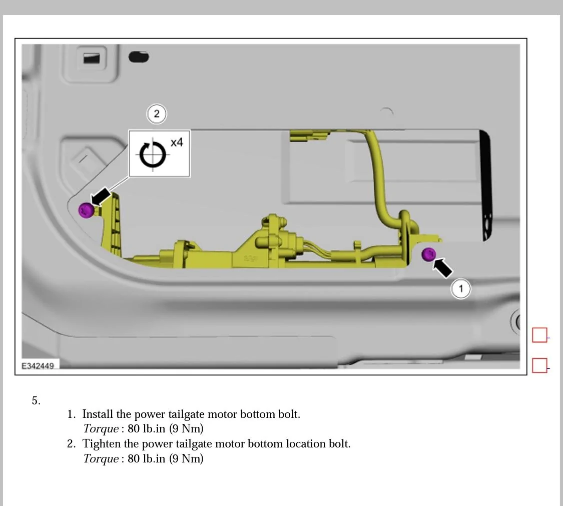

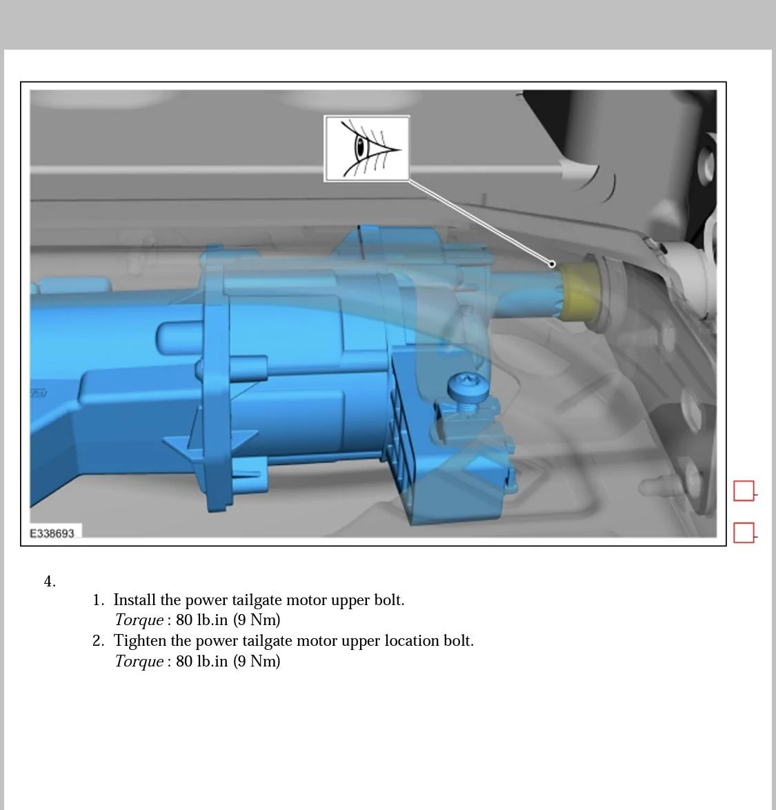

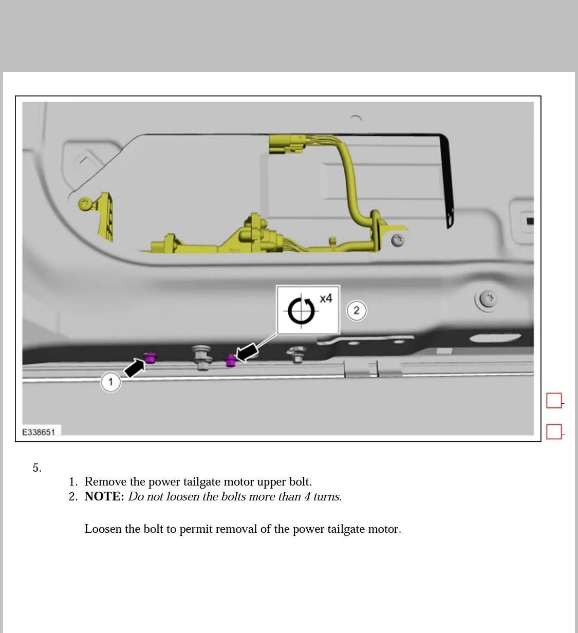

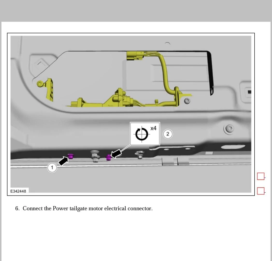

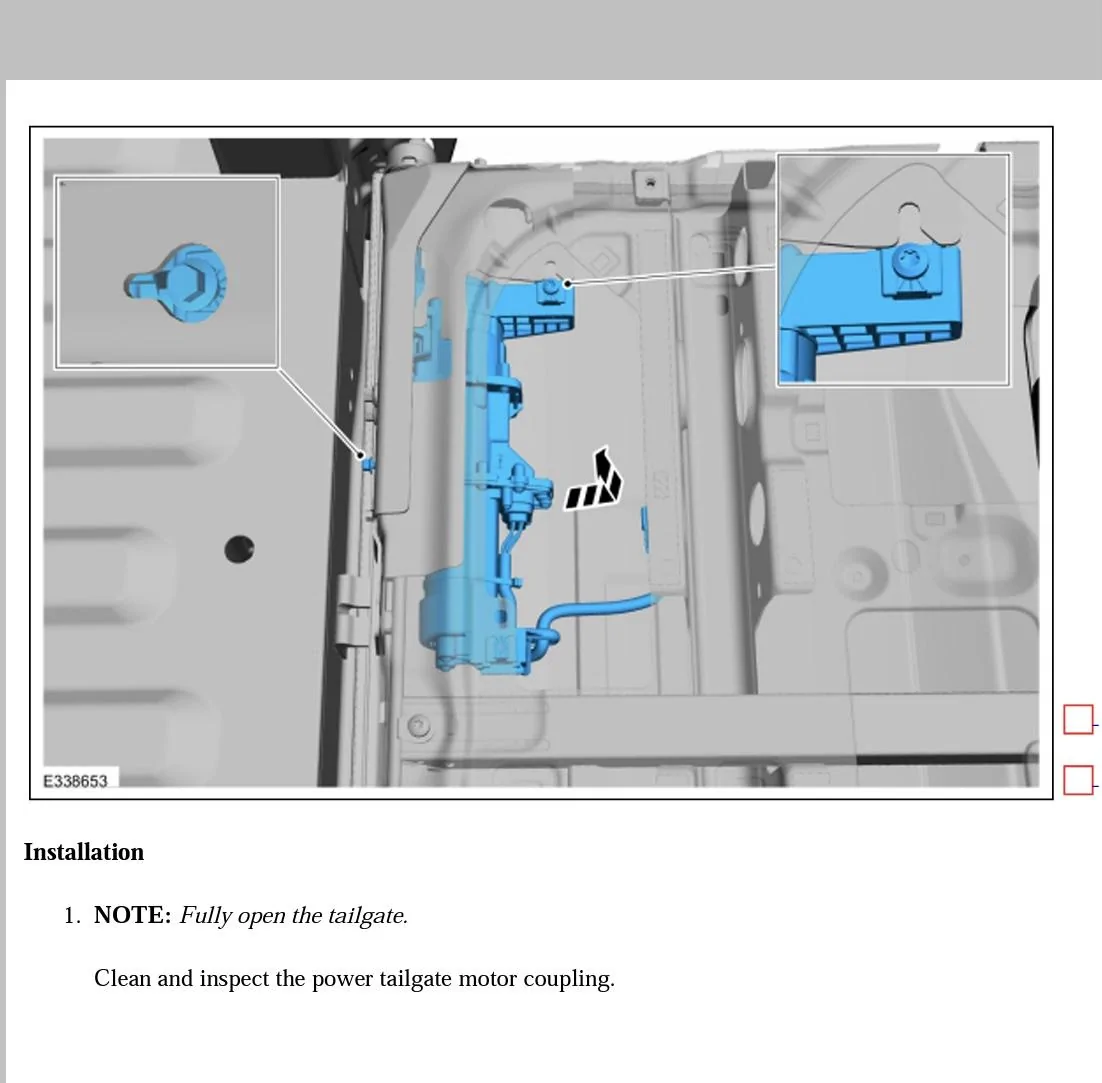

Zyvin, is there any way you can pull up the replacement procedure for those parts in the workshop manual?
I could if I didn’t have a real job that has nothing to do with Ford trucks taking up all my time, lol.
Below is the motor R2. If you already have remote release, I would assume you have the latches and control module already???
