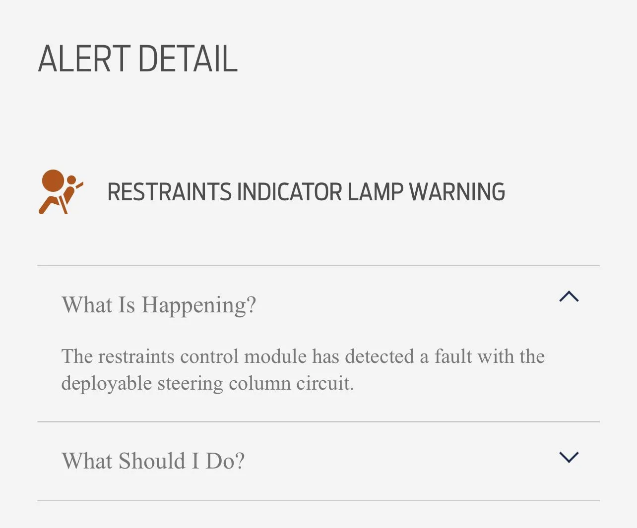

Getting this in FordPass. And this symbol appears on the instrument cluster intermittently.
The vehicle had a recall on it for this but the recall said “inspect and if necessary install” and I want to check if that harness extender was installed.
I don’t want to leave the truck at the dealer for several days over this. Any instructions on the recall on how to check this and if necessary order the extender myself?

Ford Motor Company (Ford) is recalling certain 2022 F-150 vehicles. The power-adjustable telescoping steering column connector wiring may be too short. Wiring that is too short can become damaged or separate if the adjustable steering column is extended all the way.
Recall consequence
Damaged or separated wiring may result in the steering column not moving as intended in certain crash conditions, increasing the risk of injury in a crash.
Recall action
Dealers will inspect the steering column wiring harness and repair the wiring, as necessary, free of charge. Interim owner notification letters informing owners of the safety risk, were mailed on May 9, 2022. Owner notification letters were mailed July 28, 2022. Remedy parts are expected to be available by the end of July, 2022. Owners may contact Ford customer service at 1-866-436-7332. Ford's number for this recall is 22S24.
