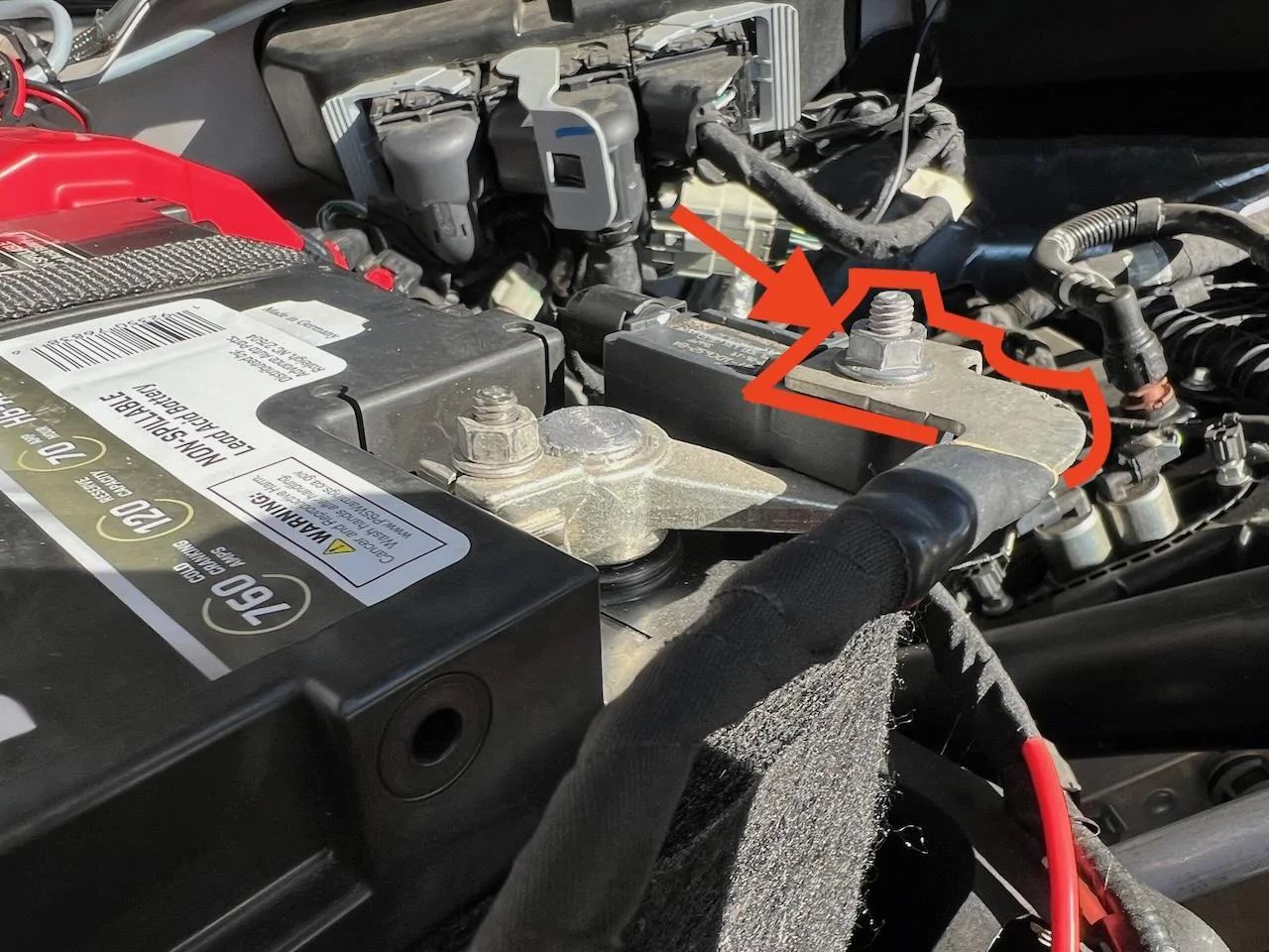

Thanks Ford folks but I solved the issue
it was a sensor on the negative terminal of the battery that was loose for some reason.
I tightened the bolt and all is well now.
