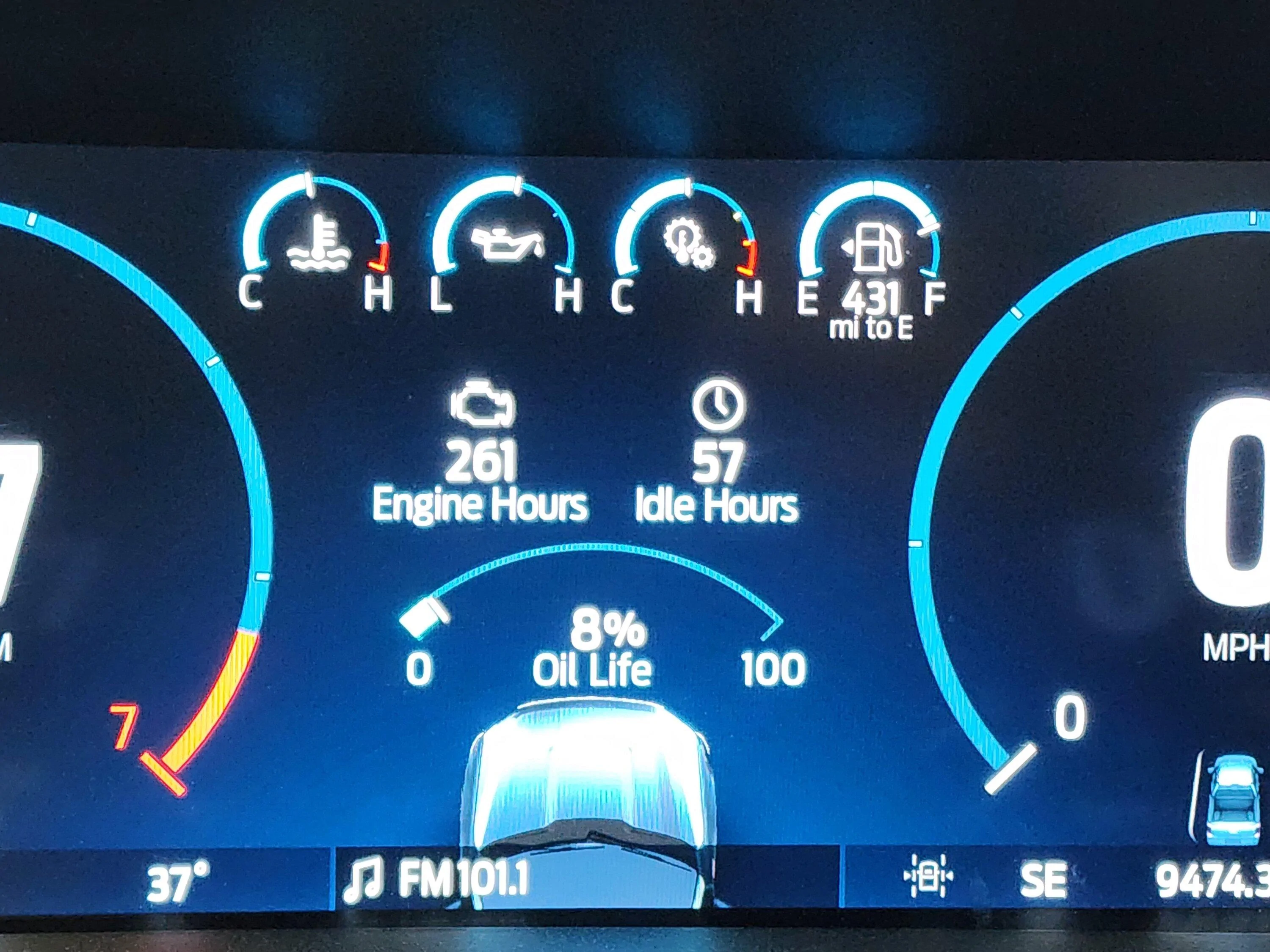

I have a 2021 Job 1 truck and just had the oil changed and the reset for the oil life isn’t working. It says resetting but it never does. Has worked without issue all previous times. I have received several power-ups since the last oil change. 4.3.6, 6.1.0 and 6.2.0 in the past 6 weeks or so. Anyone else seen this issue? Is it related to one of these updates? Dealers are weeks out for an appt and really don’t want to waste the time if this is known and a fix is coming.

Ford F-150 Reset Oil Life Stopped Working 20231114_105034
under Engine menu i dont even have the Reset option...where is it??

Talk to a tech yesterday. In the 12” screen it doesn’t reset, they removed it from that screen where you posted and you have to go back to settings. Under the settings menu there is yet a 3rd spot that shows oil life where the reset works.
Hey man did you ever end up resetting it I’m in the same boat I can’t get it to reset I did do the screen swap on my regular cab so I have the digital cluster on my 23 and I can’t find a way to reset it please DM me need help

i dont recall where it was but i found it in one of those menus.
Well I can’t reset it on engine information I hold “ok” and it doesn’t do anything and when I go down to “settings” I have not tab that says “maintenance” so I’m super confused.

Mine has done this a few times where it didn't want to reset from the cluster. but I had to do it several times from the infotainment system then drive about 20 miles and cycle the start/stop a few times and then it decides to reset on its own.
