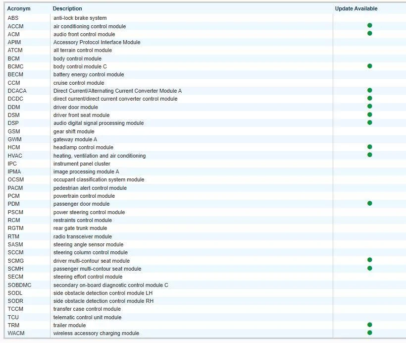

Good afternoon! New member, I recently picked up a 24 Powerboost. VIN (). The truck was bought new but has been a dealer loaner since August. It took me a month to get it unlocked from the fleet and it has never been updated. Can you please help me look at the history and if I need to take it to a dealer to receive an OTA
Modules with pending updates are below. Connectivity seems to be working fine. If all your Fordpass functions work, you should be good to go. Ford does pay dealers to update modules just because they aren't up to date. Eventually, an OTA will come in for one of these. There is nothing you can do to speed up the OTA process.

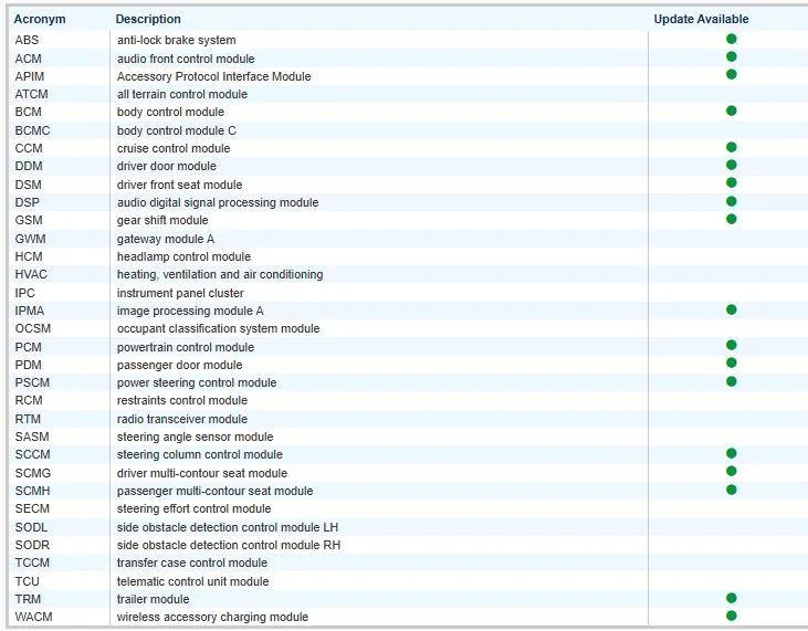

New to me '22 - planning to do the Mongoose loaner cable thing and the other day all my custom settings in Sync reset. I wonder if the truck got some updates finally. Can I get a VIN check and see if its still oudated and worth doing the mongoose loaner to get BC1.4 going? VIN *** (will be removed when replied)
rugedraw
Javier
Dec 14, 2021
7,413
9,008
Miami
Auto Sales
New to me '22 - planning to do the Mongoose loaner cable thing and the other day all my custom settings in Sync reset. I wonder if the truck got some updates finally. Can I get a VIN check and see if its still oudated and worth doing the mongoose loaner to get BC1.4 going? VIN (will be removed when replied)
Truck is on the latest Sync version and pending updates are below. The myview resetting is a known issue and doing these updates won't help....Ford has to fix that. With the IPMA/PSCM updates you see below, you would be able to enable BC 1.4.
