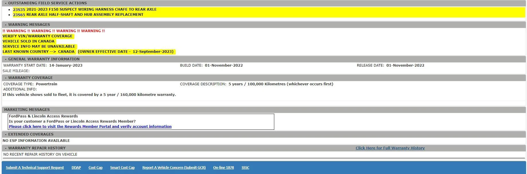

I'm not familiar with etiquette on this forum and don't want to be spamming a thread, but here are the entries from the carfax. They did do a couple recalls last week, so that would explain that record. It was purchased from a GM dealer, so they sent it over to a Ford dealer for the work.
The sole purpose of this thread is to answer questions about people's vehicles, so spam away. This is what PTS shows for your truck as far as the open FSA's and warranty history.

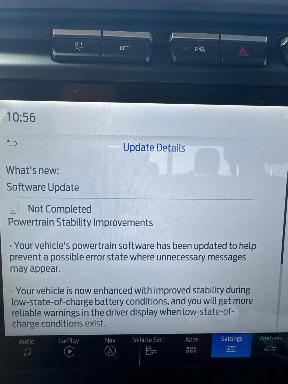

Chris2117
Apr 8, 2023
North Carolina
2021 F-150 Lariat PB
Would someone check mine for updates. I currently have the Powertrain update showing in the truck for a few weeks now(23-PU0630-YAW-RT). Update schedule is set, lights off, parking brake set, etc. but the update won’t go through. I’m wondering if there’s another update that has to go through first, but is stuck for some reason.
VIN: 1FTFW1ED5MFB06652
EDIT: I’ve also been using a battery tender at night.

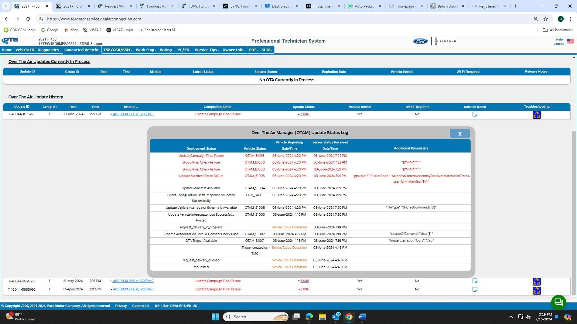

"Not Complete" means the OTA failed and PTS confirms this. The update has been sent to you three times and failed all three times with the same error. The manifest does not match up with the files the mothership wants to send, so the truck rejected the update. I am not sure why the server hasn't picked up on this by now to correct the issue, but you are not doing anything wrong nor could you have done anything differently.
Because this particular OTA has failed multiple times, you may be able to get the dealer to do it, but that's always a risk of being a waste of time.
