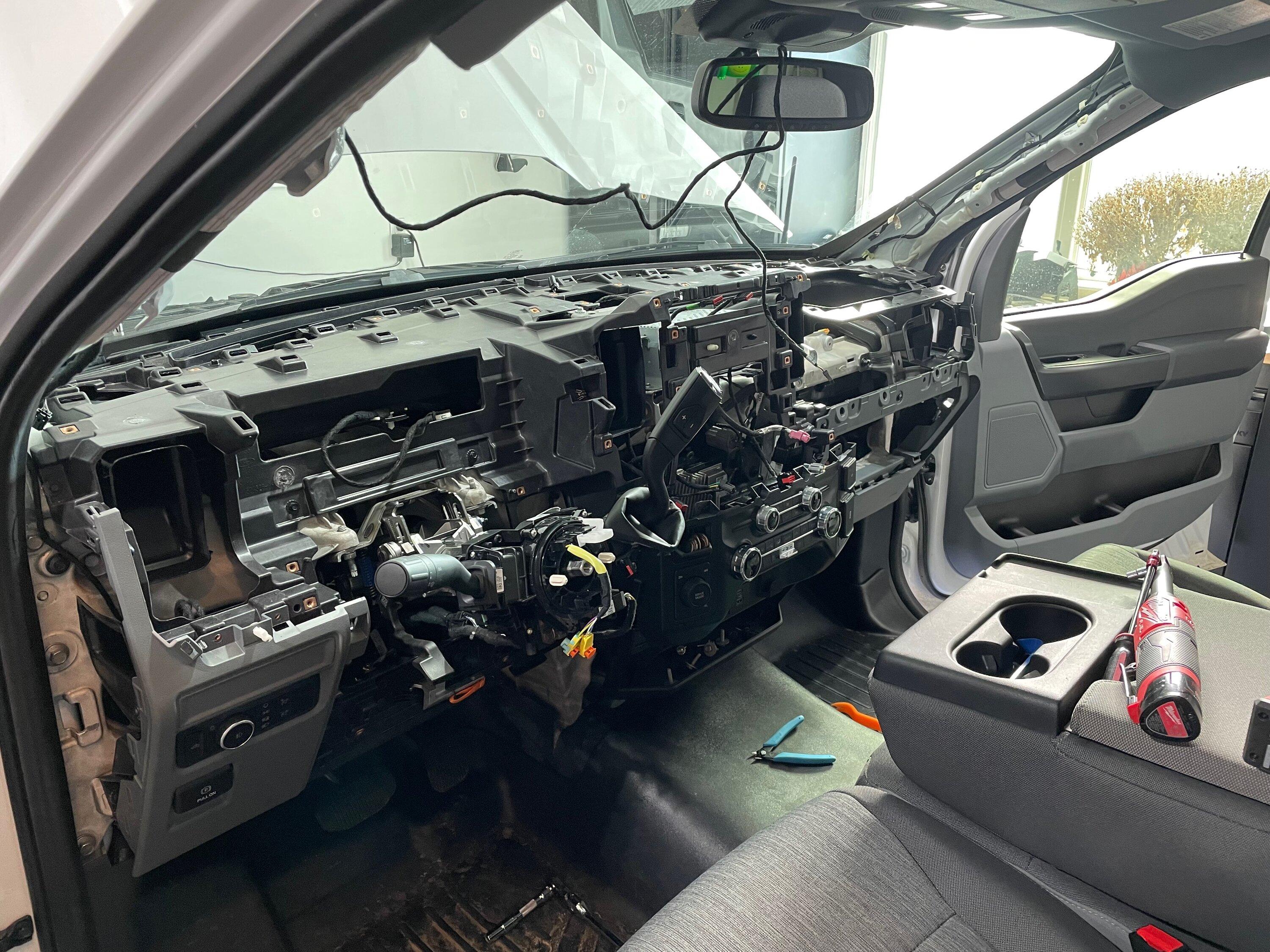

Anyone know what's involved in replacing the upper left and right dash panels. Does the entire dash have to be removed?
Thanks!

If you are talking about the top pads, yes everything comes off. Here's a picture of mine mostly disassembled. (The steering wheel can probably stay on but i was adding a heated wheel at the same time as the 12" cluster)

Holy Batman, what project are you working on or find a rattle ??

I swapped in a 12" cluster. To do that right you have to replace the two top pads on the dash and the cluster bezel. So the entire dash has to come off. I took that opportunity and did the heated wheel and rain sensor upgrade at the same time as well.
It's not really difficult just takes some time.

Thanks for the post. At least now I know what involved!!! I was told the entire dash assy. had to come out but I see that info was not correct...

Im pretty sure it requires dash removal. I had a 2020 XLT and was going to upgrade to Lariat dash ends with leather and stitching on pads. after researcing,I scrapped that project

i have done it as well, its not that hard, just take your time and be neat
