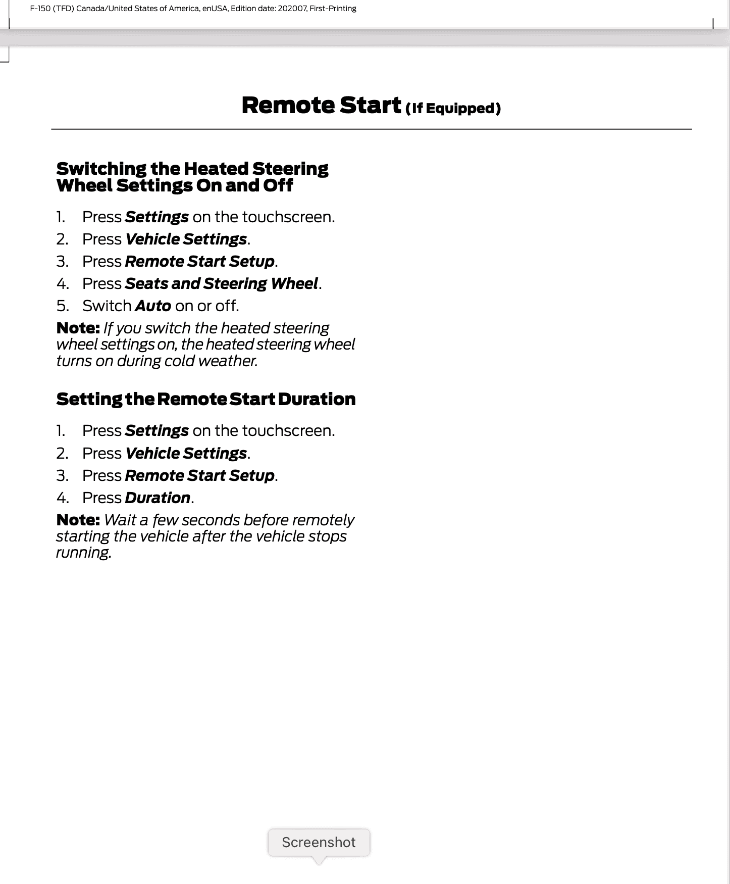

Question: In the manual it states that all other systems in the truck will remain off when remote started.
Does this mean that the AC will not run? That’s probably the #1 reason I would want to use it as cars here get extremely hot parked in the summer.
Go back to #6 in this thread from jcaspar

Two things, first after doing the sequence for a week, it will be automatic, and you can do it in your pocket without looking (lock, then double click on start button). So not a big deal.
Second, this sequence allows additional function (as above RTFM). You can extend for another set of run time before it turns off by doing the full sequence again. But OTOH, if you decide not ready to leave yet, you can cancel (and turn off) the running remotely, but hitting the remote start button twice WITHOUT hitting lock first.
So the sequence prevents inadvertent (by needing 3 pushes on 2 different buttons) as opposed to the panic button that I trigger ALL the time (my height and the depth of my front jean pocket happens to coincide with counter height)!
But also allows additional function: extending the time, or cancelling the run.
Finally for the other question, yes, you can have remote start cause your A/C (or heat), heated seats and heated steering wheel to come on. It's in the setup of remote start menus (again or RTFM).
