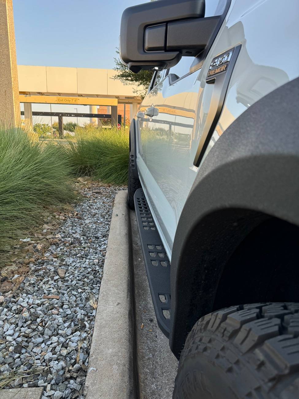

I just put Spidertrax 1.75" spacers on my 2024 Tremor. I added fender flares and needed some more stickout.
I am waiting on my 2.5" level kit. The tires rub a bit on the crash bars.
Pictures ??

I have the same flares on my leveled 21 PB... I really like the look with linex on white, with the spacers. My flares are color matched red.
I've been on the fence about using spacers with my stock 20s & 34in tires, vs getting 0-12 offset 17 or 18in rims when I'm due for new tires.
If my math is correct, the offset conversion for the 1.75in spacers you have is about the same as 0 offset rims? ...that definitely looks good with those fender flares.
My wheels say +34mm offset. So more like -10
My wheels are +44 20in sport rims, so I ordered 2" spacers to go with my 34.7in tires, flares, and level... they are too big for the fronts, I'm getting a light rub on the metal corner of the front bumper (trimmed the plastic) at partial turn in, as well as at the crash bar at full lock.
I ordered a pair of 1.5" to replace the 2" ...hopefully that will solve it
