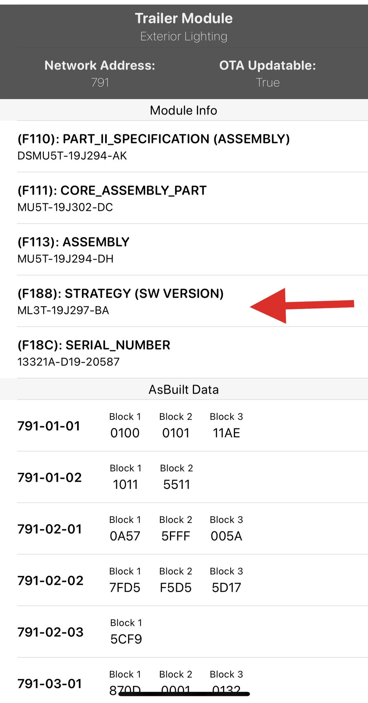

The last two characters of the version that addresses the recall fix is DH. BA or BB are previous versions.
Can this line/code be viewed in Forscan? Would someone mind posting some instructions how to navigate to this module and see the current version number? I have the software and connection dongle...
Yes, it can. Go to the top icon that looks like a car (Vehicle and Interface Information), click on Modules tab, scroll down until you get to TRM - Trailer Module. The software version is the last line of the block and is called “Strategy.”
