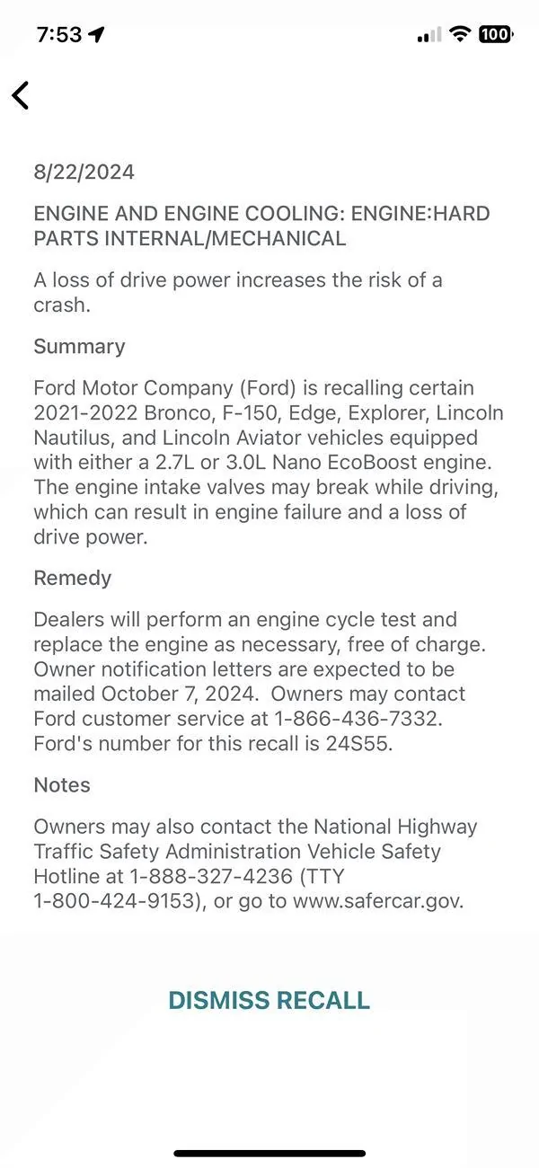

Just got a recall notice in Gas Buddy about this one. Yikes.
