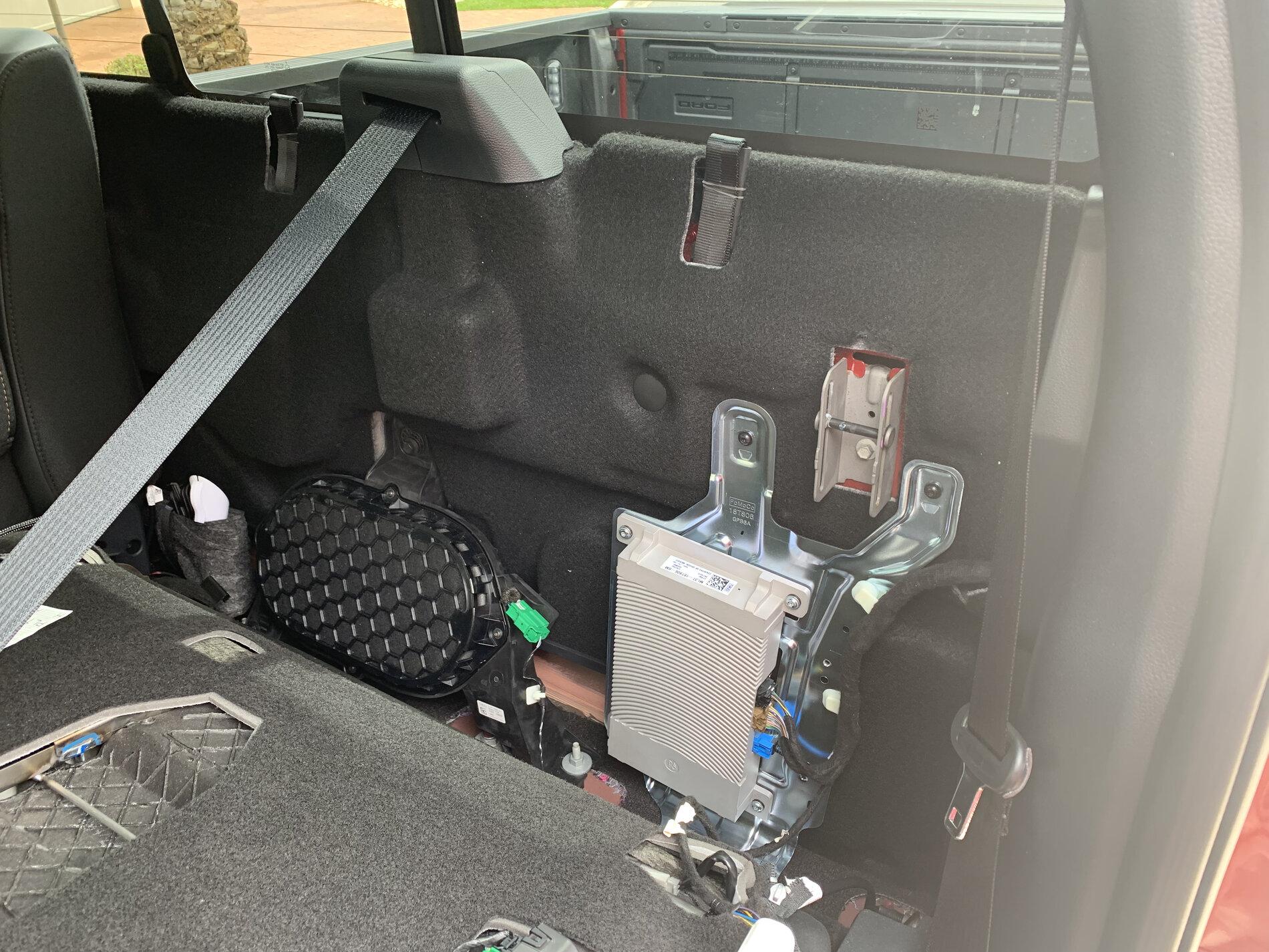

I have the B&O Unleashed and when I released the rear seat back I found there was almost no usable space behind the seat. Save your money if you have the same setup.
Ford F-150 Rear Seat Locking Mechanism IMG_3454
Ford F-150 Rear Seat Locking Mechanism IMG_3455

I moved my Builtrite back seat latch from my 2012 to my 2021 with no issues. As others have said you have to find the sweeet spot to get everything to align the first time but after that the latch lines up just fine. Takes a bit more to trigger the latch then the factory one on the passenger side but works great.
I like being able to store things that I'd like to keep in the truck but don't necessarily need all the time (Extension cords for my Pro Power setup for example). I do not have the B&O system so I have some space to use. Especially hanging the extension cords off of the childseat LATCH anchors at the top.
