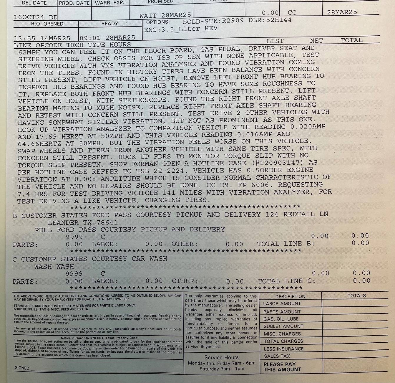

I took the truck back into the dealer and they kept for about 2 weeks. They replaced both front wheel bearings and used their chassis ears to confirm vibration issues are present. The shop foreman rode with me and also confirmed he could feel it and it was not normal. They swapped wheels and tires and vibration was still present. They opened a case with Ford and got the dreaded “this is a normal characteristic, no repairs should be done” nonsense. Once Ford lays that line down, are there any alternatives routes to get repairs? I was going to purchase an extended warranty but now am thinking about dumping this thing instead.
Ford F-150 Rear end vibration -Powerboost IMG_2306
Ford F-150 Rear end vibration -Powerboost IMG_2307
