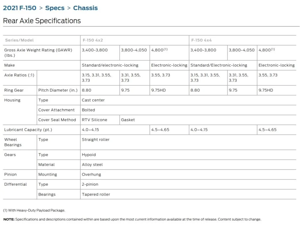

My ‘21 with 2.7EB came with the 9.75 and I do not have the payload package.
Because I have the FX4 option, that allowed me to get the 3.73 with the 2.7. I really do not know why I have the 9.75 axle, though. My ‘16 with the 2.7, FX4 and 3.73 came with the 8.8 axle.
From what i understand 2021 onwards, 3.73 gets you the 9.75.
Although if you look at the guide below, it shows 3.73 available on the 8.8, I have not heard of a case of them actually doing this.
Ford F-150 Rear end order option 8.8 or 9.75 12
If you get a 2.7 I think you have the option to get the 8.8 with 3.73. If 3.5 or 5.0, 3.73 automatically gets your the 9.75
