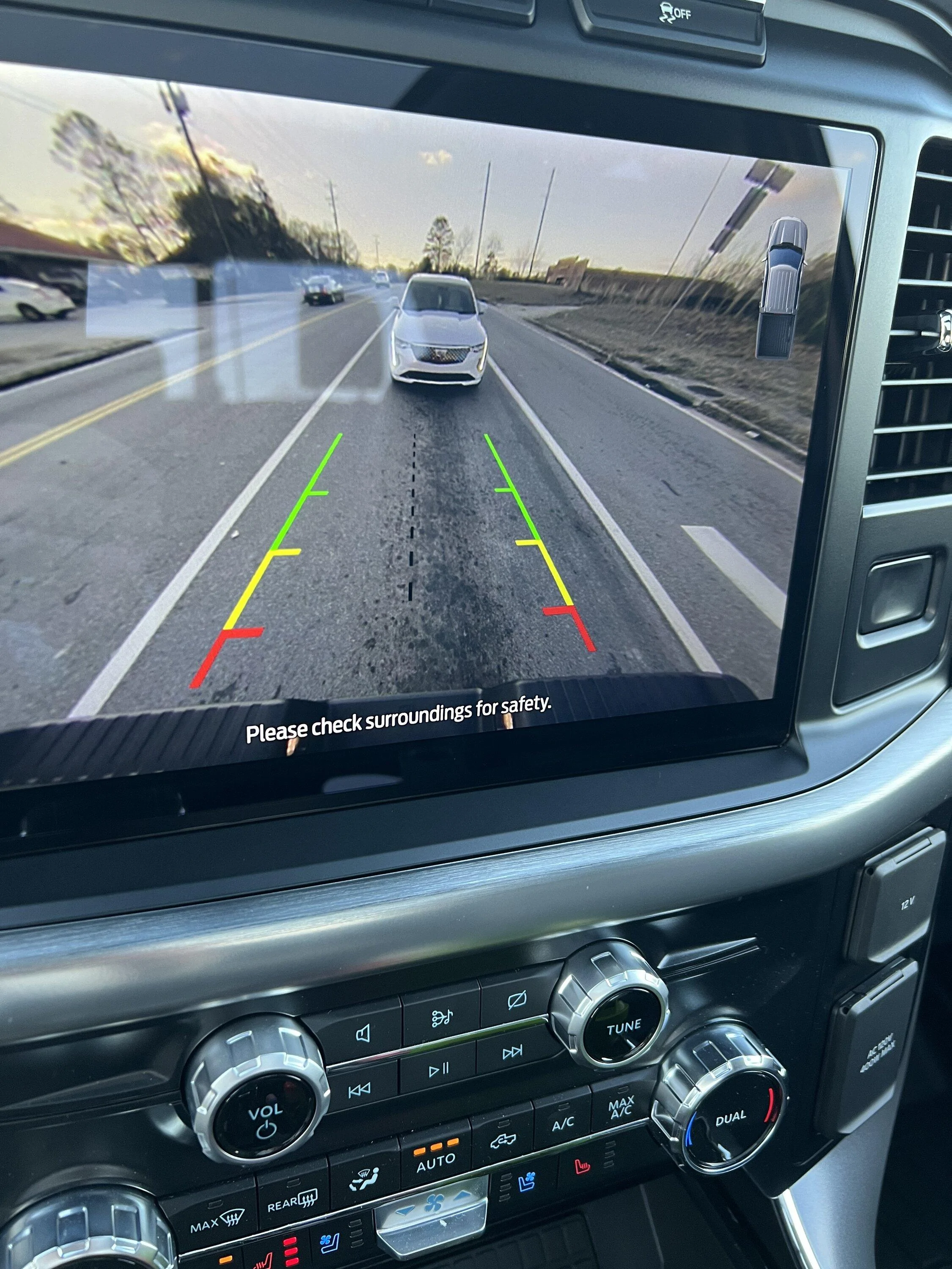

Although I am overjoyed with getting the banner removed, I'm interested in moving the ball still further down the field. When the rear camera is turned on, it is essentially activating the Backup Camera, i.e., with the "guide lines":
Ford F-150 Rear Camera View in Motion: Lines vs. No Lines 1706196212500
(My apologies to @icemanrrc for an unauthorized theft of his photo. I was just too lazy to get my own.)
However, when a trailer is plugged in, there are no "guide lines" in the rear camera view. This leads me to think that the module (IPMA?) knows the difference between when a trailer is plugged in or not, but maybe not the difference between the transmission being in Reverse vs. the camera button being pushed? ?‍♂
Is it possible to not have the "guide lines" on the rear camera view (no trailer), but retain the lines for when the transmission is in reverse?
