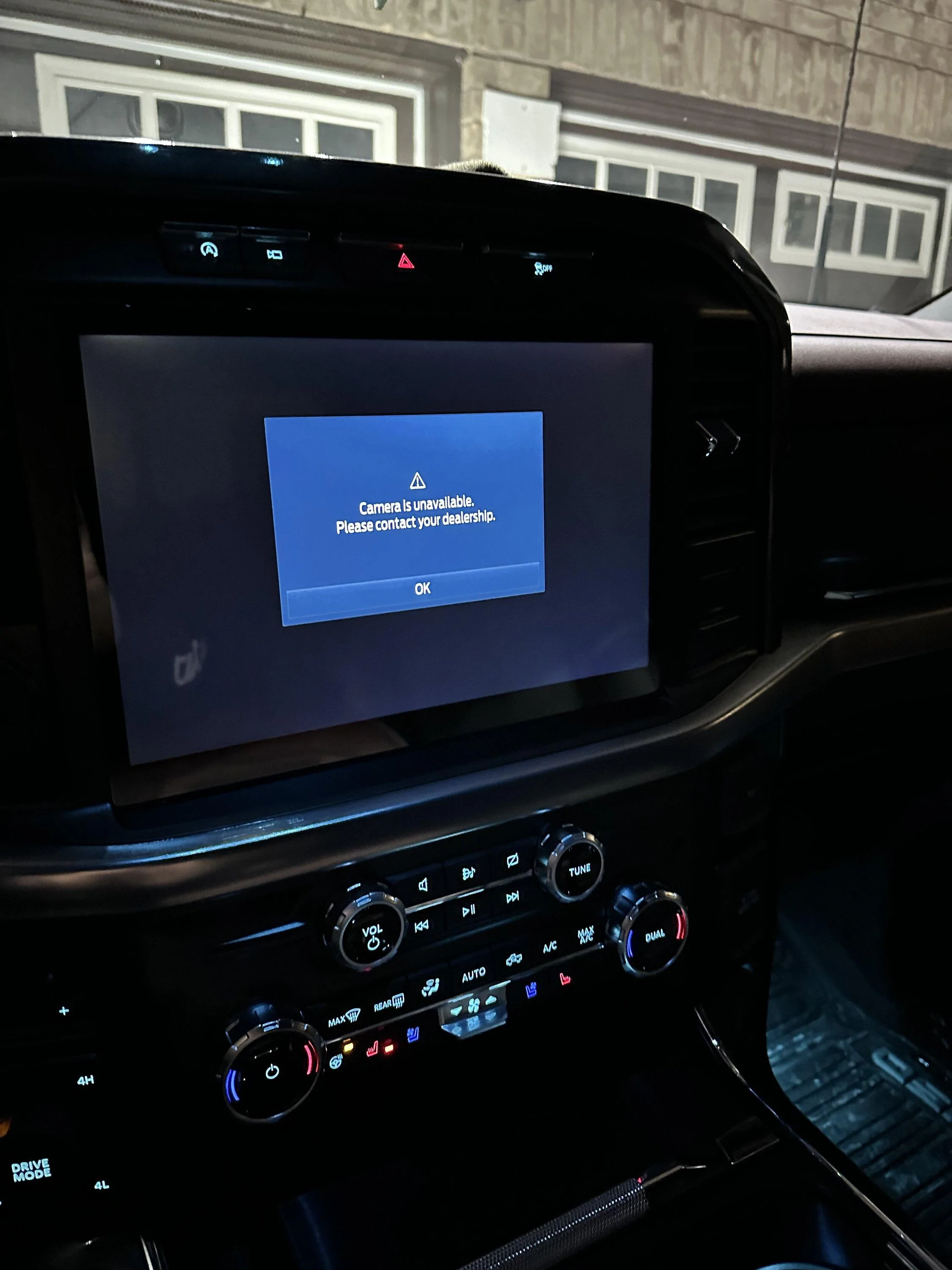

So for about a month I have been having some trouble with my rear view camera, where the image is not available or it comes up and goes like there is a loose connection.
I have had dealer look at it and perform some service but after few days its still there.
The dealership told me that they performed a TSB and updated APIM (which I think is just horse sh*t).
I need you guys to please help me figure out what this is and how to solve it.
After the service the IPMA is still showing a fault code which I can not even reset.
The problem is I want this to work as I will be going ahead to install 360 cameras which will replace the IPMA and add so much more.
I don't want this to happen later and the dealership denying the repair under warranty.
Following are some images to the problem:

Have you checked the connections and given them a wiggle to see if it effects the image? I would start there.

I did at the ipma and under the hood. But that was all.
I am pretty sure it's just a loose connection somewhere, as it happens more on bumpy roads.
